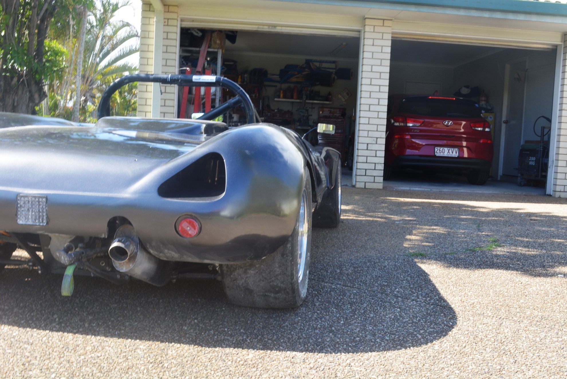

My little toy

John, did you build that Lotus from scratch or do you modify an existing chassis? Looks fun, have you had a chance to take it to the track?
Hi mate, yep shes a scratch build, i drew the first chalk line on the floor middle of October 2017. and drove it out of the shed under its own power jan this year so approx 14 months, and the best part of 4 months was repairing the miserable excuse for a body i managed to get hold of, it was a tad rough shall we say. years of neglect and left outside in the weather had taken its toll etc.
no mate i havn't had it out as yet , ive got a couple of minor issues to sort out before i do , so it went on the trailer under cover while i have the Macca here doing the gearbox.
