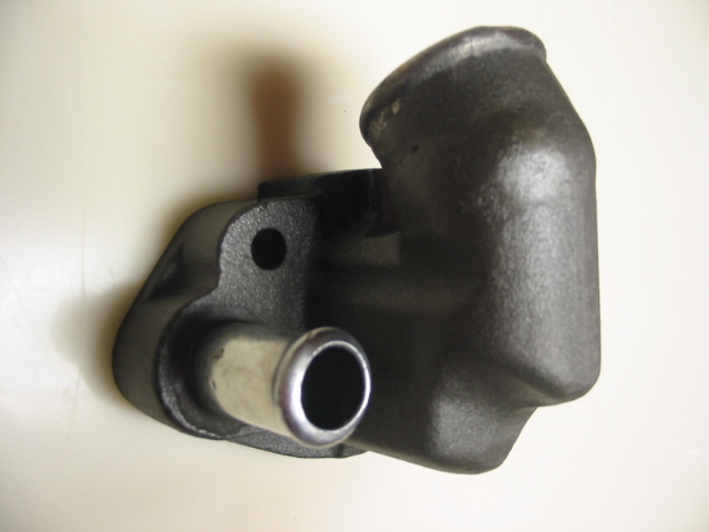

Chuck, is that the cast housing that you welded & reworked? The by-pass fitting looks like it is glued or bonded into the housing, maybe the heat from the weld failed the seal or could there be a pinhole in the weld?
Chuck
Jac Mac:
You have a good memory. That is exactly the cover we are using.

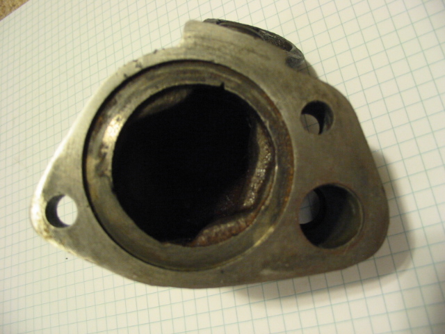

Good observations. But we saw the coolant coming from the bottom of the housing where it and the engine meet when we ran it last night. Took the thermostat housing off and the lower portion of the gasket seemed soaked through from inside to outside. The rest of the housing was dry. So I don't think we have any leaks in the housing, per se, or in the bypass fitting.
The mating surfaces are flat and smooth.
The gasket was a cheap blue paper variety from the local Auto Zone.
I am really wondering if I really need a gasket at all in this application, or if a nice bead of sealant is sufficient. Is a gasket really required with a good bead of sealant?

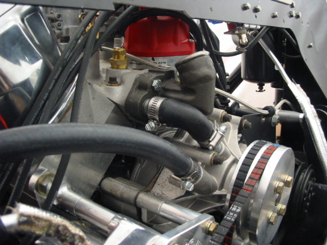

Thanks for all the good suggestions. Replaced the thermostat cover with a nice adhesive backed gasket. A bit of Thermostat sealant. Installed it, let it set up a bit, then tightened it down. Next day fired it up. Coolant again came pouring out, worse than before.
Turns out the generic housing we were using has an opening for the bypass hose that is nearly 3/4". The opening on the engine manifold is half that size. There just was not enough of an edge to seal it. Could have put a metal gasket with a smaller hole in place but decied to try a different approach.

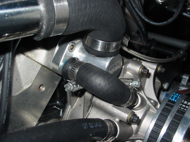

Long ago ordered a CSC swivel thermostat housing. Nice, machined, aluminum piece with O rings instead of gaskets. Did not think it would clear the fire wall when we got it months ago, but decided to try it anyway. It fit well. Better yet, it did not leak. Problem solved. And it looks a whole lot better than our welded generic unit.
