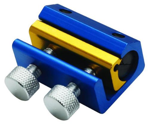

For periodic/preventative maintenance, buy the motorcycle cable lubers to force the cable lube down the full length of the housing. The cable is less likely to break if it moves freely...
