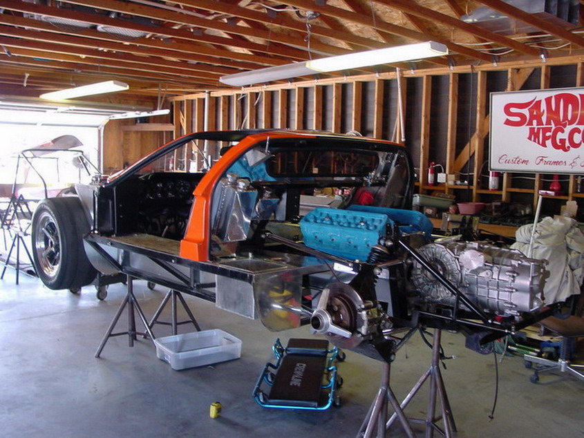

Anyway so far - from here:
Tim Kay
to here in one week /ubbthreads/images/graemlins/shocked.gif /ubbthreads/images/graemlins/laugh.gif
Tim Kay
Hey Dave,
I was thinking you could show the above pictures at your next Pantera Club track
meeting to show them how they "blew my doors" off /ubbthreads/images/graemlins/shocked.gif /ubbthreads/images/graemlins/grin.gif
Doc Watson
What is the purpose of the rebuild? did you recieve the car in 'unassembled' state? are you overhauling the engine/trans?
just curious....
Chris Kouba
Rookie question from the uniformed: what is your gearbox? It looks to situate the motor nice and low. I don't have the knowledge to visually ID it.
Chris
Tim Kay
Doc, 'had nothing better to do' haha. Probably should have left it the way it was, it was running real good. Just decided to swap out to a 351w\G50 drive train and that is now leading to brakes, new aluminum paneling, paint, ect. You know how it is, since your doing one thing might as well do 'this' and 'that' while you at it /ubbthreads/images/graemlins/crazy.gif
Chris, Porsche G50\52 and it gets my 6 1/2" oil pan within 1/4" of the lowest chassis member /ubbthreads/images/graemlins/cool.gif

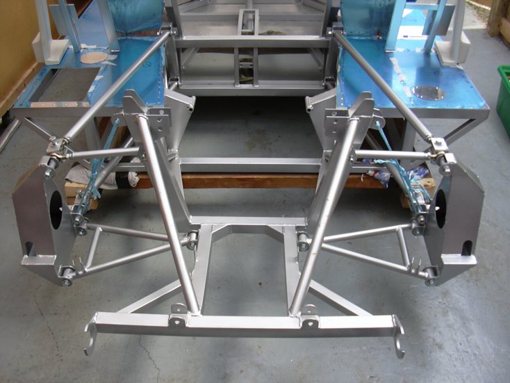

Chassis Stiffness
Would like opinions regarding the removal of a chassis member.
Using the pic below, (taken from Paul's thread, thanks for letting me borrow it for this illustration /ubbthreads/images/graemlins/wink.gif) I am considering removing the cross member that lays directly under the oil pan (directly under motor mounts in picture).
Would there be any major structural sacrifice by not replacing it. The way I see it, all the loads occur further back in the chassis where the a-arms are attach. But not being knowledgeable in chassis building and where stress occurs I may be making a big mistake.
I am considering for ease of oil pan removal later, allowing easy access without removing the motor.
Re: Chassis Stiffness
No expert on chassis design either, but my advice would be to stick to the safe option...make that member removeable. I would design a replacement member that bolts in. You can remove it when you need access to sump. More work though than simply cutting it out.

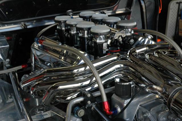

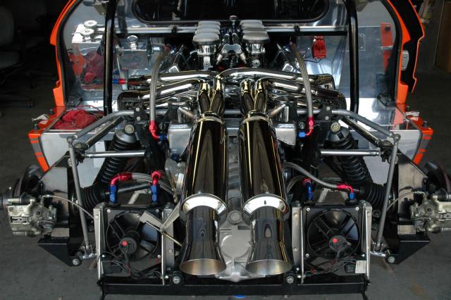

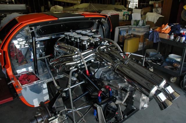

A bit embarrassed, due to the elapsed time, I am finally back with an almost completed Tornado GT40. Although without a car, I have been here with you guys all along, consistently checking in. :stunned: As noted above, the tear down date was 6-14-05
A very long story short – done to date:
1) engine build 351\427 Alum Dart, from scratch
2) TWM eight stack injection
3) AEM ignition controller
4) G50\52 build by California Motorsports (supporter)
5) CMS cable shift
6) 930 CV’s and new half shafts
7) new aluminum gas tanks, built in swirl pots in each for EFI
8) trans oil cooler with fan and pump
9) engine oil cooler with fan
10) lowered motor cg
11) new aluminum radiator
12) leather dash and sills
13) new paint – (twice – don’t ask)
14) undercoating
15) interior insulation
16) roll cage mods, powder coat
17) fuel pumps (2), fuel filters (4)
18) New custom BOS stainless exhaust, Burns mufflers
19) Custom electronic speedo - era correct
20) Upgraded air condition and fans
21) New plexiglass
22) Misc chassis and body mods
The only thing left untouched was the suspension, soon to be replaced as well. With some luck I will be testing on the road within the week
Tim,
Looks fantastic, I really like the oil catch tank. Very cleverly packaged! Is that two transmission oil coolers or is one for the engine?
Really nice work!
Regds,
As previously mentioned - looks fantastic, but not enough photos!! :laugh:
How & what have you used to insulate the bulkead and what have used for the undercoat (I presume you mean the floor-pan)
Regards
Andy
Very nice Tim...
I think I would add a bit of insulation around those breather lines (header wrap works well) around those breather lines where they come in such close proximity to the headers..
Love the detail... A stunner!
