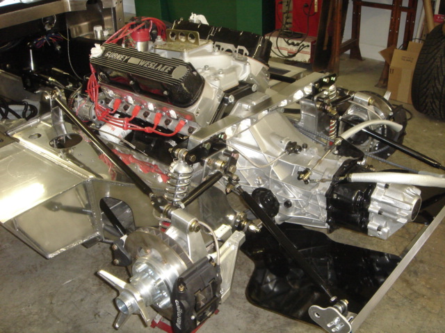

Is that front end of the chassis made out of aluminium or steel tubing? The rollcage Tom, is that steel as well? Do these guys use mild steel or something more technical?
Thanks mate!
They are using 6061-T6 for the chassis and then they make the front end and the roll bars out of mild steel? These are all tubes and the only thing you'd need to do is to increase the wall thicknesses a bit when changing from steel to aluminium to get significant weight savings. The external diameters could all stay the same.
As long as it's not a robe and as long as it doesn't need to be hardened, there's no reason why you would use steel these days - or does somebody disagree with me on that?

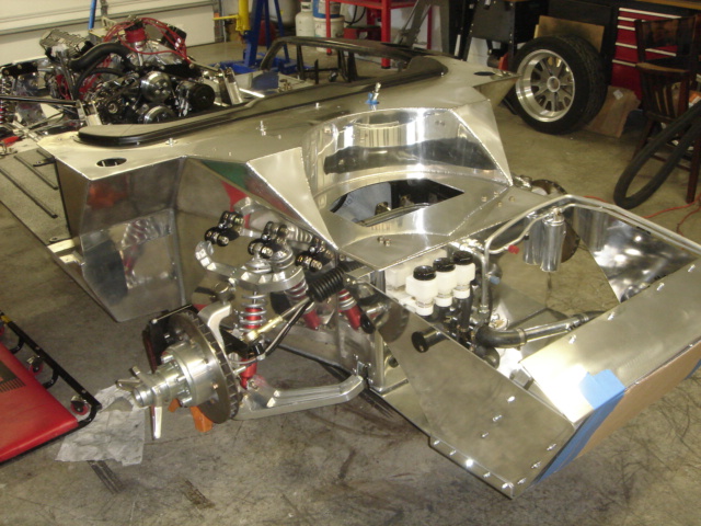

That makes sense now! I don't really get the point of the steel frame though, don't take it to heart mate, it looks awesome and sure you put heaps of effort into it, but where's the point in making something look original when its not original? But I think many of us would disagree with me on that ;). The aluminium frames are better than the steel ones, just as the aluminium monochoque is better than any tubular steel chassis (if designed right). For my personal taste, there're still too many structural components made out of steel on the RCR built (it's still the best chassis you can get from an engineering point of view). That brace behind the seats looks like sort of a built-in roll bar, is that steel?
These mounting brackets on the chassis where the A-arms and the suspension attach, are there any stiffeners welded onto the backside?

No offense done. The point is just that i try to describe as detailed as possible, one just needs to take the time to read it.
Don´t understand your point regarding to much steel in structural components. All the structural components are in aluminium. THe rollbar is not built in, it is added to the chassis. THe chassis itself is tested and approved in Australia without the rollbar. The 6 point roll bar is an option which i have chosen. I personally realy on steel here. You could make it in alu, but depending on your race organisation it can be difficult to get it accepted.
Yes there is a brace behind the mounting point of the upper front control arms. The bottomplate of the spare wheel recess is going all the way to the sidewalls of the chassis and meet it there almost exactly in the center of the mounting brackets.
