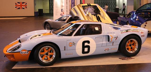

Tom, Rob - i based my comment on a picture of a CAV i have currently as my wallpaper. It's a show car so it's probably had special treatment, but he shutlines are very close. I guess i'm showing my inexperience of the different 40's out there
Tom, the quality of your work is an inspiration. Appologies for any offence.
That car is a SUperformance......
Thanks Ron, my mistake.
I only ever intended my comment to be taken as a compliment. Now that the correct manufacturer has been identified i hope it will be.
