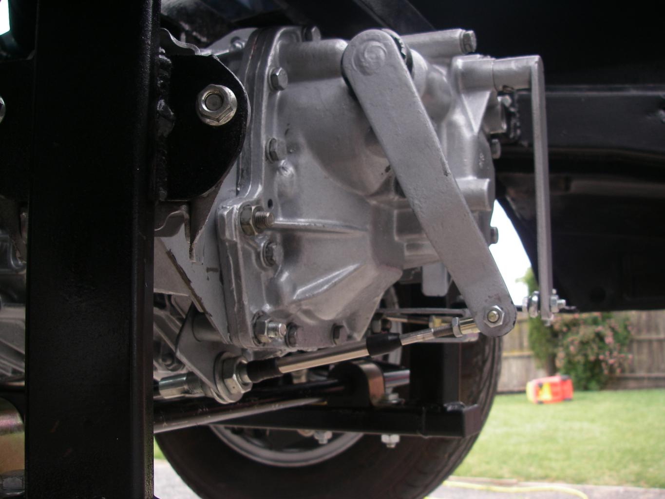

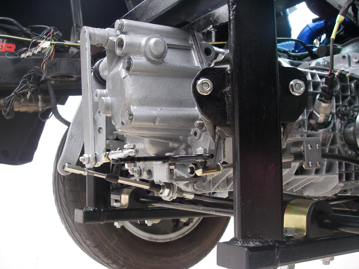

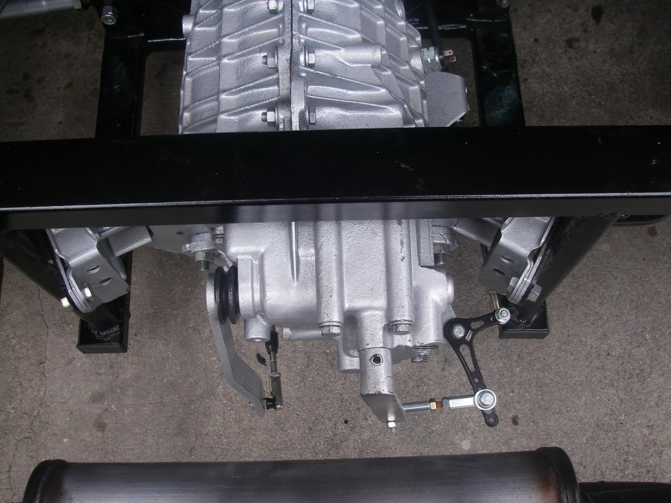

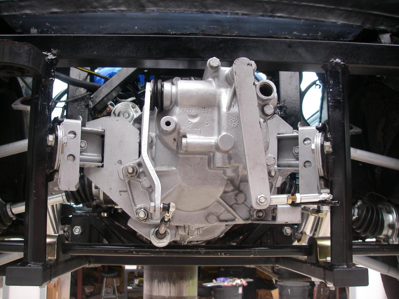

Keith,
Here are some pics of the cable fittings I fabbed.

Mike,
You should have someone watch the cable housings themselves while you are running the shifter through its ranges.. If there is any movement of the cable housings between the shifter quadrant and the transmission, that will be a loss of movement at the cable ends. IE, the cable housings themselves need to be restrained from all movement no matter how slight.

Mike and Keith,
Rather than set up a still camera, I would suggest a video of the shifter in action. The final resting place of the mechanism may be in the right place but how it got there may not.
Mike, the only thing that I can suggest is the way the cables and hardware are mounted. You have a large torque force on the bolt that is mounted to the side of the hardware. This can lead to a loose or broken(worn at worst) bolt. This will put slop iinto the mechanism, and is what I found in my setup on the 930. Bolts were comming loose or couldn't be tightened enough. It forces a wear in the bolt hole. If you set it up like a yoke, you move the force to a direct push pull arrangement with the force on the bolt in the middle. This allows you to use nylocks without having to over tighten, just snug up. It just has to hold it in place. I modified the rod ends on mine to get that arrangement. It can work either way, griping the rod end or the hardware.
Mike,
Few things :
1st : Where did you get your gearbox. Your rear cover is the one used in the very first versions of the UN1 gearboxes and no versions of the UN1-13 went with this rear cover. There is no oiling of the 5th gear assembly, so for sure you will break. I strongly recommend you to replace your rear cover to the standard one.
2nd : Your setting, with the UN1, will inevitably drive to bad shifting. Unfortunately, there is some OEM clearances between the finger and the arm helping the finger to move laterally, so because you act on 2 different parts wich have some clearances, it is a very bad seeting. The only way to restore something acceptable is to have actions only on the main arm, the one which hold the finger. You can have a look at a lotus setting and replicate it....even if it is still not perfect but far better than this 2 ways.
If you want to keep your existing setting, I would recommend to shorten the arms, with this length + OEM clearances, you are making exponential mistaken dispalcements....
3rd : Check the tips of your links (inside the gearbox, just removing the rear cover, most of the time, they are worn. The standard (OEM) is to have them perfectly squared, no V shapes
Best
Stephane
