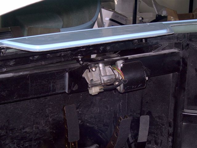

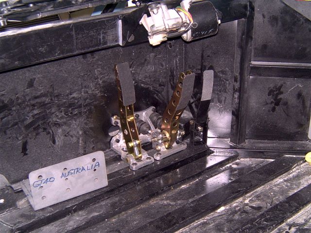

Windscreen wiper motor and assembly fitted.

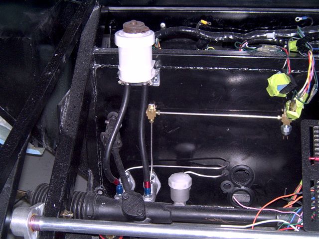

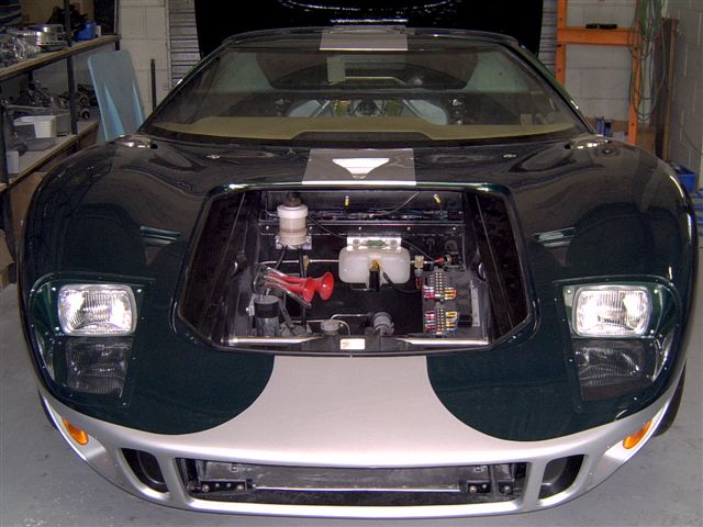

A bit more progress,hydraulic reservoirs in place. Steering
rack fitted,sway bar fitted.

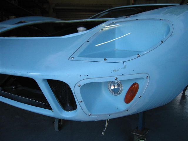

Re: GT40 Australia #48
head light covers fitted
