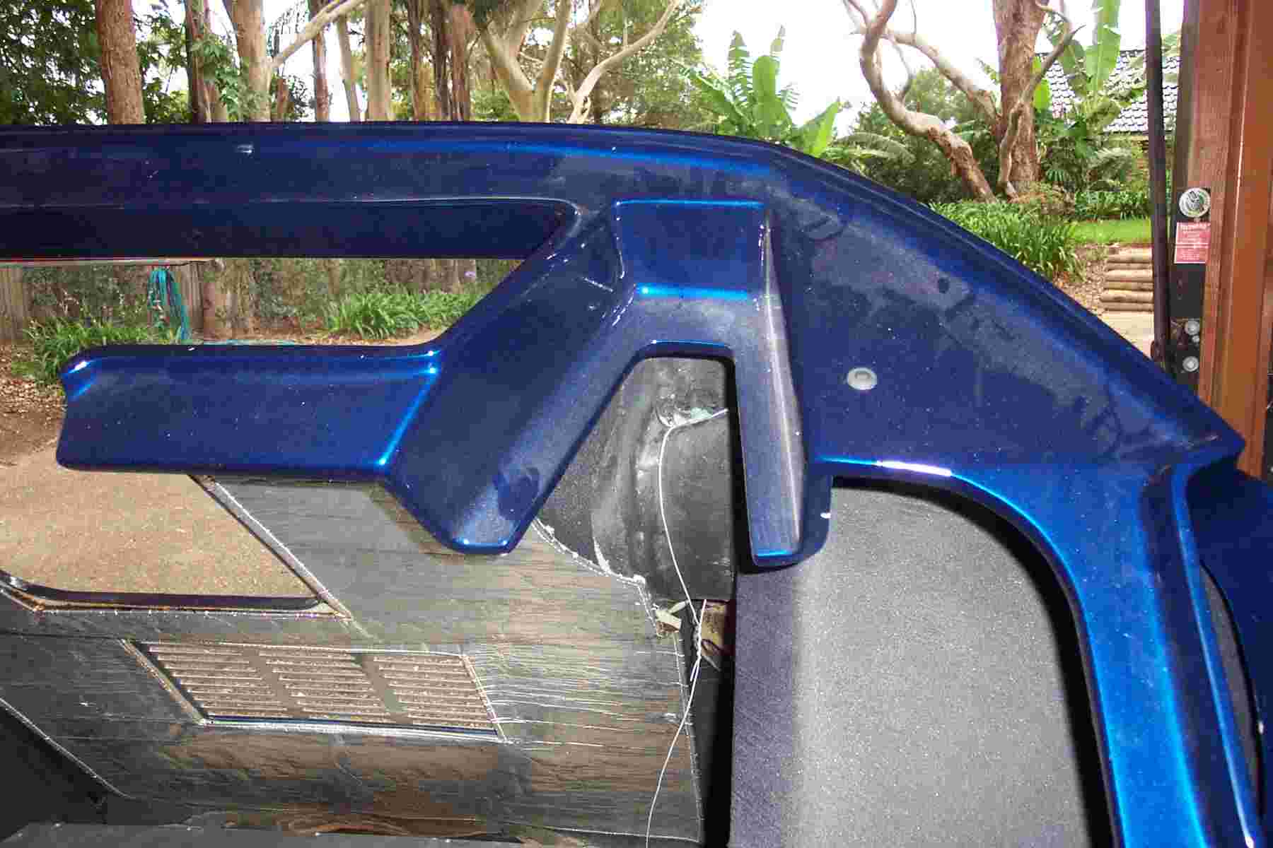

I have asked Peter Delany, and I'll ask you as well since your roll bar is a factory installed unit. How did they handle the rear supports through the rear clip. Is that part braced in any way. I will have to cut the panels in mine to get them on the frame near where yours are. My concerns are that it will make the rear clip a little more flimsey. Raising and lowering the clip by myself is an easy job, and I don't want it to flex while doing so. My exhaust stick out too far for me to mount mine as high as yours. Guess that is the difference in the 351 and the 302. In any event if you could post or send me some pics of the rear clip where your rear post go through it would be very helpful.

Re: GT40 Australia #48
Bill, The rear clip is cut away to allow for the roll bar
which is braced to the Chassis.(See pic earlier in this thread).It does not flex at all when you open it. There is no room to move the engine forward, in fact there is an indent in the firewall to allow the pulleys on the front of the engine to fit.I spoke to Peter Ransom at DRB about your questions and he said if you would like to e-mail him at [email protected] he is happy to answer any questions

Bill - The attached pic shows the cutouts that I did for the retro-fit. As Pete says, there is no change to the rigidity of the clip at all, & he is right about no room to move the engine forward at all (I actually took 1/8" extra out of the recess for the w/pump pulley after hearing a grinding sound under heavy braking - the engine must have moved forward about 1/32" which was just enough to have the pulley bolts machine a nice little arc in the back of the engine cover).
