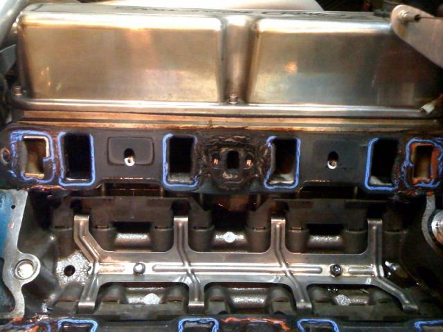

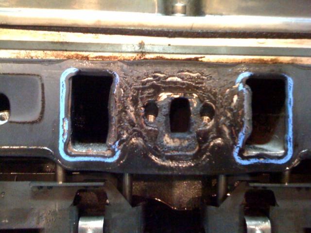

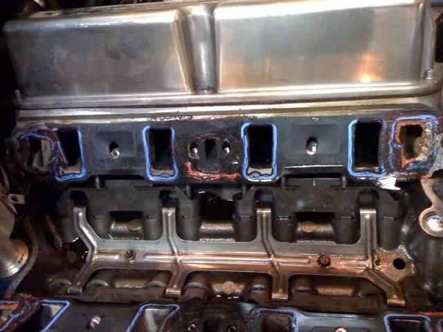

So here's what a blown intake manifold gasket looks like....

So it's great that the installer used nice ARP fastners on the inlet manifold....but it would have been good to tighten them up with more than just a thumb and forefinger.....
Those look a bit like print o seal gaskets which have a bit of a reputation for this sort of thing, however with alloy intake manifolds its wise to check the manifold bolts at fairly frequent intervals & most recomendations suggest a lower torque value than the 20/25 ft lb that Ford use for the older cast iron intakes, especially if the ARP stud kit has a UNF thread at the nut end, dare I assume that you have checked these at regular intervals during the time the car has been in your stewardship Cliff:), or did it get the old fit & forget treatment...
