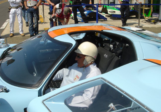

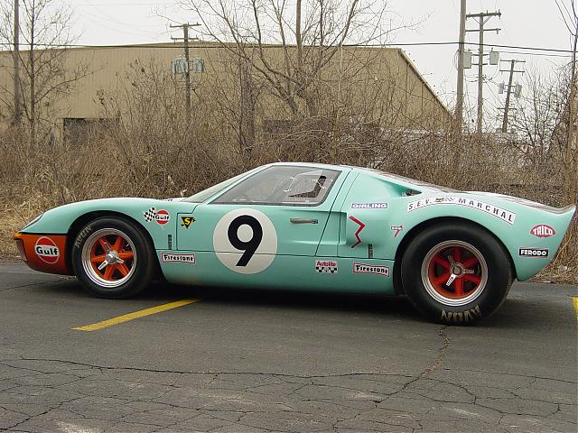

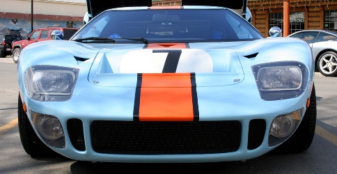

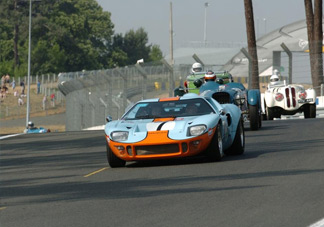

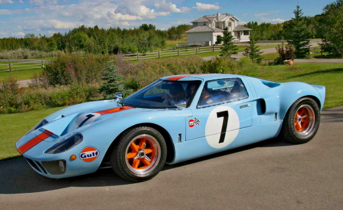

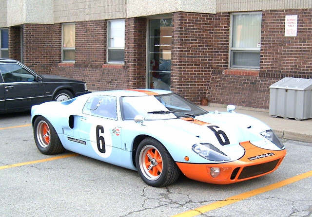

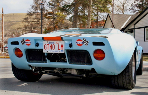

Hi Owasis,
The CAV GT with Gulf flares was our first customers choice. Including the powder blue and marigold orange stripes and white roundels. After getting over my initial worries about how the local constabulatory would look on the thing, I'm glad this was the first colour scheme on a CAV GT to hit the road in Canada (and we've had no problems with "Imperial Entanglements").
The CAV GT monocoque chassis is similar to a Safir in that it has been rationalized to simplify manufacturing, then on the other hand, making the darn thing out of Stainless Steel and leaving it in bare polished metal for all the world to see is probably more work than painting a mild steel part!
You can get to a high level of visual accuracy with the CAV GT when it comes to Gulf cars. Here's a few pics of the Gulf pair we've done and the factory built car being driven by Sir Stirling Moss at Le Mans last June.

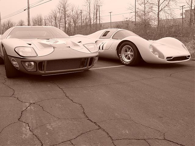

And there is always this one.....

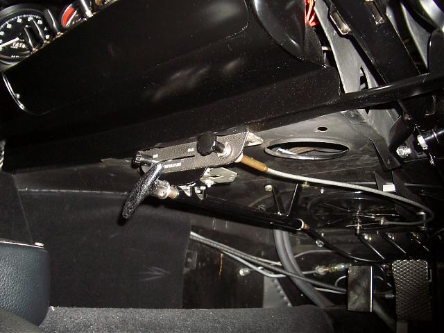

Here is a picture of a stock emergency parking brake from a GT40 MK1. It completes the very detailed series of assembly pictures from Bill.

The FIA required a "parking brake" as the GT class required "road equipment." This was an expediant way of having a brake without the weight and complexity of a independant system, but this is not legal for most jurisdictions.
And yes, if the master fails the "emergency brake" is just a memory! P1116 had this system and the brake would hold for months (don't ask how I know), I didn't know my son had pulled the handle when we stuck it in the corner and covered it up.....
Rick
Bob,
Thanks for the photo of the lever and park brake mechanism.
Now I am going to have to look up what ERA and SPF uses. Up to this point, I never thought about it.
