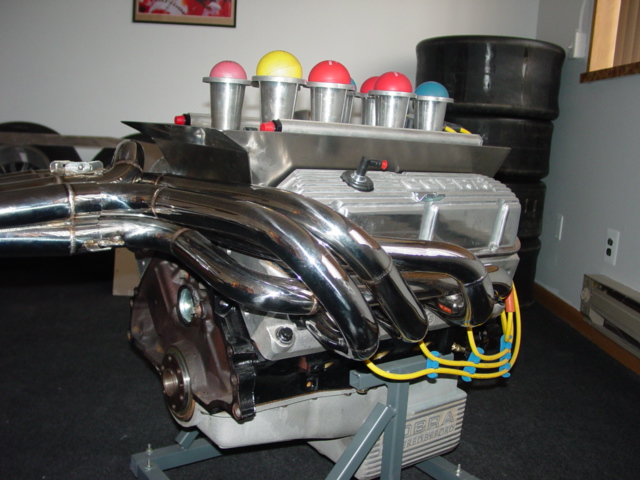

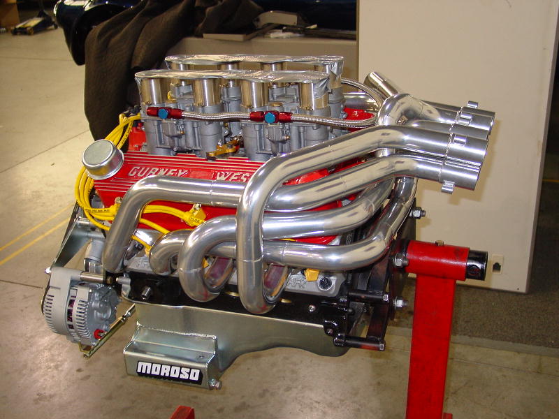

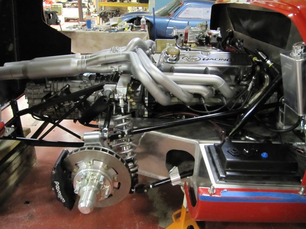

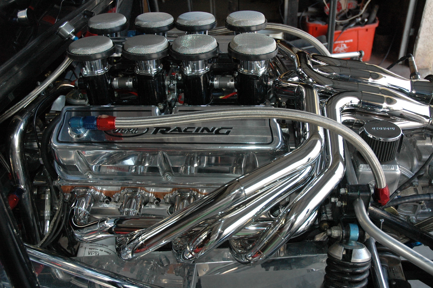

There are a few of us with Windsors. Here is mine. Bored, stroked and internally balanced at 392ci..

Ok, how much? I can tell I'm going to be shocked! I ask because I have a 351 tucked away in my garage. How much HP can a G50 handle?

I think it's safe to say that the vast majority of Superformance GT40s have 427 Windsors in them, almost all made by Roush.
G50 transaxles can handle 475-500 hp easily...the later ones will hold much more..my 6 speed unit in the 01 race car has taken 600hp of abuse on track with slicks without issue.

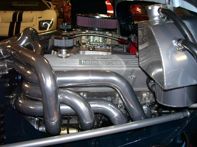

Here is a picture of the 302 from Lynn Miner's car P2133 which I assume is using standard SBF headers:

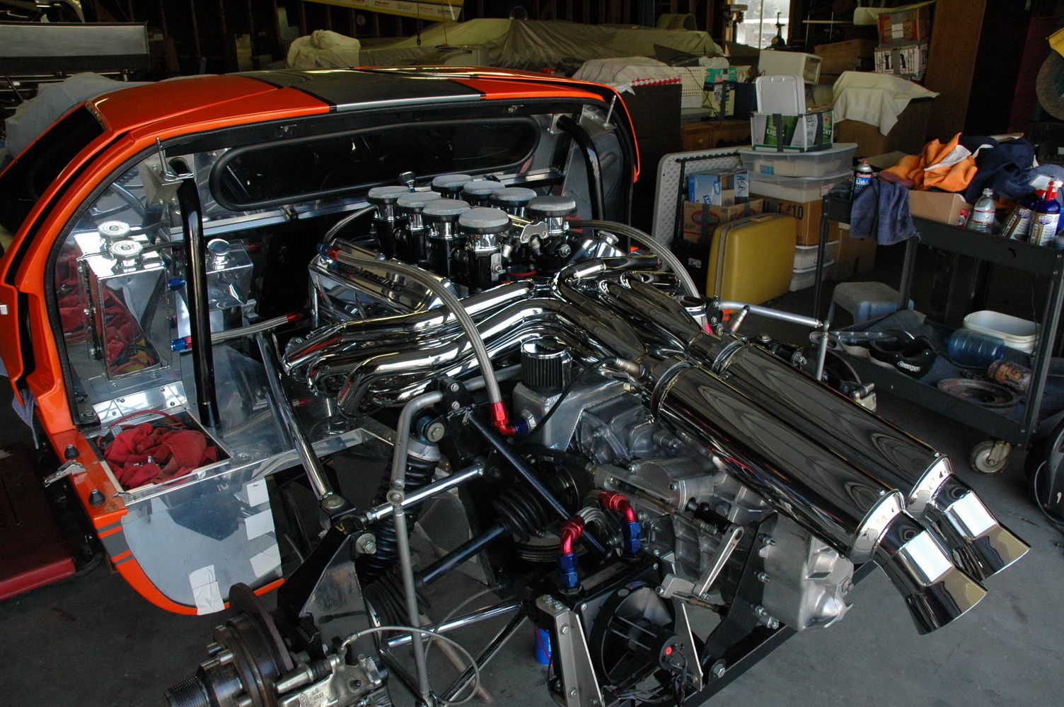

Here are the SPF FE headers on Steve C's P2125
Thats a pretty looking engine bay Tim...

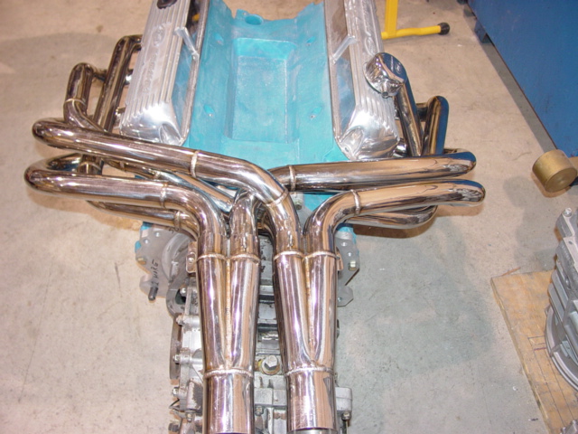

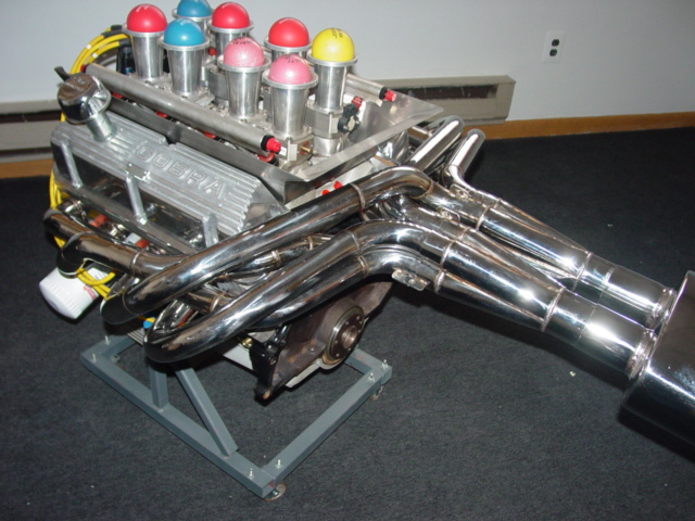

Alan the headers you show are both Mk2 style...the Mk1 is more flowing with sweeping curved pipes and less of a squared off look....as we supply to the 302 based Mk1 cars...
yes...and like these RCR headers for 302 based engines..
