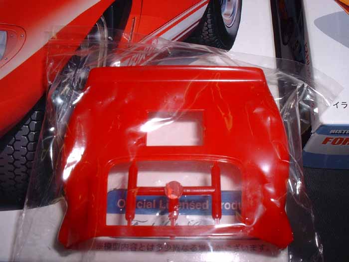

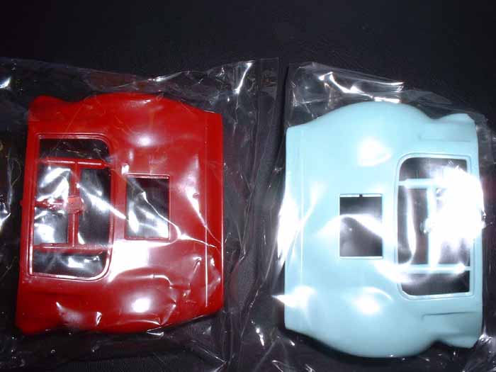

those are the slim body I mean:

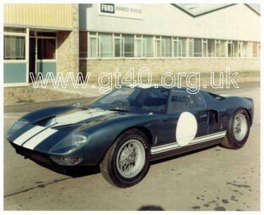

Is this the width you were speaking about?
Ciao
Phil

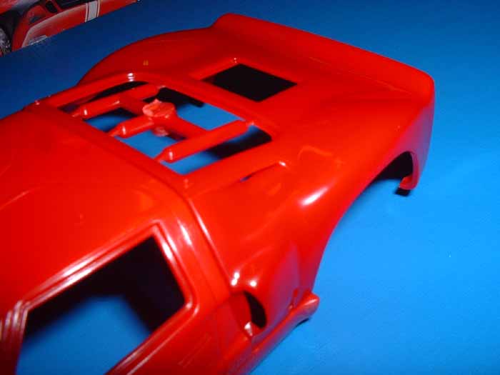

Yes, thats exactly what I meant.
Don gave me the answer..now I know there are wide bodies..and now I would like to create something similar for my model kits in 1/24 scale (maybe a transkit for fujimi kits...just for the rear part if the main difference is only there).
They all are slim ones...and I love big asses as Bill D ones.
Does anybody know where I can found some drawings or measures to look exactly at the increasing of this area?
Will try to make in scale the same work done on real cars:)
Thnks
Paolo

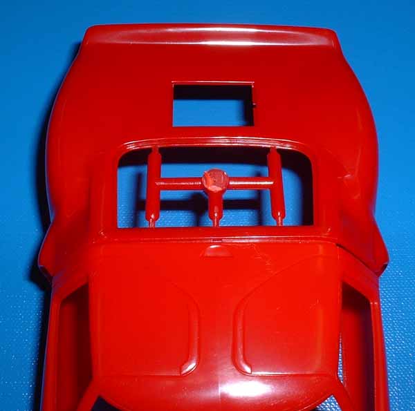

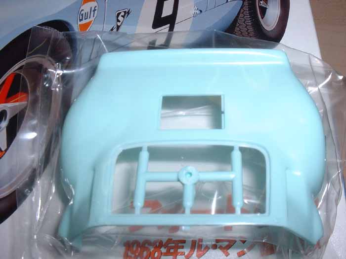

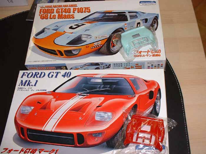

Paolo: Check your kit #19 yellow Daytona. It is a MKII but it has flares that add to the back and should fit MKI. Also in kit #20 Blue Daytona. You look like you are using #12132. Try #12130 or 31, these are the Gulf cars and are wider already.
uuuuu...u right at all:|
Opening the shop today..I run to my showcase to see immediately this..and U are right.
I've bought from fujimi nearly all gt40s and 917 available (including pe parts) and OBVIOUSLY the gulf one is in the center of external showcase.
U are definitely right..that has the wide body other kits doesnt have:D (I was already starting to take pictures and some Milliput to rebuild that part...)
Now I have to start assembly my own one:)

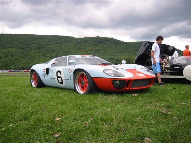

Here is ERA GT 2075 at Lime Rock in Sept 06. The black GT is the ERA Spider which was finished early this year.
ERA makes the MK-I with both rears and also have the MK-II rear. They are working on the correct 4 speed gearbox for the MK-II
The BRM style wheels are 17" to make space for bigger brakes.
Also a picture of ERA Cobra and the real 3252 Cobra. Do you know which is the real car. I think this picture was also taken at lime rock some time ago.
