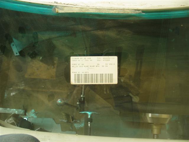

Hi Chris,
Don't Know if it's ford but here's the picture
it read's
113699 01 02 005 tis:0500181101
1560.00 x 760.00 sgu:479089
ford gt40 oa 90 vsg-g
ws_uv 063 klar klar bfg sa oa
ford gt40/bfg
Frank
