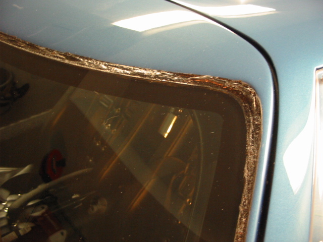

Just installed the windshield using 3M urethane windshield material. It is in tight. But I am not happy with my workmenship and would like to take another crack at it.
Here is the question. Can I carefully cut the windshield out with a razor or knife along the edge of the glass on the outside and inside perimeters, remove the glass, carefully cut away the residual urethane sealant, and start over again? Am I asking for trouble?
There are two issues. First, the windshield settled down a bit because my spacers along the bottom were inadequate. The gap at the top is a bit to wide and the gap at the bottom a bit too small.
Second, the bead line is rough, not smooth. Should have used a bit less urethane and perhaps a tool rather than my finger.
An easier option would be to just cut out a bit of the bead and re-caulk it without completely removing the windshield.
New territory for me, so any comments would be appreciated.

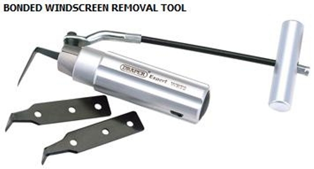

The screen can be removed but using a proper tool which has an angled blade on a handle and an extended piece close to the blade with another handle which you use to pull the cutting blade through the glue line.
However I would get a windscreen fitter to do the job properly as it is a bastard of a job.

Pic of removal tool. These are easily avalable. Ebay etc.

I've used the tool that Mike is recommending.. It is a good tool, but it's still only marginally successful (in my book).. As careful as I am, I still manage to crack 3 out of every 4 windshields I cut out..
If it were me - I would call the local Speedy-Glass guy and ask him over for a visit. He can cut it out (they usually use heated tools), reposition it, install - all in one visit. For a lot less than you'll get another windshield for..

Regarding usage of the tool shown in previous posts; that is the tool to use for sure. I too have damage windshields with this tool though. Another concern would be chipping the paint. I'd suggest laying down blue painters tape, then duct tape on top of it. Working that tool around is not easy, and with as tight as the screens fit, paint damage is a legitimate concern. Due to this concern, I might consider razor knifing it out. However, this too would be a challenge. You would need to use a very sharp blade that could flex, so you can slice smooth the the glass from the inside. I have used a long very thin puddy knife which I sharpend on a stone for such a task. It took a while, but it worked. Warming the blade doesn't hurt either. Bottom line..it's a bitch of a job to remove it. If you're receptive to farming a job out..... I agree, it may just be good idea to hire it out. If they brake it ..... it's their headache. Additionally, I would explain to them the finish look you were wanting and confirm that they can achieve it. Again, I used a latex sealer and my finger. Since it is latex, wetting your finger can help achieve a smooth finish (material dependant).
