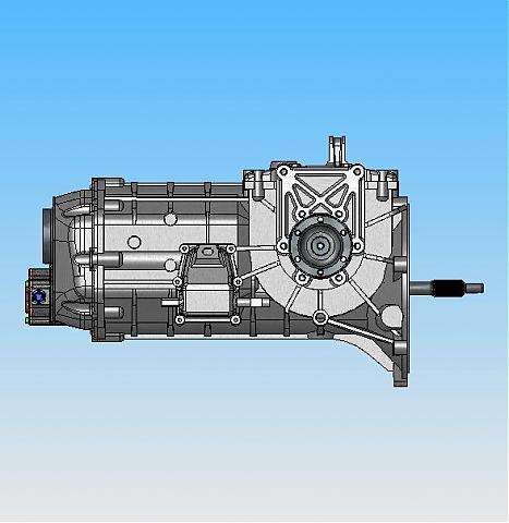

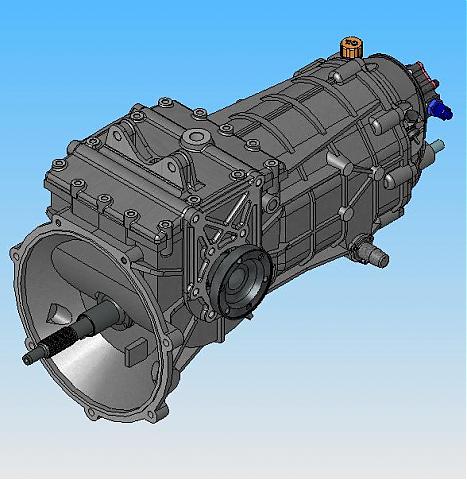

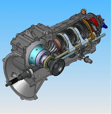

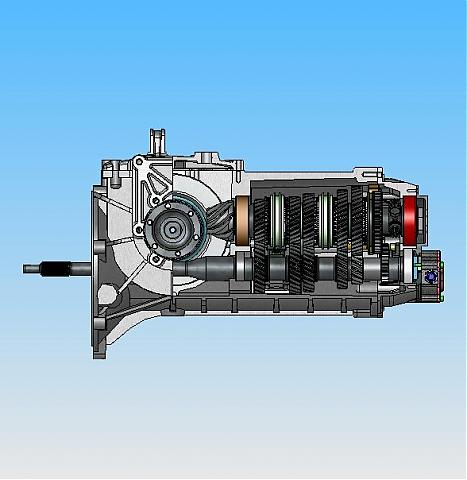

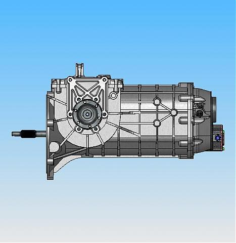

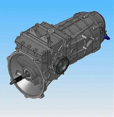

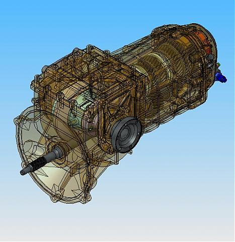

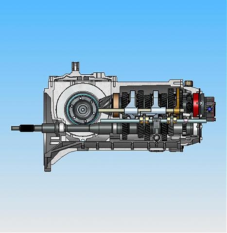

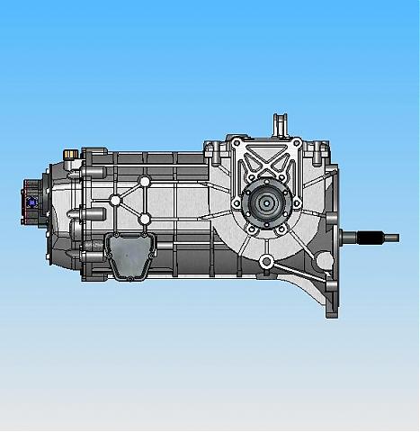

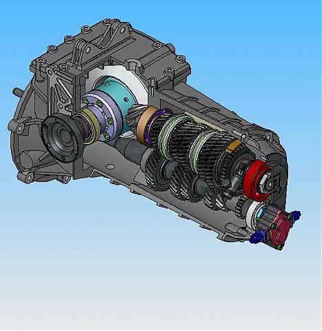

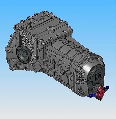

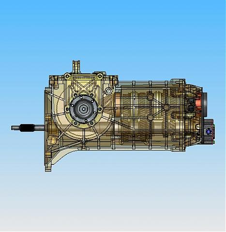

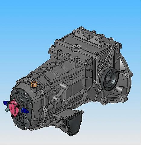

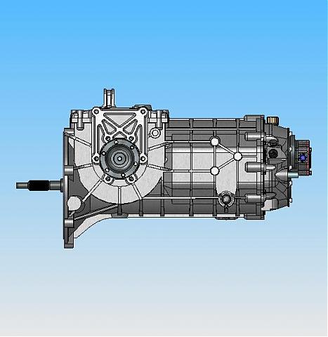

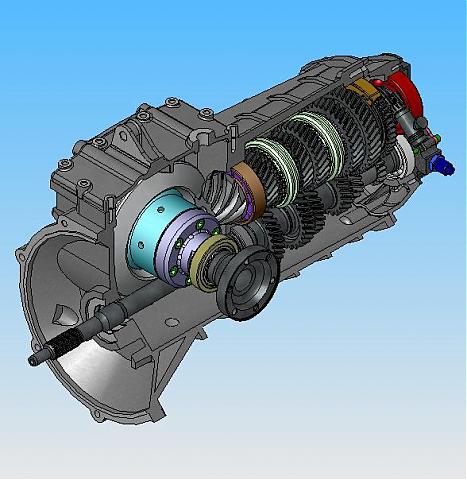

Hi Guys
the ZFQ CAD drawings are now finalised, and Quaife's Pattern maker will commence work on the casing pattern next week.
Regards
Chris.

Tell me which synchronisation system you are using, Chris.
Are you ready to move the pump onto the secondary shaft?
The box is warming up in speed. Why are you killing the synchronisers, especialy in down shifting? Believe Cool it in speed ( power ) and not in torque.
But you will see alone.
Ciao
Wanni
On top of it, it is not possible anymore to turn it upside-down due to the pinion off set to the crown wwheel.

Hi Wanni
The Quaife design team recommended, the oil pump to be located on the primary shaft to maintain continuous oil supply whilst the trans is being driven. They pointed out that if the pump was driven by the secondary (pinion) shaft, that in neutral the pump would not be driven and heat build up could then occur in the oil.
The oil pump is an optional extra as it was on the original ZF, for extreme or competition use.
The output shaft positions are in the same X Y plain as the ZF you are correct that the pinion shaft is 16mm higher than the centre line of the differential but this is within the case and the gain in strength from this bevel gear arrangement is a specific design element. The ZFQ can and will be used in the inverted Pantera position.
The ZFQ has 85mm shaft centres compared to the ZF's 79 mm this allows the gears to be larger in diameter for the ZFQ, reducing the loadings on the gear teeth by comparison.
Martin Gough, John Wisher and I are all GT40 guys and have worked together with Quaife to develop this transaxle specifically to handle the high horsepower demands of this mid engine market.
I know that in the coming months people requiring the ZFQ will be substantial and working with Quaife will give us the advantage, technology and scale to be able to meet that demand.
Regards
Chris Melia.

Chris, Do you have out side measurments on the trans? And how do they compair to the ZF? I am mostly interested in the length of the box as it compairs to the ZF. Also how does one place an order and what is the delivery time?
Thanks in advance, Ken
Hi Kenny
The case length on the ZFQ is 569 mm or 22.4" the stock ZFDS25/2 is about the same.

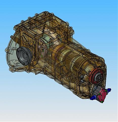

Hi Guys
We now have the final working drawings ready for production of the prototype ZFQ.
We have all the gear sets, crown wheels and pinion shafts already made so we just need to get the casing pattern made to start casting.
Regards
Chris

Hey my friend,
the shifting mechanism is made for a rigid steel pipe operating on the preselector, correct???
Are you flexible enough to give the possibility, by a simple and cheap change, to operate it with push pull Bowden cables???
In the 21st century, people are also looking for some kind of confort.
Believe that the lever vibration is anoing more then you think.
Probably the GT40 application is good like that, but if you want to sell some more, probably it is easyer to shift by cable then by pipe.
Never close the doors behind you, my friend. You may miss a deal for such an ingeniuty.
Is the reverse switch light available???
Do you have an electronic exit as well for the speedometre???
In order you chosed one direction mounting by off setting the pinion, do you have a dynamic oil level in the differential room, in order to keep greased the crown wheel at low speeds as well???
Ahi, Ahi, Ahi, my friend....I told you that street use is not as simple as we can think. It is absolutely not a matter for opinionists. You are investing a huge ammount of green tickets.......at least expect to have the larger application possibility.
Remember my offer.....do you think that an overview from an expert could be helpfull??? You already spent probably a couple of hundred thausand pounds sterlings. 3.000 more are not making the difference for the extended application factor.
Will not tell you more from now. I already helped a lot, risking that my sales are dropping down.

Hi Wanni
I appreciate your expert input but the idea of the ZFQ initially is to be a direct no compromise bolt in replacement for the ZF/RBT GT40 transaxle. Giving the ability to handle greater power than the ZF and to be readily available to purchase off the shelf at a comparable price.
A push pull cable shift is already available for this application and is being supplied and used by the RCR, CAV and SPF GT40 guys already. A reverse light will be incorporated into the final design, I am sure that as we progress and the requirements for use in other cars and their requirements becomes apparent then further considerations will be made. From a marketing point of view I except your points to expand the potential market but for us the prime market is the GT40 at this time.
regards
