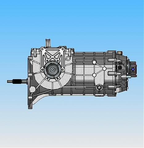

Hi Steve
If you look on the picture above the scavenge port can be scene directly below the output shaft. On the picture below the return port can be scene at the top right rear of the differential casing. The return will feed directly onto the pinion where it meshes with the crown wheel.
The ATB differential runs significantly cooler than the LSD fitted to a ZF/RBT so excessive oil temperatures should not be generated inside the ZFQ.
regards
Chris.

Hi Steve
regards
Chris.
This would probably generate premature hydraulic pittings.
Spray in the exit like all the Porsche and many other boxes are doing.
Again it is not a race box.
It sounds like it is designed under opinionism imputs in state of being designed under experience acquired.
Ciao
Wanni

PS. The ZFQ feeds the return oil to the exit of its crown wheel and pinion so cavitation or hydraulic pitting should not occur.
Regards
Chris
