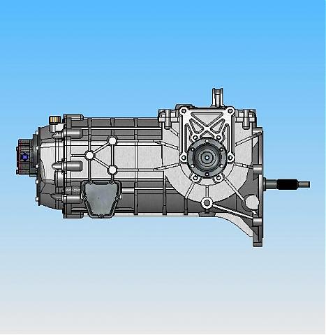

Hi Chris,
spoke to JW at the Autosport about the box... can I ask a silly question.... I see the Gear change Mech is on the right side of the box, can this be flipped to the Left side for LHD cars ?? or do we have to use the Cable change system ????
Also is the cable change system an external bolt on Mech, or do you have 2 levers coming out the box for that system ???
I'm hoping to start my own Mid engined Kit Car Company in the coming months, have a prototype on the jigs at present.. But will need 215+mph capable gear sets with a 28" rear wheel at 7000rpm, will this cost more than the standard price if so how mmuch more ???
Cheers for answers in advance
Clive
If you are driving a LHD car the shifter is in the middle of the car so it should be no problem hooking it up to either the right or left side of the trans. The problem comes in with a RHD car when the shifter is all the way to the right of the car, having it hook up to the left side of the trans is really problematic.
Hi Clive
the ZFQ transaxle will offer a range of gear sets to accommodate use in different cars using larger diameter wheels this may have however an additional tooling cost and would be dependant on quantities required.
The gear change is as shown, a mechanical rod push pull and twist, but a cable shift ZF system as used on the left hand drive SPF cars is available. Otherwise you could invert the trans into the Pantera configuration if a mechanical rod shift was preferred.
I have attached a PDF file showing external dimensions to help with design decisions.
regards
Chris.

Hi Guys
Quaife have made the production of the ZFQ a top priority, just to make it clear that we designed the ZFQ specifically as a direct nut and bolt replacement for the ZF/RBT transmission.
The Superformance's dealer in the UK Nigel Hume has already ordered a ZFQ and has offered the SPF GT40 as a test bed for the prototype trans.
Quaife are now making the first casing and already have the gear sets, crown wheel and pinions on the shelf we were the first to announced our product for this specific market and it shows by the number of other transmission companies now jumping on the band wagon that the decision was right.
Our order book is growing nicely and I believe that the ZFQ will be the trans of choice, we already have RCR, SPF, RF, Tornado and Southern GT, owners that have placed orders.
