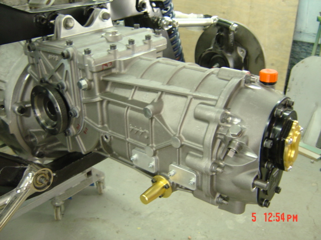

hi Guys

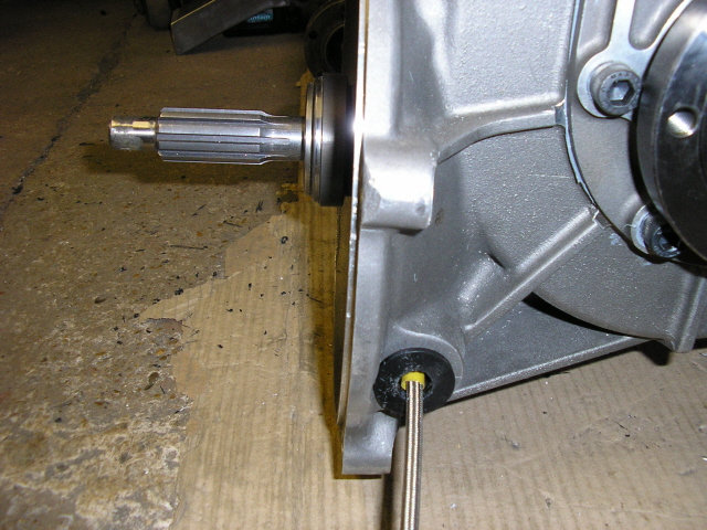

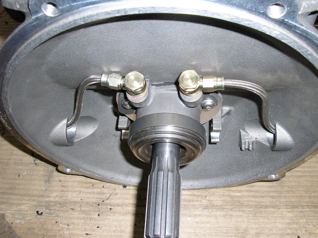

The ZFQ will take either concentric AP thrust bearing or ZF style clutch fork with hydraulic external cylinder.
The ZFQ fits the original GT40 bellhousing.
regards
Chris.

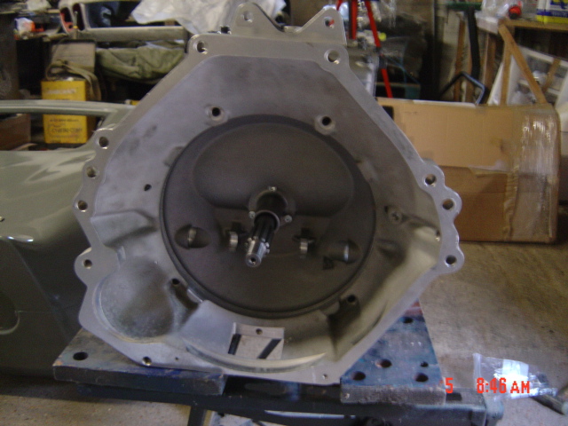

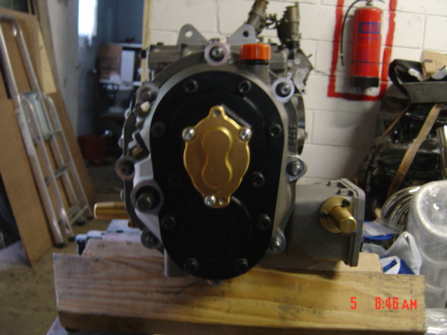

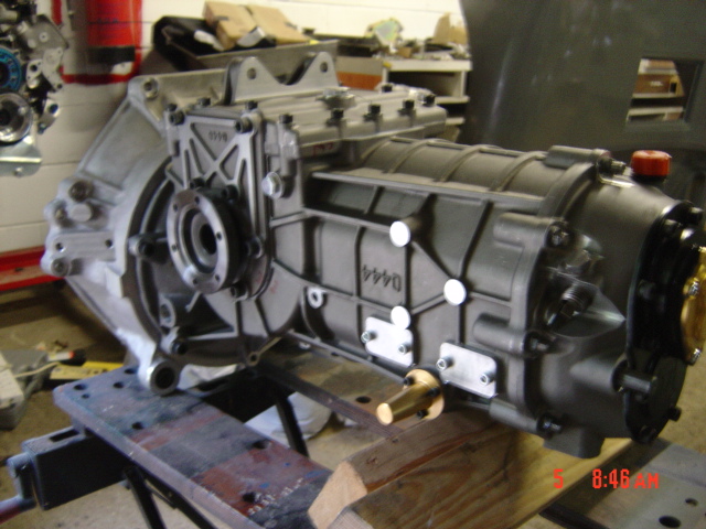

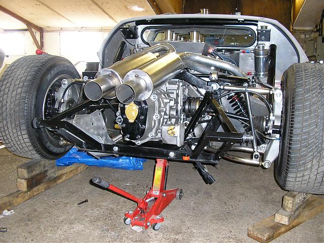

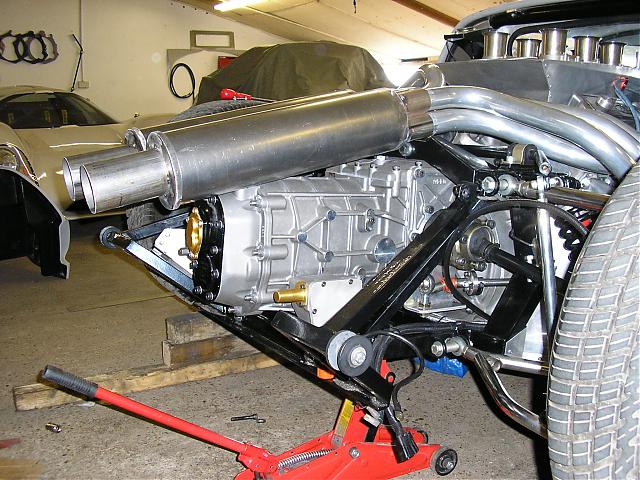

Hi guys
here is the installation into Mick's own Southern GT, Mick just got his car through the SVA and collected the registration document and road Tax this week.
Mick has removed his ZF and installed the ZFQ which has proved to be quite a straight forward job.

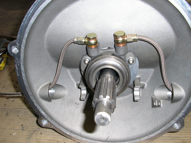

Mick has also developed an external mechanical clutch folk as well as a mounting for an AP concentric thrust bearing to give more options.
In addition to this I have the SPF cable change which we will be fitting to the transaxle ready for SPF installation.
Regards
Chris.
