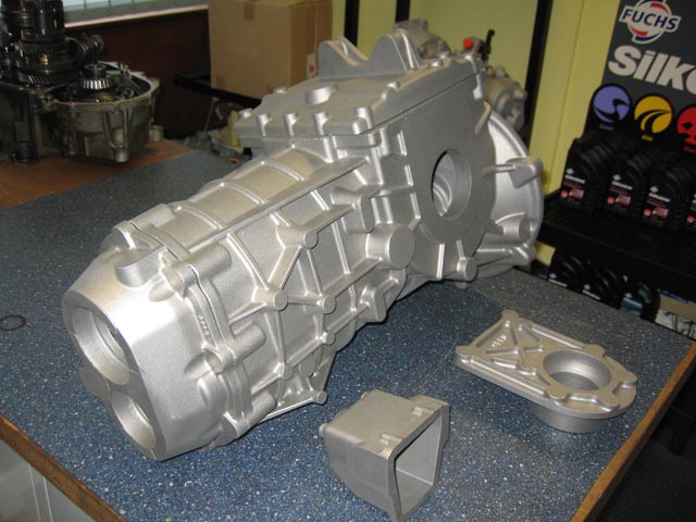

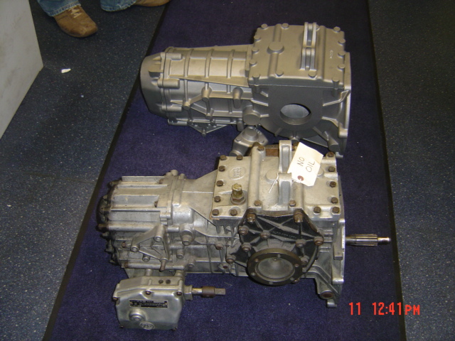

To keep everyone up to date, both myself Chris and John visited Quaife today to check out the first casting to be produced ready for machining. We were extremely impressed with the quality of the casting even in its pre-machined state. The finished box should be on test in the next few weeks.

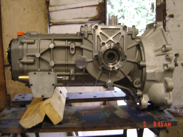

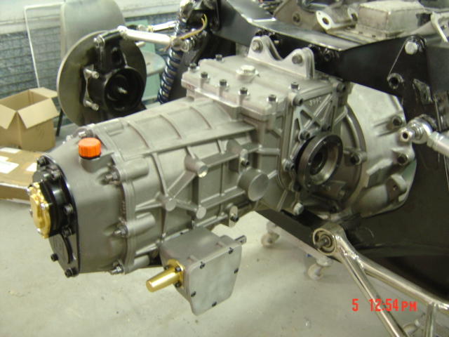

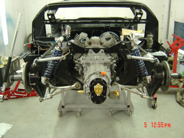

Well I finally got hold of the fist ZFQ ready for testing.
