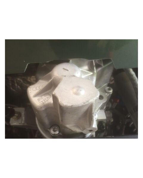

Got the car running today. New shortened shaft turned up. only driven around the backyard but I got all gears and clutch that works. Road testing tomorrow. Still need to adapt speedo wiring. Here's a pic of the rear panel cut out for clearance .

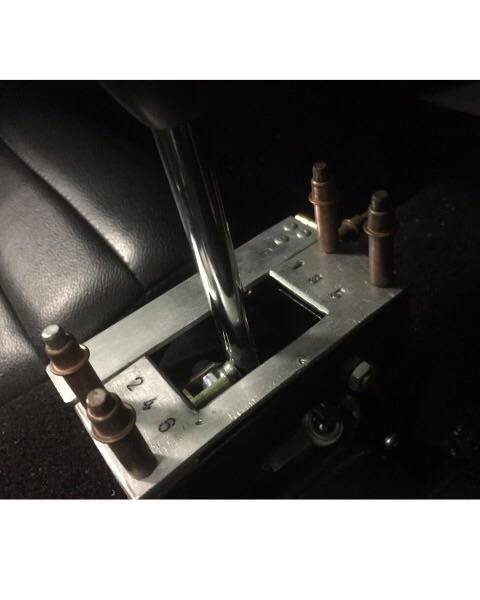

Working on reverse lock out type arrangement for the shifter. I didn't want a gate type plate as that's to Ferrari for me....just something simple at start with a flip up reverse lock out. Also more so as a guide for 1st / 2nd....

Very nice Dave! Simple, effective and kinda period correct in the looks department. You won't mind if I steal your idea would you? I love the simplicity of it.

i found an old bit of alloy with a bit of patina then cut it to shape was very easy . then used normal number stamps and a hinge from the hardware shop, oh and feel free to copy the copy of the copy of someone elses work....ha ha haaa.
