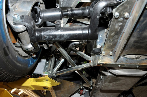

I found this pic, and I can now see where the front engine mount is.
Hi Mick - the picture isn't of the XJ13 but a replica (as you probably already realise). Here is a picture of the rebuilt original up on a ramp. I have coloured one of the lower wishbones and one of the engine mounts in red to make their positions clearer.

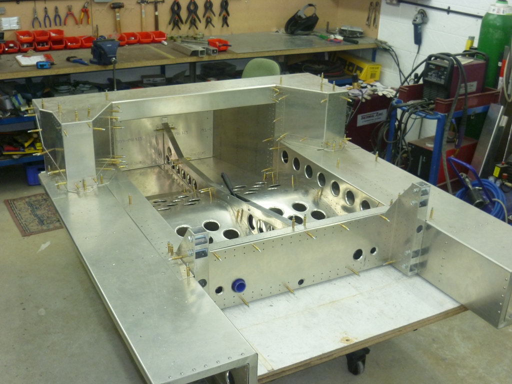

Im building an Alluminium, Rivited, and Bonded chassis for my GT 40, so Im allways looking for different Ideas on how to mount the chassis to the engine/gearbox.

Although the XJ13 chassis was all-aluminium, the chassis engine mounts themselves are steel. Here is a picture taken in 1965 showing the original mounts being built up. You can see how it is constructed using sheets of steel spot-welded together. The whole structure was then covered top and bottom with triangular steel plates. The chassis/sills are strengthened accordingly. The holes you see on the sill are for the dry-sump oil tank and its rubber tank that sits inside.
© Neville Swales - Building the Legend 2013
I have other similar photos taken of the original as well as the precise location of the pin attaching the engine mount in 3D space. You can see the pin above the wooden jig used in place of the engine (just below the "g" in "Legend").
The strength of this structure became evident after the XJ13's inadvertent "crash-test" in 1971. The was no movement at all in this area afterwards. I should add that the rollbar passes through and is bolted/welded to these sill mounts. Again, there was absolutely no movement/distortion after the crash.

Thanks for posting the pic.That is a very simple clever way of making the engine mount.It looks very strong .I havnt decided exactly how im going to mount the engine/gearbox/suspension, but your pics, have given me some more ideas
Here is a pic of my chassis
I have a build log on this site ,here is a link to it http://www.gt40s.com/forum/gt40-build-logs/36067-gt40-aluminium-mononcoque-chassis.html
I will be updating it in about 3 weeks, I will show my Rover V8 engine, the inverted Renault UN103 gearbox,and the rear suspension
