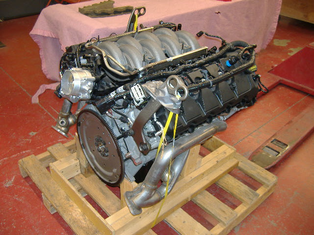

Here is one at the RCR shop already set up for mid engine installation

Fran, since I see you have one there, one of my questions looks like it might be allready answered. It looks like the intake is symmetrical and can be rotated 180 deg. with no problem. The other question is, since the transmission mounting is the same as previous modular motors I assume that the Ricardo will mount directly with no adaptation. Can the stock 5.0 flywheel be utilized with the stock starter and perhaps even the clutch or will the GT clutch still be required? :idea:
X2 :huh:
