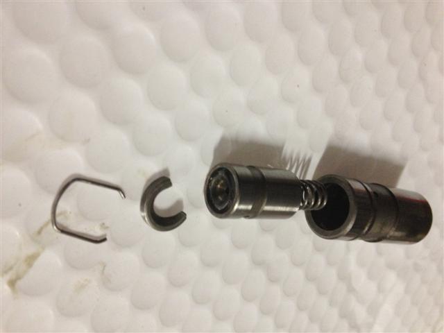

During a routine oil change, the sump plug, with magnet had an interesting piece of metal (Chev schrapnel) attached to it.
The head of a push rod seat in the POS lifter -- I ain't seen thet bafore.
Any clues from the gurus??

Can't say I've ever seen anything like this in probably 30 years of SBF performance related fun. Some folks run the hydraulic lifters with a neutral lash (no compression of the lifter at the base circle, but also no lash as well) in order to prevent "pump up", but that was never an issue I ever had to deal with. That practice would perhaps load up the spring clip, causing it to pop out and spew the internals?
Hi Chris:
I have seen this before in one of my buddies 351 Windsor old stock car engine. One popped out the clip went to the oil pan and into the pump through the hole in the stock pickup locked up the distributor and broke the distributor gear. Two weekends later it happened again. We replaced the whole set of lifters. We used Melling high volume pumps in those engines ithink sometimes the clips lose tension when lifters pump up.

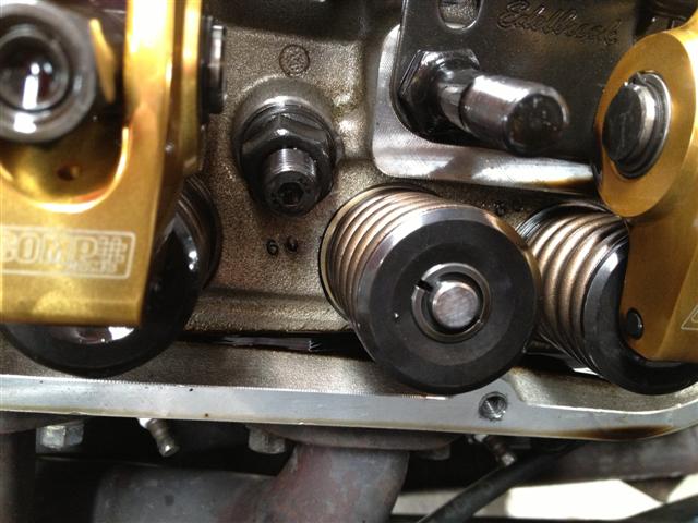

The issue here is not the clip jumping out, but the failure of the pushrod cup at the top/valley end of the lifter, everything being equal & with no other failures evident the lifter would still be functional although its ability to meter the amount of oil up to the pushrod/rockers might be compromised. Now maybe Chris ( or is it Mrs Flatchat:)) might have been unlucky to strike that one in a million lifter with a flaw in production, but its more likely that the valve spring combo is just not suitable for that particular engine spec ( cam/valves/operating RPM level ) where the springs are being operated in a rev range that they cannot cope & going into a 'surge' or resonance period, to check for this my first look is as above & check the end of the valve stem wear pattern as per the pics attached. The parts in the pic appear to have had very little use yet with no definitive mark, but there 'might' be a couple at the points indicated at the yellow arrows, if it was perfect there should be a mark like the pink one. To check further for this the spring/retainer/spring seat if removed should NOT be polished or show indications of rotation relevant to one another.
If the spring has been in a surge or resonant state to creat clearance in the valve train & the loads on that pushrod cup will be muliplied as the valve uis opened in the same manner as if you gave the pushrod a smack with a hammer at the same time. Over time this could also happen on cold starts where the lifters have to pump up where the springs bleed the lifter down. On that note if you have an oil surge issue with air being pumped into the system the same thing can happen.

Thanks Jac , the pink bit gets nicely massaged in that exact area - although not as often as it would like these days.:laugh: I'll check for rotations, otherwise its going back together and hope that it was only the third in a million fault
The motor ran and sounded normal , the clip was intact and the push rod seat is loc solid in its housing

Engine is running sweetly again, every thing checked out OK, and apparently its a reasonably common occurance. (of late) Why ? I'm mystified
What you could try is cut the top out of an old rocker cover, weld a metal 'fence ' about 8" tall all around the cover, mark the retainers with a white crayon, hook your timing light up to the coil>dizzy HT lead and run the engine thru the rev range while observing the retainer marks, if the retainer/s- springs are rotating you have a spring problem at that particular RPM- a part turn of rotation now & again is not an issue, but ongoing rotation is.

Is what you're say Jac, that faulty or weak springs that cause rotations or is there another issue
Yes, and also can be just wrong combination of spring/retainer/valve for that particular cam lobe profile. Only way to be really sure is look for multiple or completely shiny pattern on end of valve stems or check retainer/spring/spring seat interface for 'shiny' surface which indicate lots of rotation or with a strobe light as per earlier post, if the valve train is getting those indications then it means that it is operating in a 'loose' state at some time during its operation & the pushrod/lifter cup being the weakest link fails. For most part if you have the valve train specced by the manufacturer then you 'should' be OK, but really it doesnt take too long to do the strobe check once you have the modded rocker cover... I remember some tourist boats I worked with in Q-Town NZ, they were having no problems until they changed suppliers for the jet unit impellors, the 'new' impellors dropped the operating RPM to 3800 from previous 4200, Speed remained the same, so they were happy, but not for long as motors started dropping exhaust valves- lost about 4 motors before someone suggested perhaps the 3800 rpm was the culprit- bingo!
