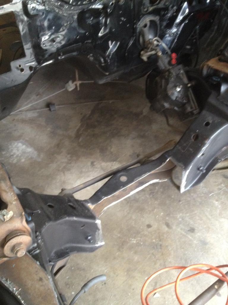

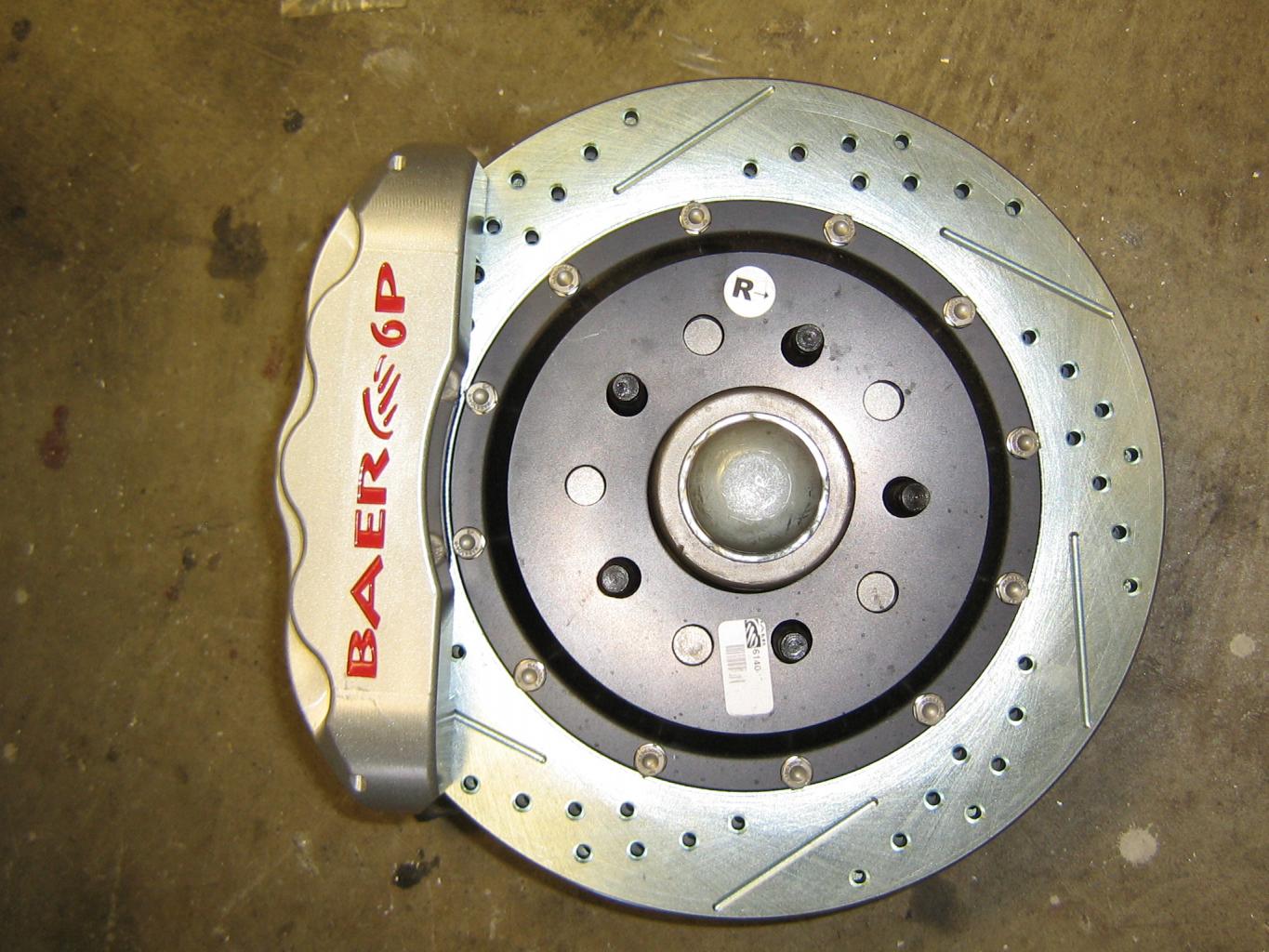

Hi. I am building a 1973 torino with a 514 and a 5 speed as well. i moved the engine back on my car 3" and lowered it 2". it was a piece of cake as long as you dont have air. but i have to make custom headers for it now. its only money i will get more somewere, someday. right know i am getting eady to send t off to my friends house so we can put a roll cage in it, i dont have a bender. going to replace the rear shocks with coil overs and remove the factory coils and replace the front coils with coil overs as well when i install my Bear brakes. would like to know if you have made any more progress recently? :shy:

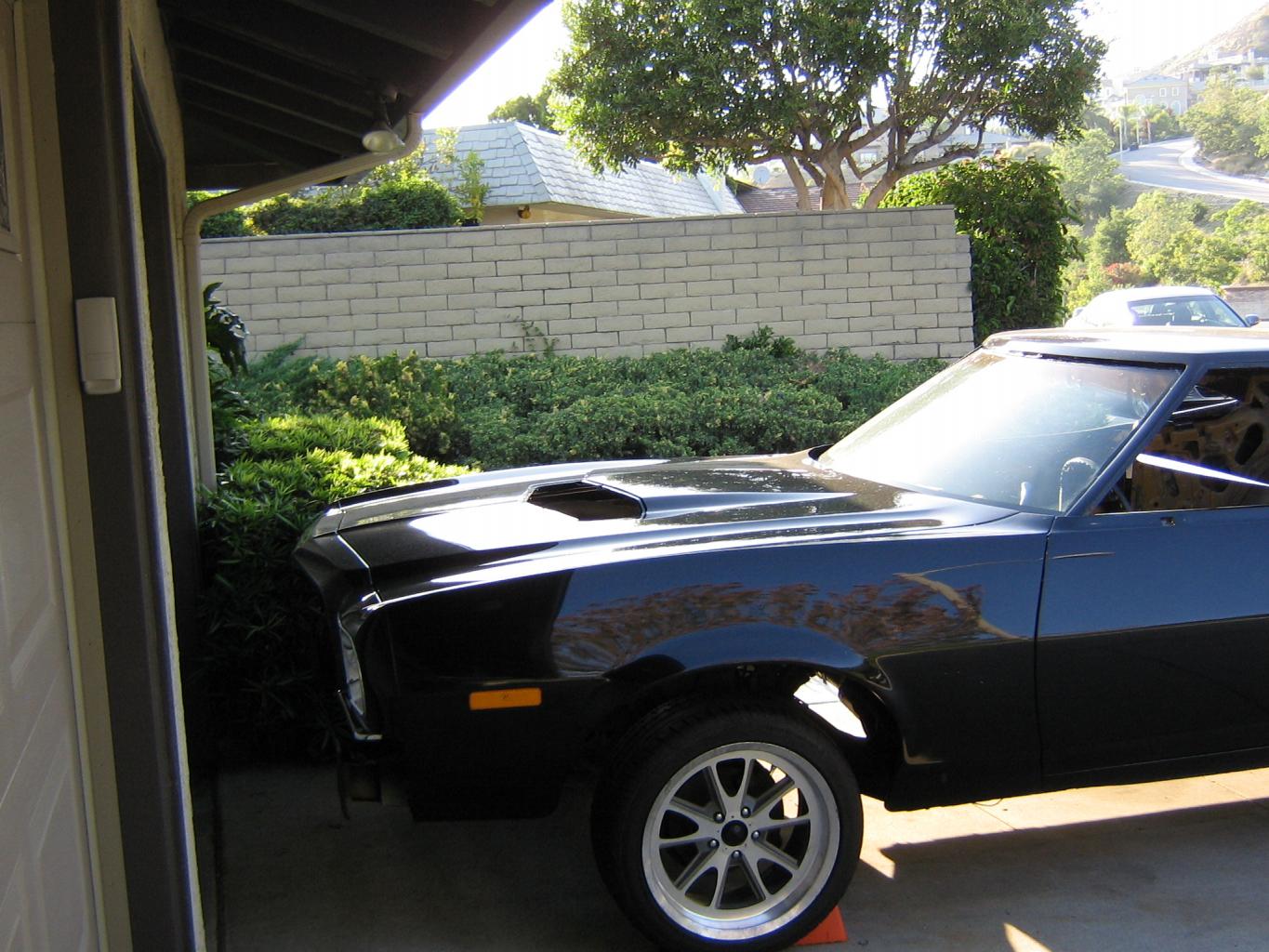

Here are a few recent pictures:
The scale screen was shot with the car all up, that is, all fluids except gas and driver. That weight isn't too bad for a car this size. Many modern two door coupes hit this weight (M3, GTO, GT500s, ZL1).

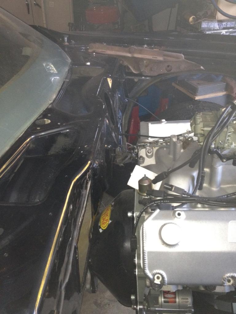

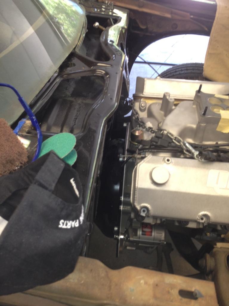

No, the Torino isn't driving yet but it is very close to being so. The engine was fired, interior installed, and now we're just sorting out a few of the smaller things while the car is finished up. Here are a bunch of pics sort of out lining progress since late November.
Got myself some aluminum welding on. And it didn't leak!
Jeff G and I have been working on this car almost flat out since late November. It looks easy in pictures, but there were many snags and mini projects along the way.
