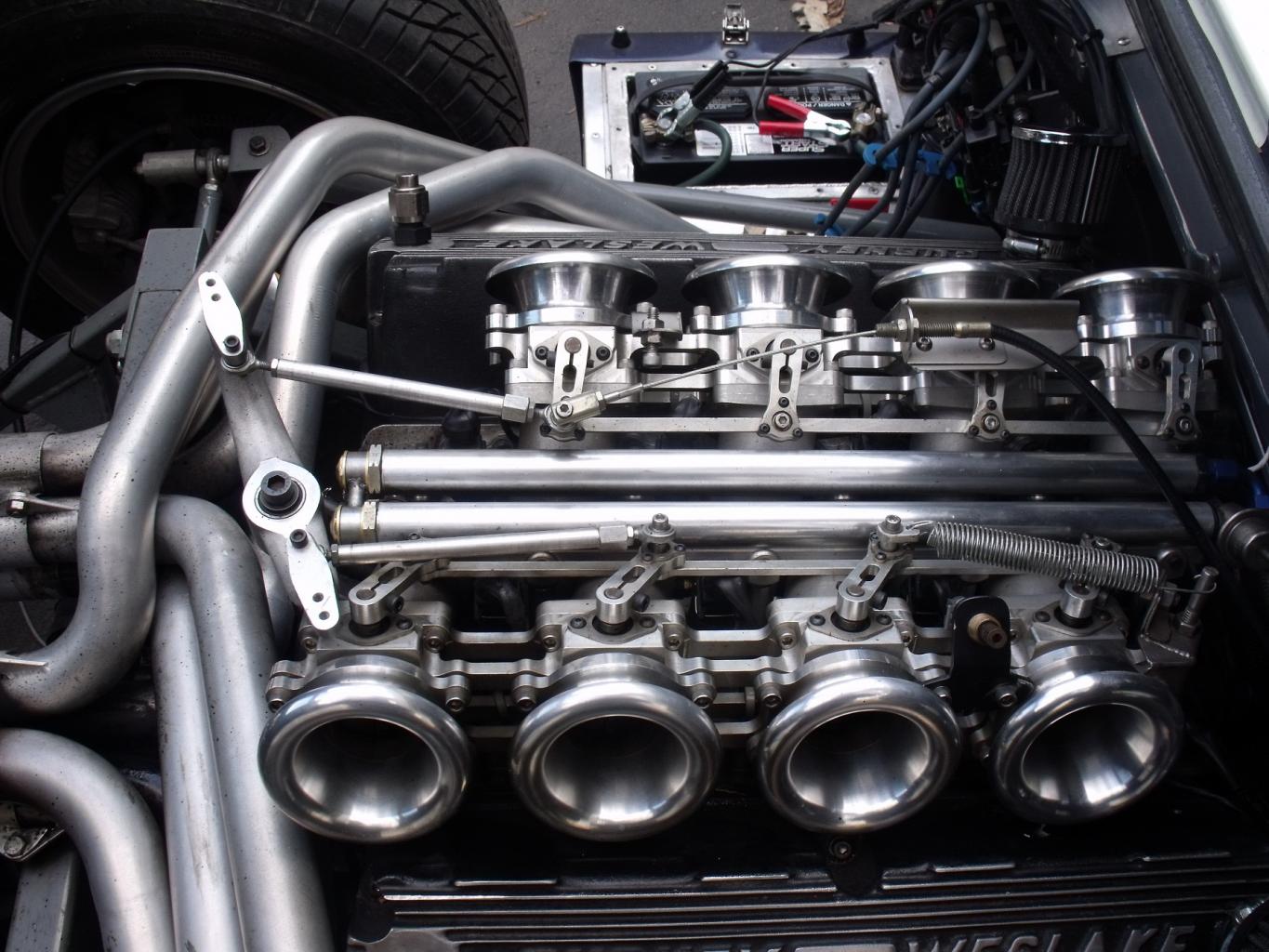

I have the old Borla units(TWM) and I can tell you they are great. You need someone to set them up right for you unless you have experience doing this sort of thing. I set mine and it took quite a while. I am not sure of the port design of the manifold on the sloping units. On mine I have the AFR 205 heads that out performed(flow test) all the other comparable heads in a shoot out. I had to open up the intake manifold ports to match the AFRs.
As you an see they are huge. The intake gaskets make the outline a breeze. This will help cut down on the turbulence in the air flow. Add a hydraulic roller cam(Comp) with roller rockers. And breathe,,,,,,, unbelievable.

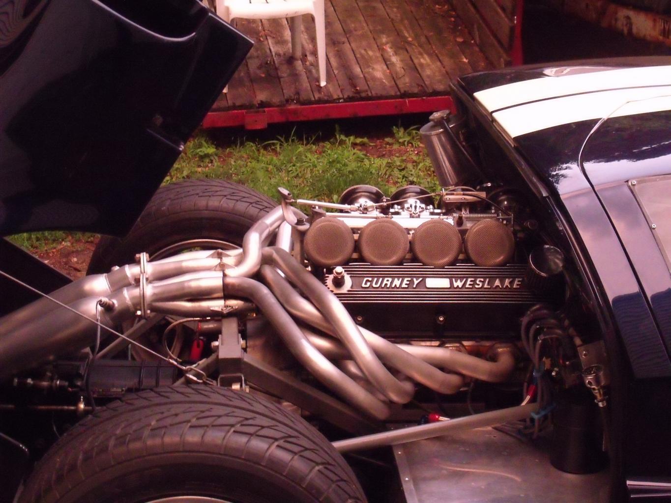

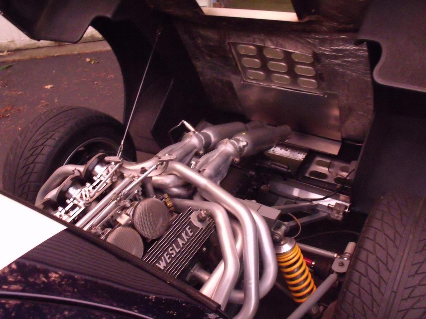

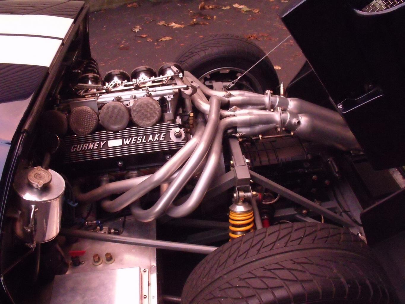

I've had the Eight Stack system on my car for a bit more than three years. In fact, my car was the test car for their system. They've made some improvements over the years, and I've been very pleased with my system. I think it's the best visual match for the original Weber system as well.
The only downside is that their stacks are only designed for their thin air filters. Dennis Olthoff replaced their stacks with ones that fit the K&N filters I use. Much better protection for the engine, but it still highlights the individual stacks.
I think the acquisition of Eight Stack by Borla will also be a good thing. Good luck with your decision!

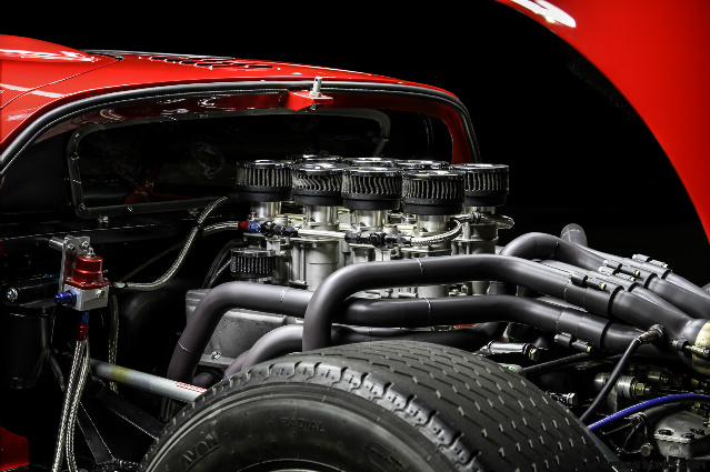

Question on the Eight Stack/Borla. I'm planning on the system from Borla; they offer several air horn heights - is there a problem with horns as high as 100mm and clearance with the rear glass? Obviously it all depends on the motor mount configuration - just a question in general as I was told by Borla the taller the stack the more torque and better sound?
Dave Hood
Doug - I doubt that 100mm would be a problem. But as you said, it does depend on the motor mount. Also on the type of filters you intend to use on your horns. My K&N filters are about 2.5 inches tall.
Filters kind of kill the look of the stacks does it not? Do the K&N just snap on the top of the stack, and what model are they? Can you speak to the issue of torque & sound on the height of the stacks? Thanks

Doug - my K&N filters were installed by Dennis Olthoff. They have a rubber gasket on the bottom that just fits over the top of the stack. Dennis' input was that most of the screen filters people use on their stacks don't do much to keep dirt and dust from the engine. Since I use eight separate filters, I think it's a good balance between protecting the engine and retaining the look of the stack injection system. But it's all a matter of personal preference, of course.
