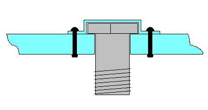

What I need is a way of fixing these steel bolts (at least temporarily) in the adaptor plate so I can bolt up the gearbox. Once the box is in place the nuts can be tightened and the bolt heads don't seem to revolve, it's just getting it mated in the first place.
I've thought of aralditing them in place, but I guess one whack with a 100lb gearbox would possibly push them straight back out.
There are 9 bolts alltogether and the ali is too thin to drill and tap
Any advice or tips greatly appreciated.

Hi Simon,
Could you make up a small ali strap over each bolt head and rivet or weld it onto the adaptor plate (see pic). This will hold the bolt and also prevent rotation when you tighten it up.

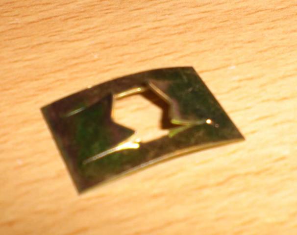

OK, may have stumbled upon the solution.
I found these in my garage. I don't have enough and they may be the wrong size but they'd do the job perfectly.
Anyone know if they have a name and if so, where in the UK I can get more?
Simon

don't keep us in suspense, what have you found in your garage
Can't tell you the name, as I'm not feeling very telepathic this morning :laugh:
Simon
Simon,
These are known as "spire" nuts and come in many guises, some of which are "caged" and hold a floating nut within. Readily available from many restoration / fixings companies.
