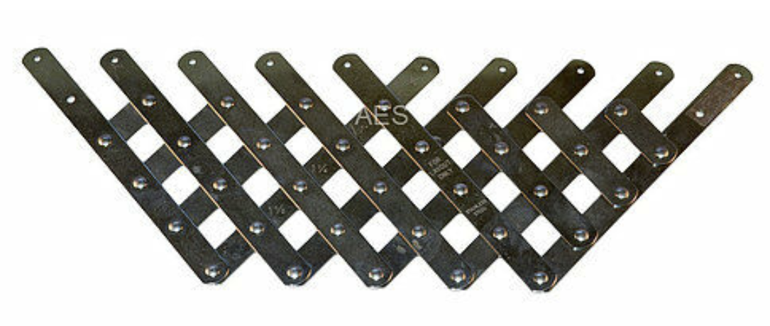

Agree with Brian, get yourself a rivet spacer best tool I had at the time and means nice straight lines of even rivet holes, then Cleco's I used loads for a nice dry fit of all panels and don't be in too much of a rush to rivet then if they are in areas for pipes and cables, I had to drill a few panels out before I learnt

LAS Aero spacing tool:- https://www.lasaero.com/products/article/Z00TTVJ85

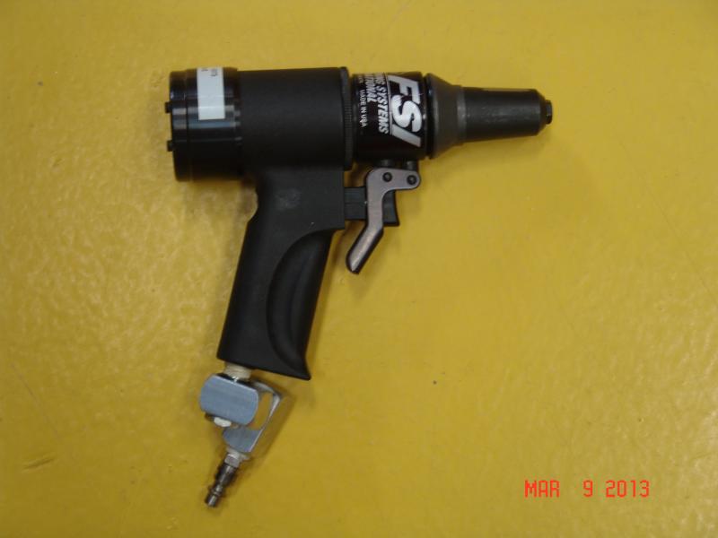

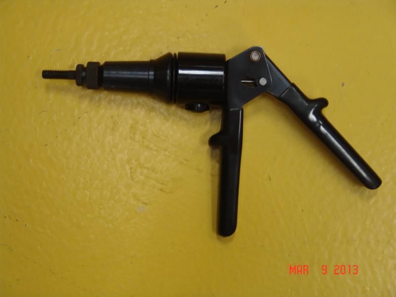

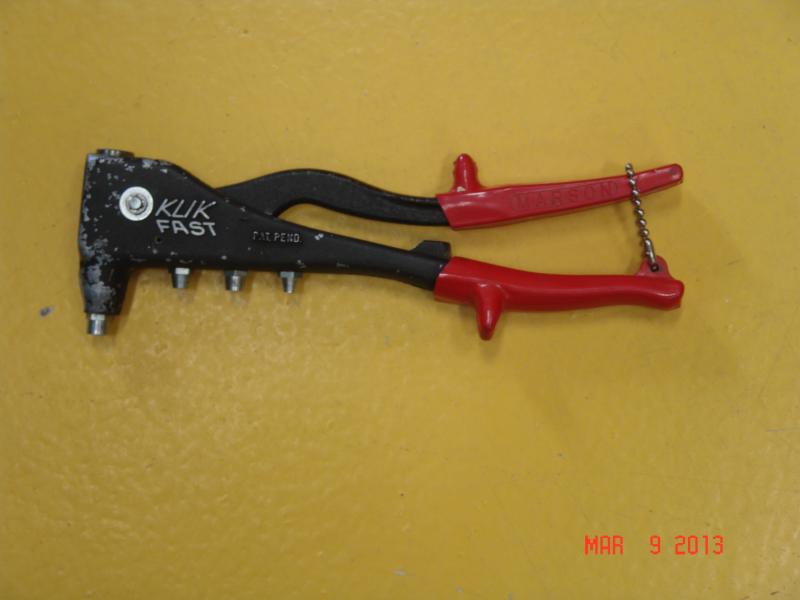

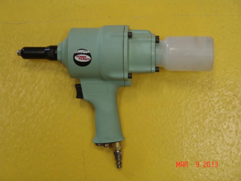

Brian has the sequence correct. My method of deburring rivet holes is to use a countersink. A machinist friend years ago made some nice aluminum handles for three sizes of countersinks which made the job easy. Only remove the burr, don't countersink the hole! I frequently use an pneumatic/hydraulic rivet gun made by FSI for its pulling strength but I use others, too.
Rivet spacing and edge distance can be found on websites such as the EAA, etc. If you are using a high strength alloy such as 7075-T6, 2024-T3, or 6061-T6 it pays to use high strength rivets such as CherryMax, etc, This adds significant structural strength to your chassis. If, on the other hand the panels are soft aluminum and their purpose is only to close out the openings, at least use AVEX rivets, not hardware store pop rivets.

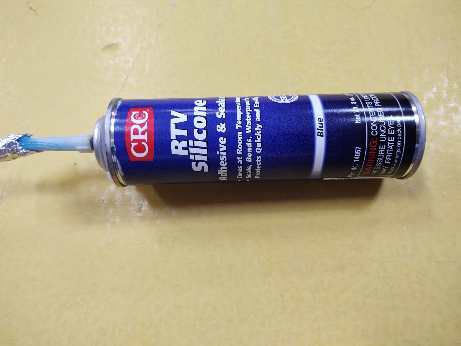

I'm going to ask perhaps a silly question, but one that has always been on my mind. What is done on preparation of surfaces for this? Suppose I want to panel a steel chassis with aluminum sheet. Obviously paint or some coating must be used to prevent rust, but I would assume the aluminum to steel adhesive bonding must be free of any coating. So if that assumption is valid, what is being practiced in protecting the bare steel that is not coated (the transition between the adhesive and the remaining painted surface (after removing paint from the chassis where each panel surface will be bonded)? I can't imagine painting or coating the chassis AFTER the aluminum panels have been attached, thus the reason for this question.
Neil
I did not want to bond the stressed panels on to the epoxy primed & polyurethane painted steel tubing so I simply sealed the interface with a blue foam RTV made by CRC. This keeps water from penetrating the faying surfaces and also seals the rivet holes. The CRC container is pressurized and the foam is dispensed directly from a long plastic nozzle.
Better off having some coating (paint or powdercoat) on the steel to prevent galvanic corrosion in case they come into contact. Aluminum panels are also usually painted, powdercoated, or less often anodized.
