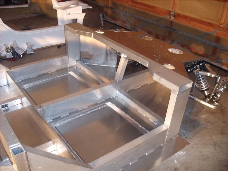

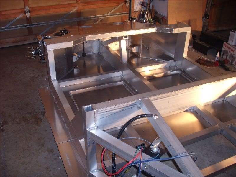

I've wiped down 1/2 my chassis with acetone (3 bottles for the front half), and doing 4 coats of sharkhide. Then I'll decide what I'm doing (if I see any runs, etc..., I'll remove it).
So far so good though, but need for it to fully cure.
That looks real good Alex....
Great post by the way :2thumbsup:
It seems right now to be a great product. I havn't found any runs or solvent pop anywhere from it drying. I found it when doing my cobra's aluminum (long story short; didn't work that well on polished aluminum for me - it brought out all the flaws in it; brushed/raw is a different story though).
What I've done so far is
- wipe down areas thoroughly with acetone or mek. I wiped down the front half of the chassis 3x, took 3cans of acetone.
- using a cotton cloth (so it doesn't shed and lint), saturate it with the SH and swipe it on. YOu don't rub it back and forth, just 1 pass east to west, then move up a few inches and go west to east (so you're doing slightly overlapping passes heading over the material). On the next application, go the opposite (e.g., north to south)
- it dries in about 2-3minutes; cures fully in about 24hrs. So I'm doing coat-24hrs-coat-24hrs-coat-48hrs-last coat. You could get away with fewer, but I don't want to do this again ever. In a marine environment (depending on 10001 factors) it can last up to 8yrs. In a non-marine environment like we'll see, theoretically it should last 20+yrs as long as you don't drop acetone/mek/thinner on it, or gasolline (and if you, you just wipe the area down with water, then re-apply the SH)
I've also coated my suspension pieces; also, something interesting I found out is that apparently you can coat black oxide bolts (e.g., big rocker bolt) with it so it won't rust.
I plan on doing nothing to the bare aluminum in my car. I bet it looks the same as yours in due time.

I waas studying my cobra rad shroud (t6 6061) and coming my brand new one to one I've had for a year and a half. The older one is a bit darker grey than the new one, but still virtually the same.

Actually the sharkhide keeps it looking exactly as it did before. Portions I didn't coat also look basically brand new. If I were to do it again, I don't think I would bother coating it or doing anything other than leaving it as is.

I look at some of the aluminum stuff that sits outside 24/7 (e.g., aluminum ladders) and they arn't in too bad a shape (for a 30yr old ladder that's been outside all its life).
I'm not too worried about it - plus the headache it makes for cleanup if you want to weld on the chassis, meh, not really worth it. If I were doing it again, I wouldn't coat the chassis with anything. I'd let it just age naturally.
