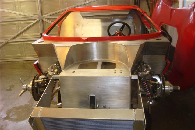

Gents, I too have the conundrum of what to do with my chassis. Currently (as purchased/3rd owner) my chassis is in a state of scotch brite scratch (read: ass)! There are several panels front and rear that have not been attacked and lend themselves to being polished. That said, do I paint the remainder of the chassis or attempt a brushed look? 3M does make numerous hook-it discs with different grits, has anyone used that type of thing for a brushed look?

Doug, that's a very difficult decision. Personally for a 40, I would paint semi-gloss black. That said, my SL-C is now partly polished and partly semi-gloss black.
Doug,
I would recommend a treatment similar to Eglitom .....if some areas are unrepairable/polishable.
The chassis on Allen Englishes car...is black in the front footbox, spare wheel well area and is natural aluminum in the engine bay...it looks great and will "show" well...
