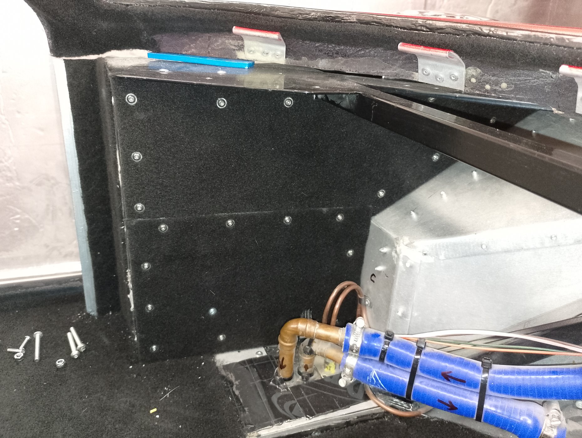

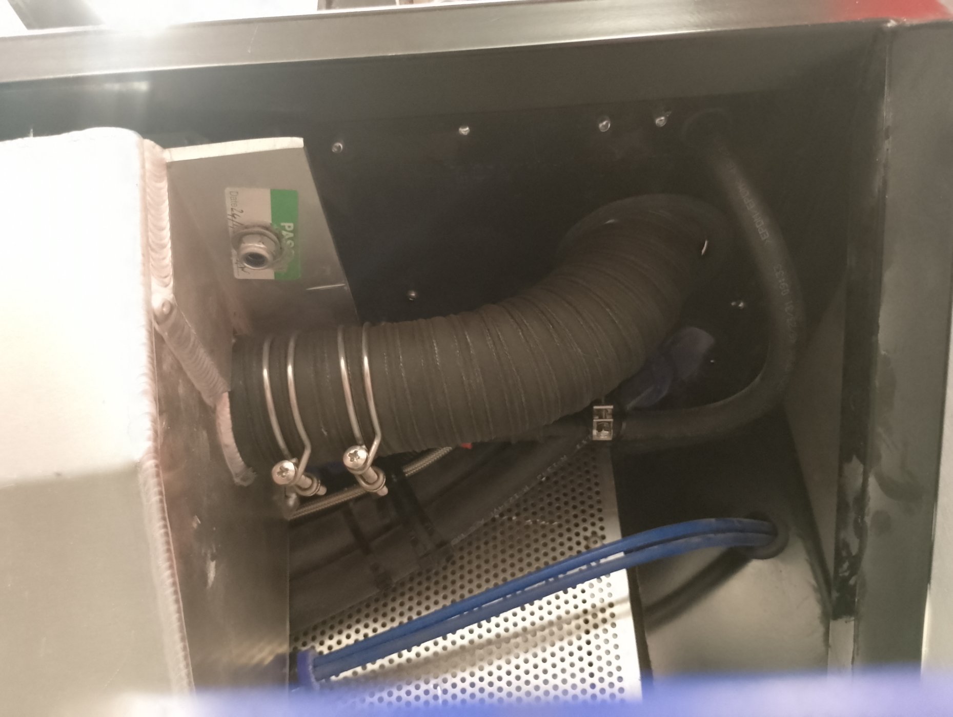

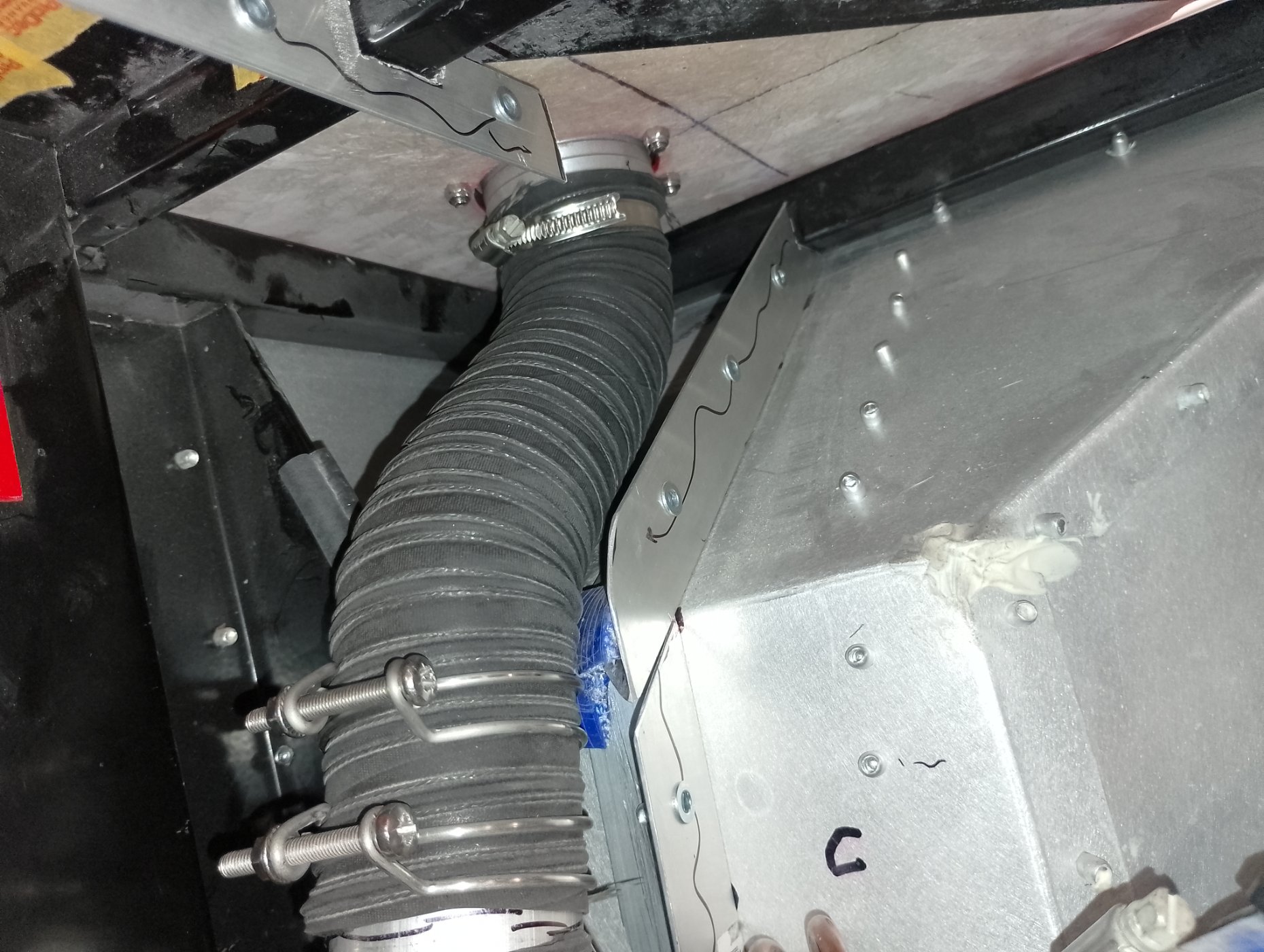

left side fuel filler connections:

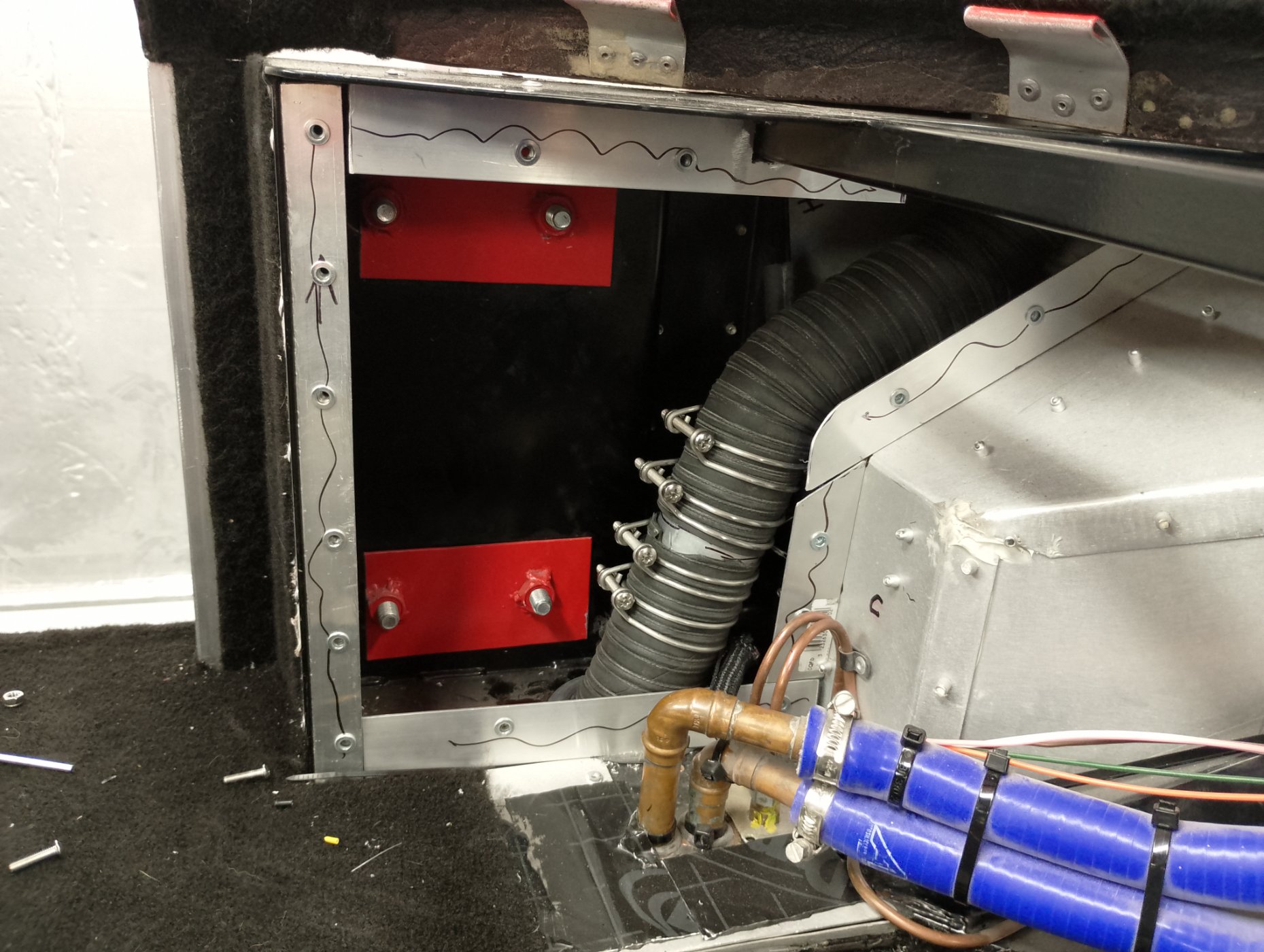

right side fuel filler connections
boxed in for IVA Approval.

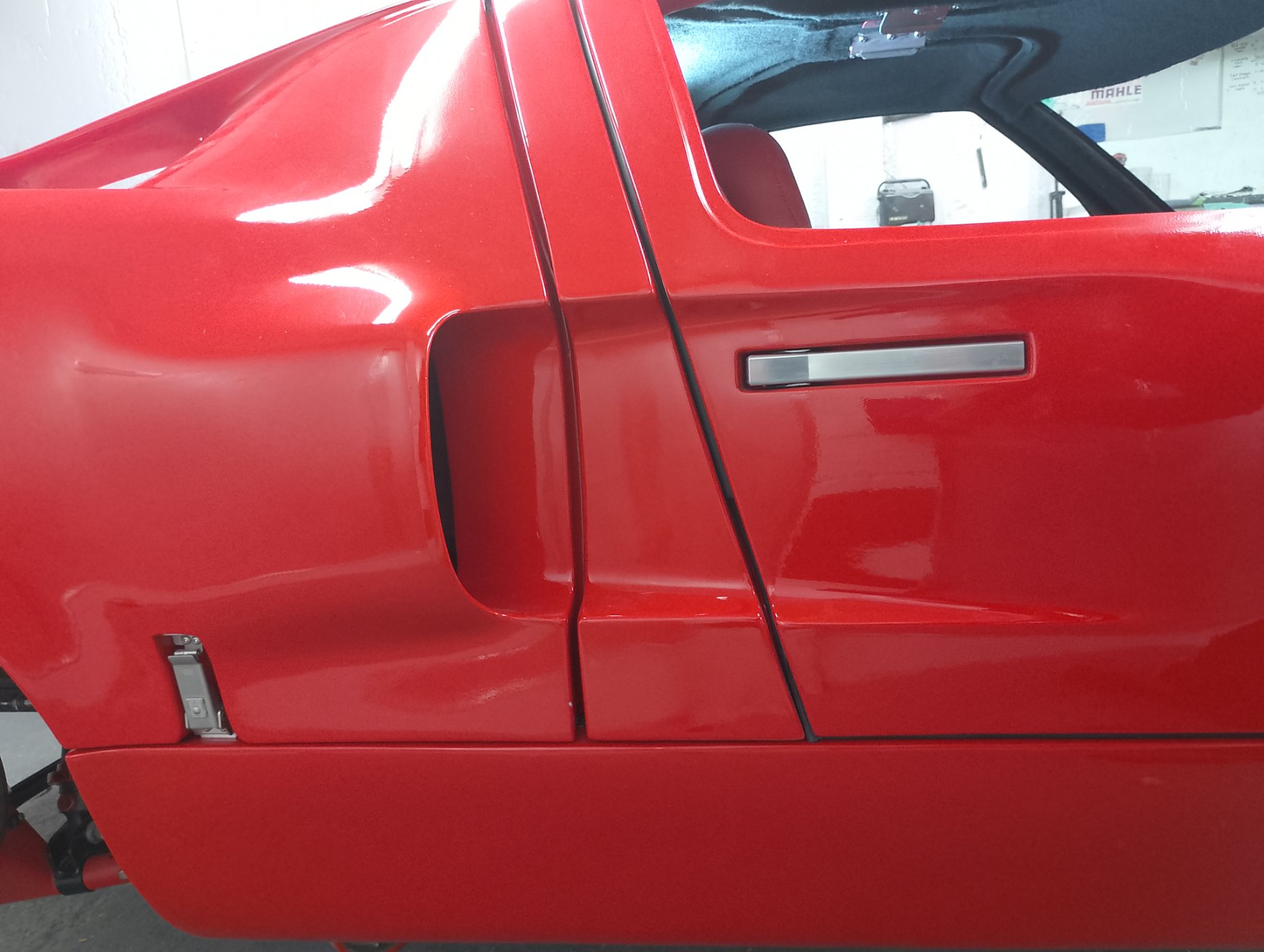

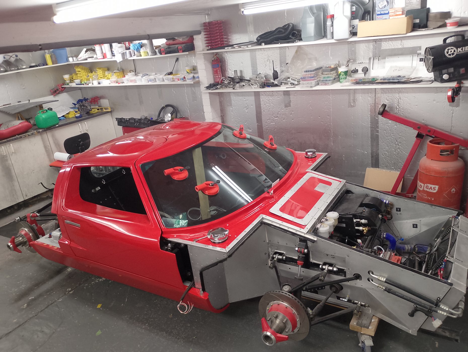

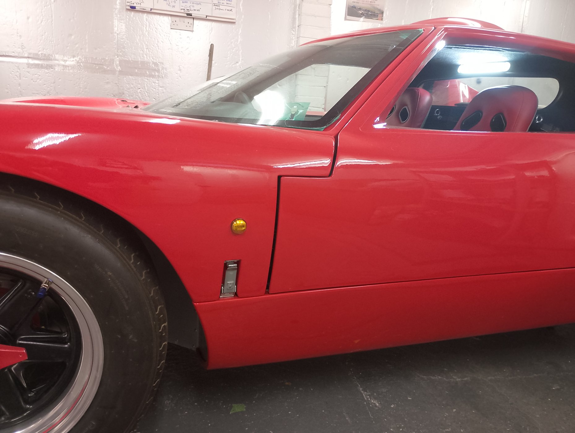

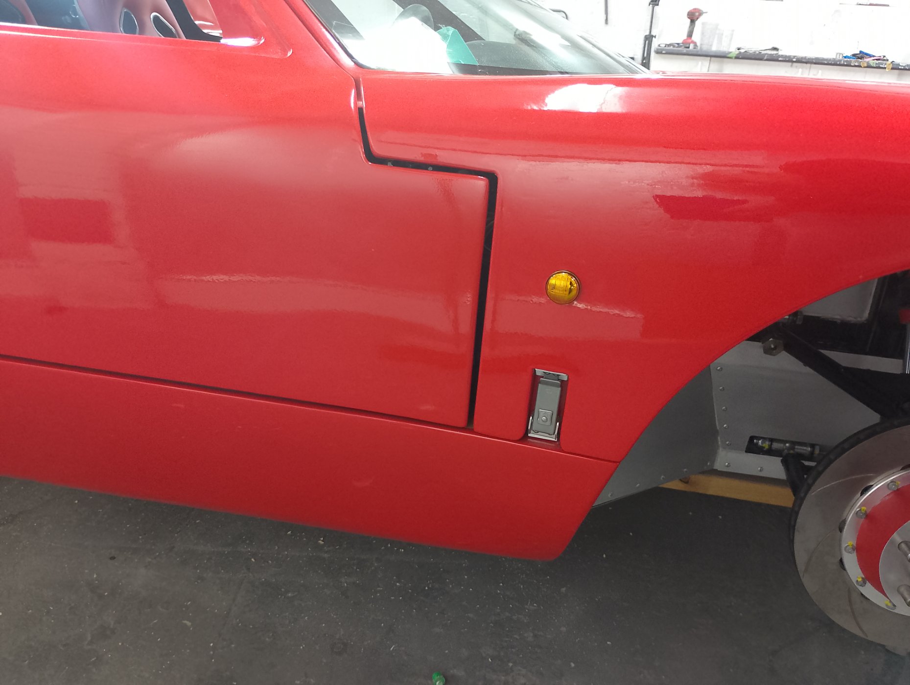

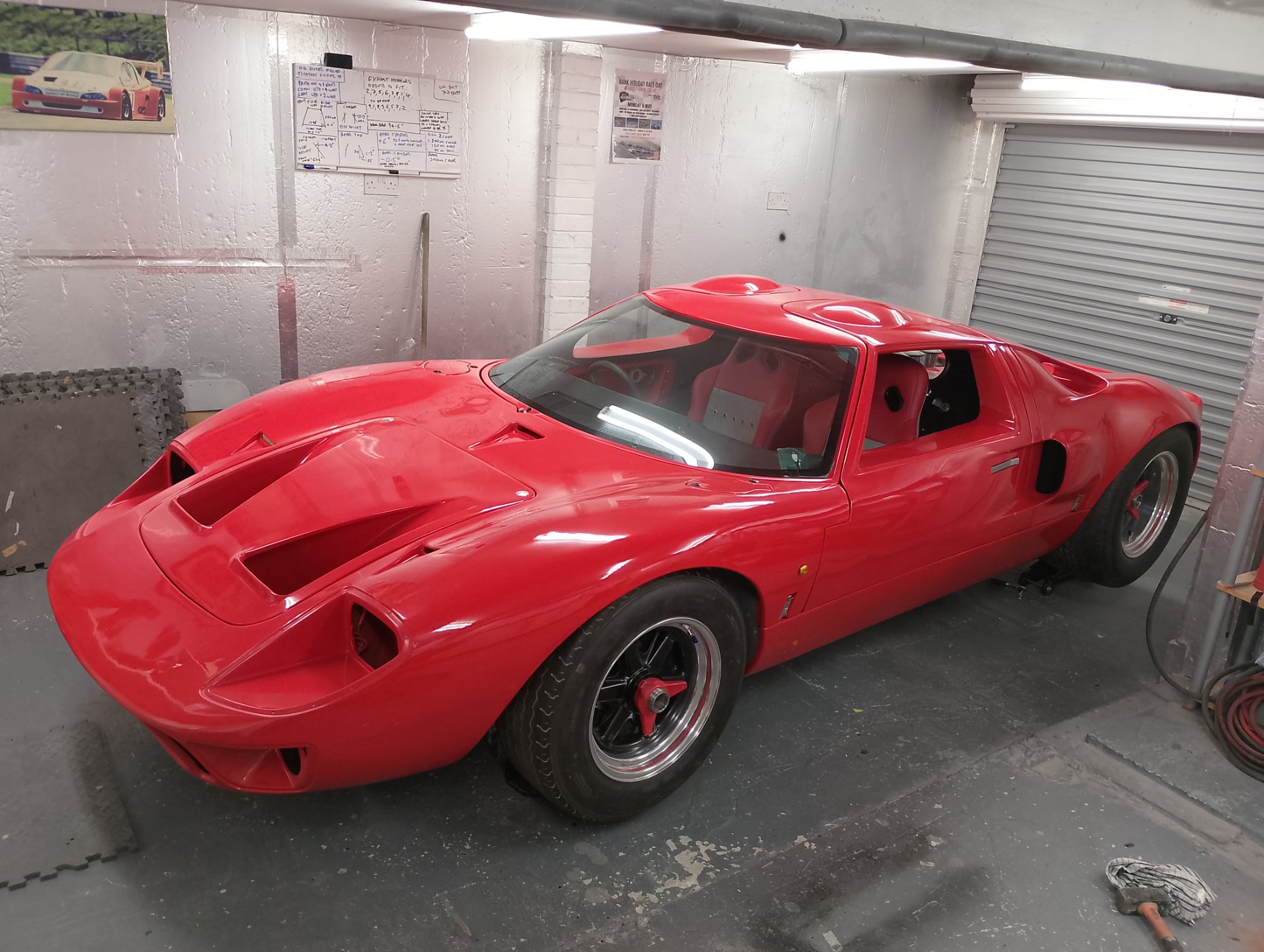

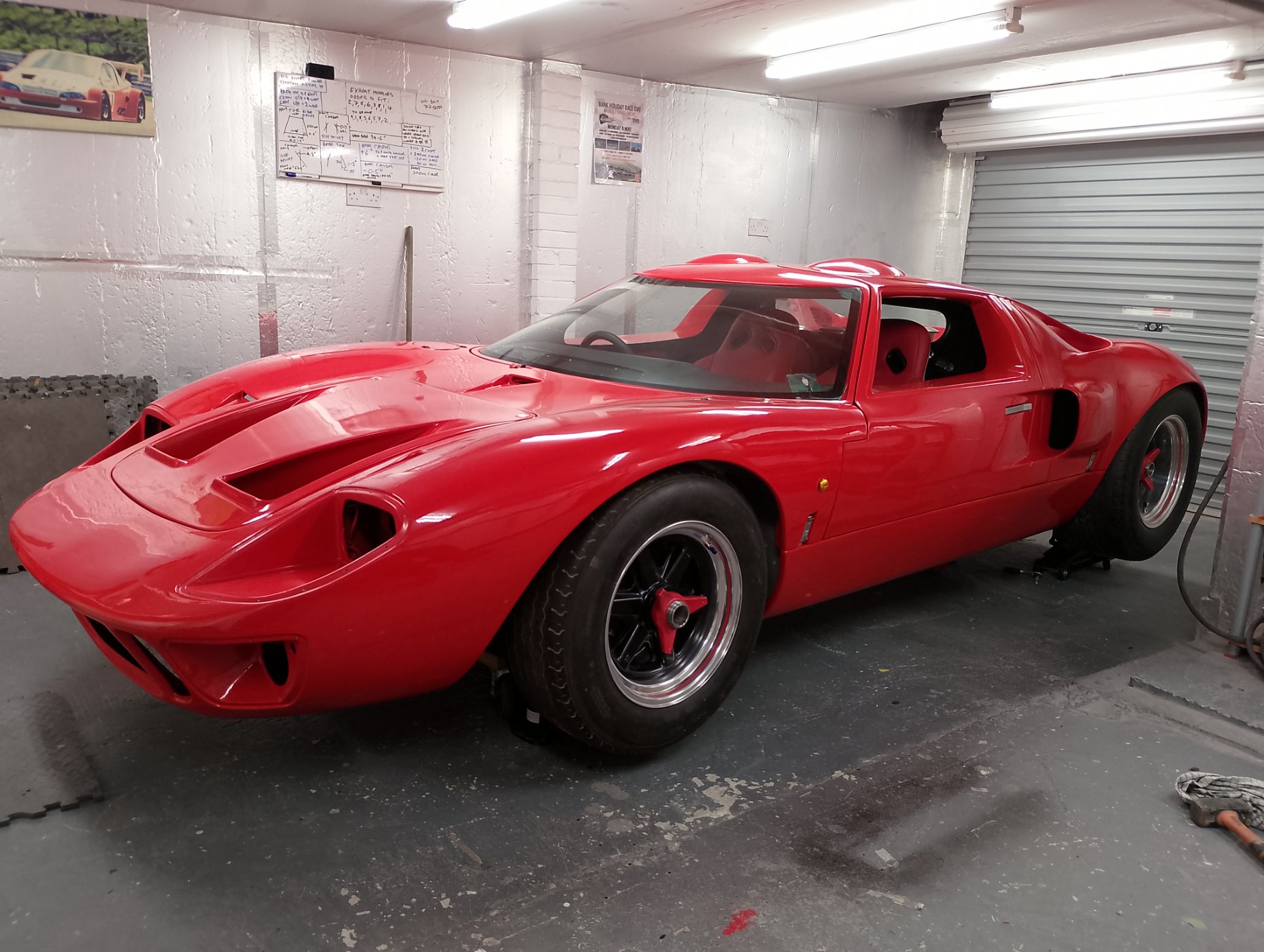

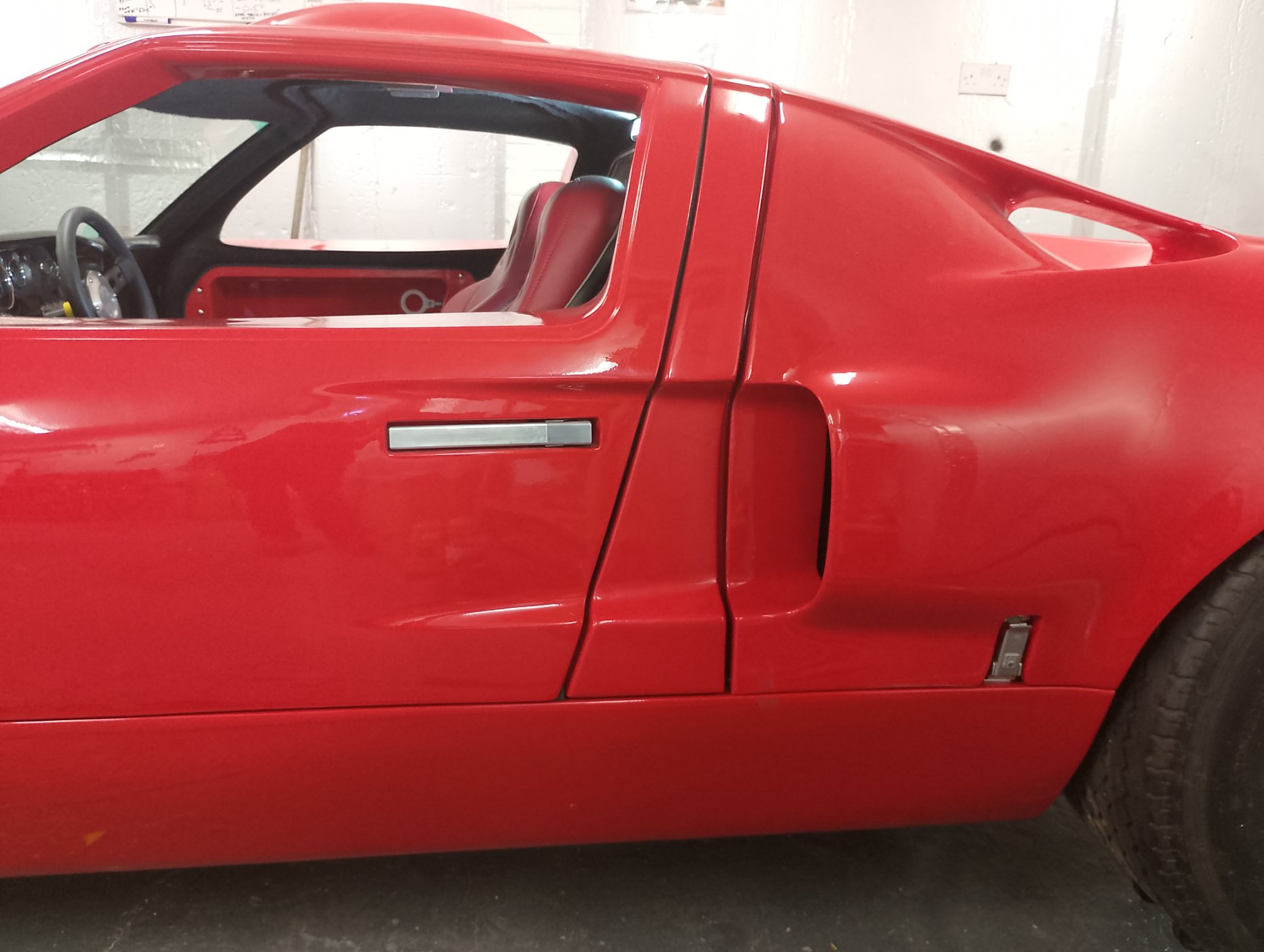

and fitting body panels and checking shut gaps...

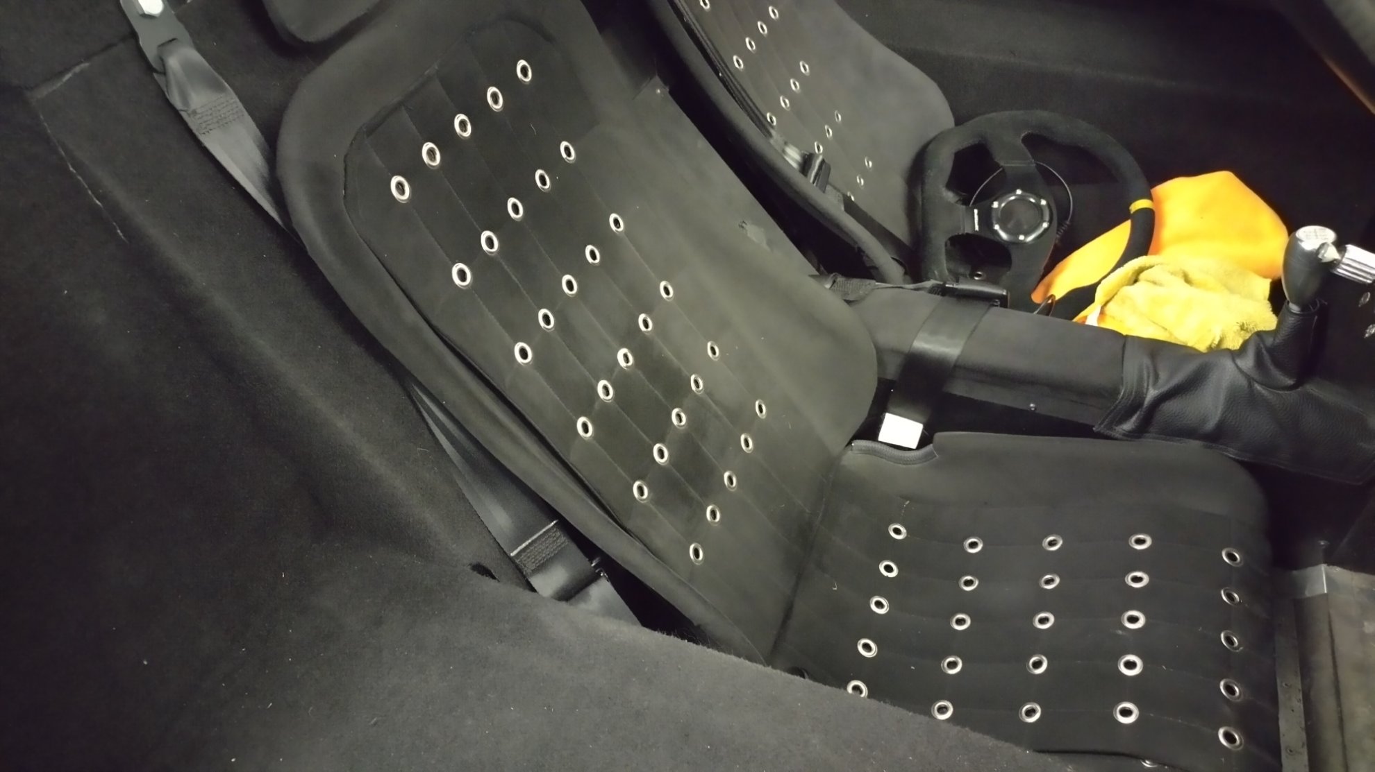

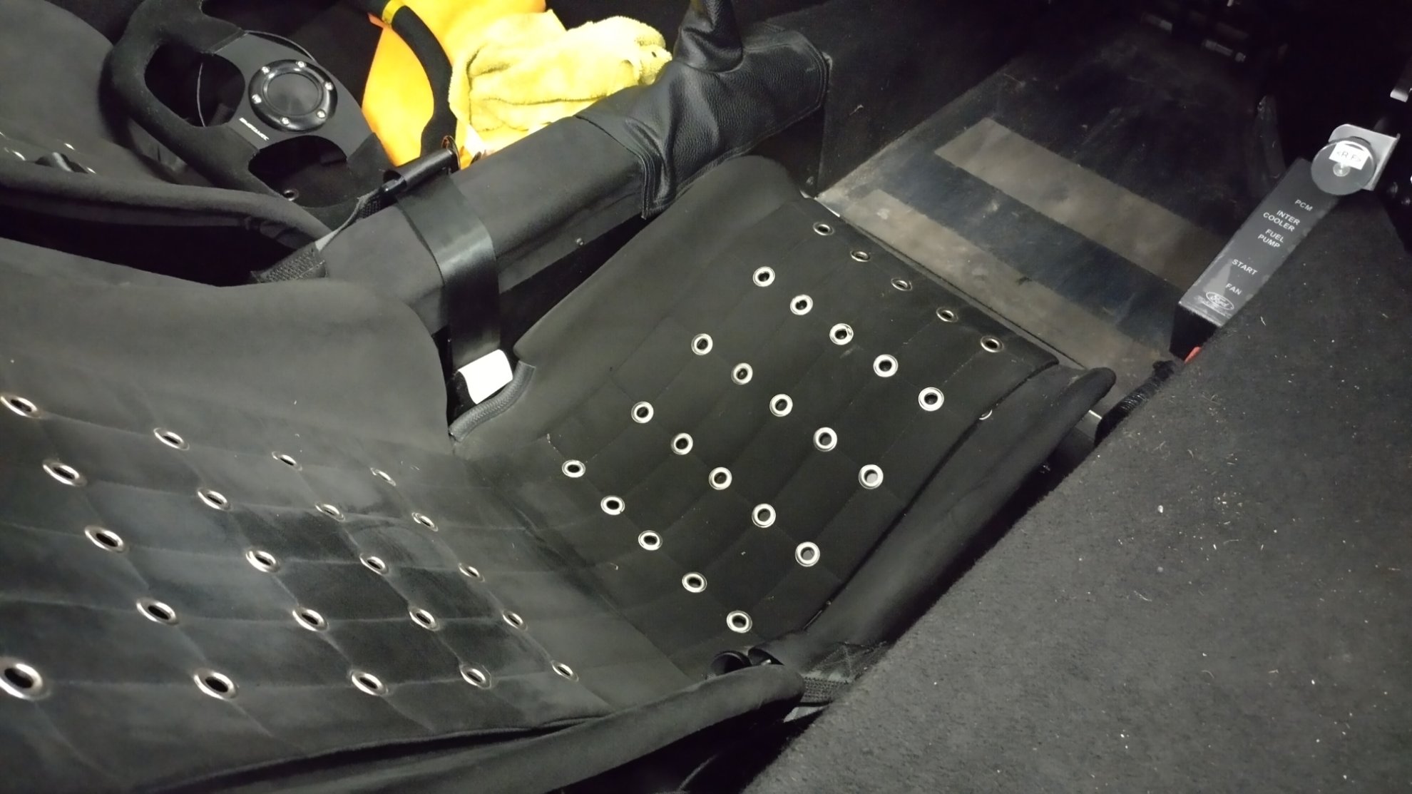

Hi Jerry, just caught your build for the first time and your seats got my attention. Depending on your height, you may want to consider not installing conventional seats, rather follow the original design ethos. Fabricate a set of brackets to hold a minimal seat base and a separate seat back, both pieces as minimal as possible to maximise the cabin space for you.
Thanks for the suggestion Martin..
I'm not the tallest person and my brother in law ( other driver ) has long legs but body height similar to mine.
With the bubbles fitted we both can sit quite comfortable with helmets on.
Me with the seat slid forward and brother in law with seat slid back.
Jerry
Devin
Jerry, something to consider that I found useful as a taller (6’1”) builder…I changed the angle of the seat with more reclining back by fabricating a front riser that bolted to the adjustable rails. This made it way more comfortable with longer legs as my thighs had more bolstered support from the seat base. So much better that I even had to bring the seat forward a notch from the previous most rearward position.
Thanks Devin,
Yep.... That was exactly what i did.....
but could not tilt too far back as back of seat collided with rear bulkhead when brother in law sat in it. seat max backwards on rails.
Jerry

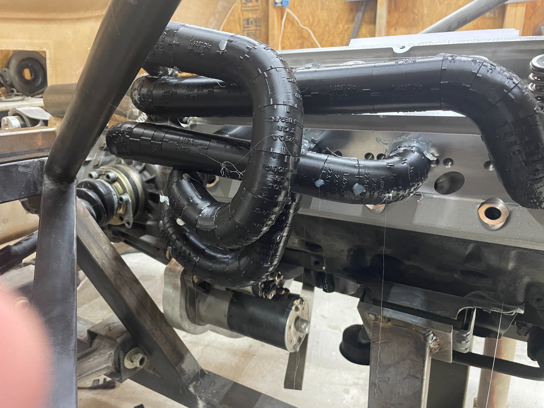

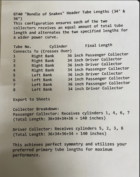

Hi there Jerry41, I am building the same thing with a 3d printer. Your Build looks awesome. I use Ai to help with my build and it says 2 things cyl 1 to passenger collector or it says cyl 1 to driver collector tube lengths, I am building the same thing with a 3d printer. Your Build looks awesome. I use Ai to help with my build and it says 2 things cyl 1 to passenger collector or it says cyl 1 to driver collector tube lengths
Hi there Jerry41, I am building the same thing with a 3d printer. Your Build looks awesome. I use Ai to help with my build and it says 2 things cyl 1 to passenger collector or it says cyl 1 to driver collector tube lengths, I am building the same thing with a 3d printer. Your Build looks awesome. I use Ai to help with my build and it says 2 things cyl 1 to passenger collector or it says cyl 1 to driver collector tube lengthsView attachment 150791
looking good...
remember to make room to be able to remove spark plugs !!!
I will do a drawing and explanation of header / exhaust layout later on today.
Jerry
layout below
looking towards the REAR of gt ( looking into collectors )
o4 o6 o3 o8
o1 o7 02 o5
numbers depict cylinder numbers
SBF
1 2 3 4
FRONT
5 6 7 8
FIRING ORDER : 1,5,4,2,6,3,7,8
The connection to the collectors allows every exhaust pulse to alternate between collectors.
also if you follow the firing order sequence you will see that there is a rotation / swirl effect.
Hope this is of use
Jerry
