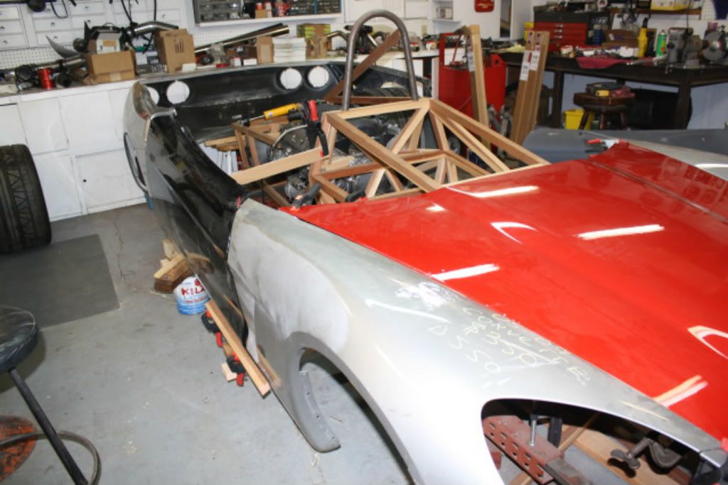

Corvette Transaxle with manual T56 trans. You can't buy this from GM, but we put this together a couple years ago. Some modification required.
You can see how long the assy is. Fits in a prototype because they use an extended bellhousing/oil tank unit. This is a mock up of project Protovette we have been working on.
Ted
Quick Racing Products
quickracingproducts.com
Ted- are you channeling your inner Morgan with that wooden frame? Looks like it could be a little bit wobbly in the twisties!
Just kidding- it looks like a fun project..and the gearbox looks just like the kind of arrangement that would work for the new LMP car.
What transmission is that mac?
It was/is built by a an outfit in Auckland, NZ. Only read articles about it, never seen one in the flesh so to speak. From picture it looks like it must either use a chain or three gear setup to get rotation correct- my guess would be the chain from a Ford Exploder 4wd, R&P from either OZ Falcon/Holden IRS diff [ possibility the R&P is from Exploder front diff ] & TreMec type trans....
But to get back to the LMP-1...IF... Fran has really planned it around the vette drivetrain, then an option might be any normal manual trans mated up directly to a Winters/Halibrand etc Quick Change, since the thing is going to have 'zip' in the way of ground clearance you might as well get the engine etc as low as possible to..
could also mount engine/transaxle on angle so that the engine is below the trans. I;'ve seen this mounting on a couple Group C cars - Aston Martin,also a Chevy Spice
Considering the RCR LMP is designed specifically for the LS Engine/Corvette transaxle setup and comes with a "Steel engine and rear suspension cradle/billet chassis plate"... Fran must have it all worked out.
I agree that build complexity will likely be lowest on the LMP (likely 1/2 the hours of an SLC). That combined with the uniquness of the car, track only application & corvette drivetrain, computer, etc... sealed the LMP deal for me :thumbsup:
