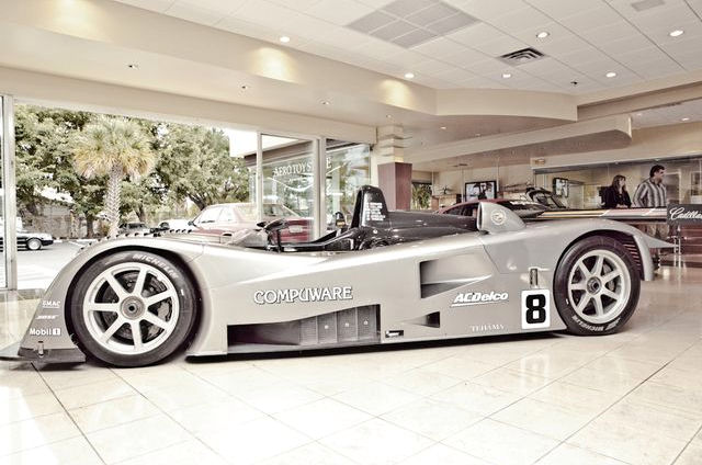

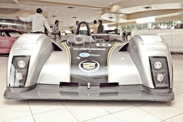

I have read enough information that indicates they are near the front wheels, with the exhaust vent behind the front wheels. I think the little scoops on top of the front body next to the wheel arches are the intakes. I also think the ducting near the rear is for the intercoolers or something as they are too small to cool engine radiators. But then the scoops I am talking about are small (although in very high pressure air) too.
All the more reason to see where the radiators really are!

I have not run across any pictures of the first car in the above post (57) showing how the radiators are positioned. Very curious, anyone have a picture of that?
Surely these were sidepod mounted, given that the chassis I have has heat damage to the carbon / resin in that area. There is also a pipe that crosses the chassis just in front of the fuel cell that would link the two radiators.
This is the version I am talking about. Now that I have found better pictures of the side I can imagine that the radiators are probably in the same location as the first iteration of the car (that one clearly had side mounted radiators). I am just fascinated by the LITTLE ducts for radiator air intake (see front shot - intakes next to wheel arches) and the similarly small exit ducts in the side of the car (the ones that are half way down the side). Or is it that the lower ducting behind the wheels pull air from under the car and feed it to the radiators? If true what are the scoops by the wheel arches for?
