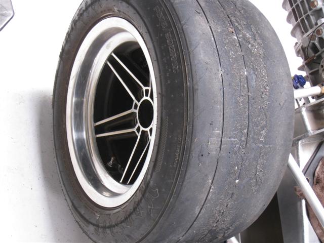

Finally found a couple of almost Lola wheels , they're 15x10 Mg (by Rebel Australia --but no longer in business:mad:) there's more out there some where

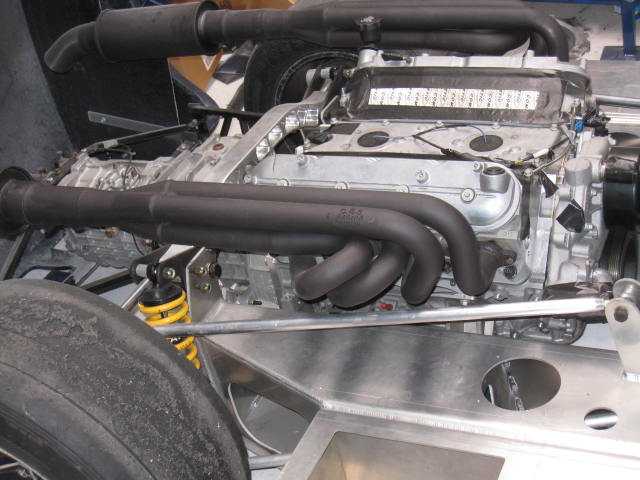

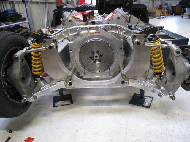

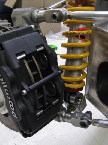

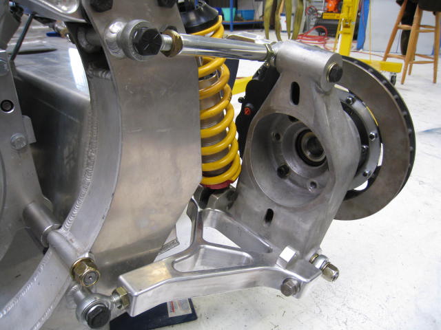

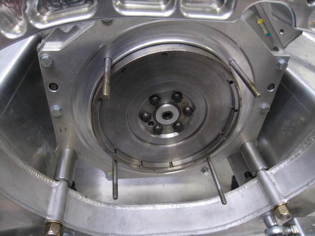

Been a while --almost forgot where me post was :embarassed: --a bit more fiddleing --but it is progress. It's a roller, now to fit the rear clip --and its off to the plumbing shop for some exhaust pipes --$$$$

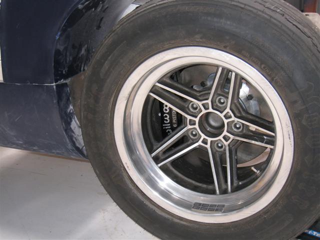

Hey Chris,
The wheels look great, do you know much about the offset and so on? I'll need to replace my knock ons with some bolt ons and am interested in what will fit up. Did you make your own half shafts for what looks like a 930?
Ron
flatchat(Chris)

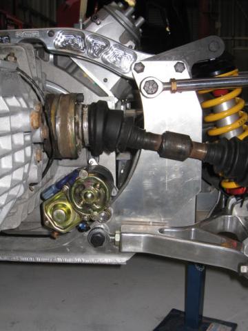

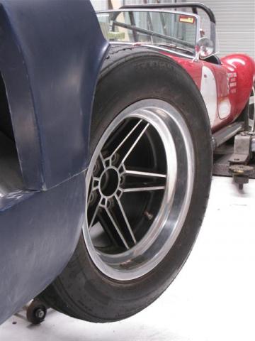

Ron , the wheels are 15"dia. x 10"& 8" bolt up face is about central--bolt PCD just happens to be 4.75" (corvette) --they were a locally (Aust) made item from the '70s thru to late '90s --now suddenly they've become rare ?
The CV shafts are a common GM product that I have shortened :idea:--not sure if its gonna work yet

They are not RCR......
Chris chose some wheels that were not suited to the stock RCR suspension...and as he is pals with DRB. and makes parts for them he was able to modify things and use them to allow wheel fitment/clearance.

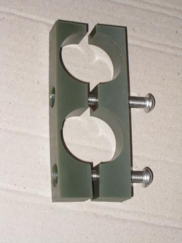

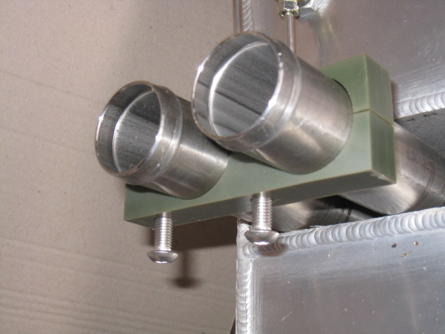

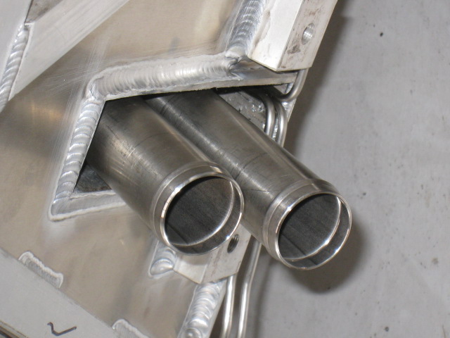

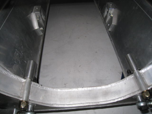

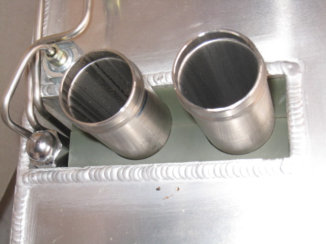

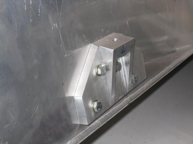

After a bit of thought and a lot of procrastination, finally came up with this clamp / support for the tunnel coolant pipes (1 1/2" dia stainless )
