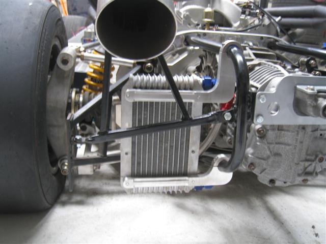

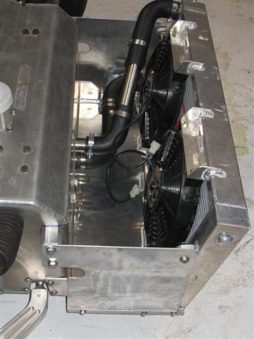

Just waiting for the compressed smoke to ignition :blank:

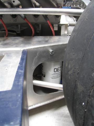

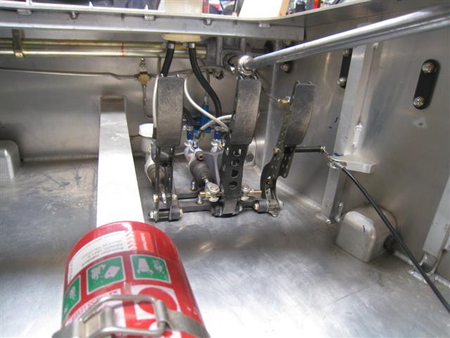

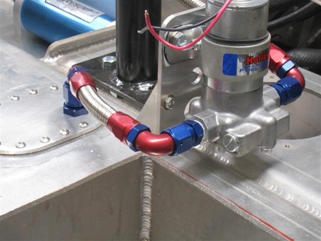

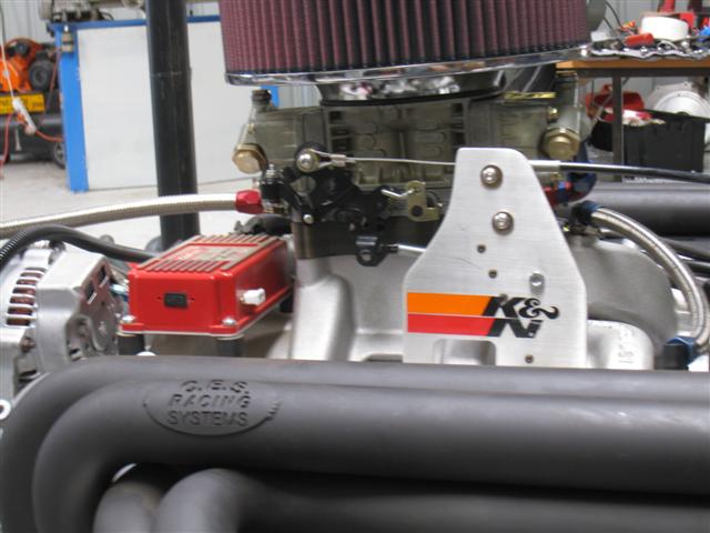

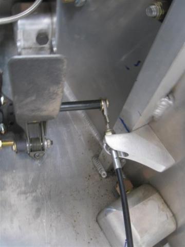

flatchat(Chris)
Bit apprehensive --at first--about the exhilerater mechanism --but it seems to work really well :stunned:

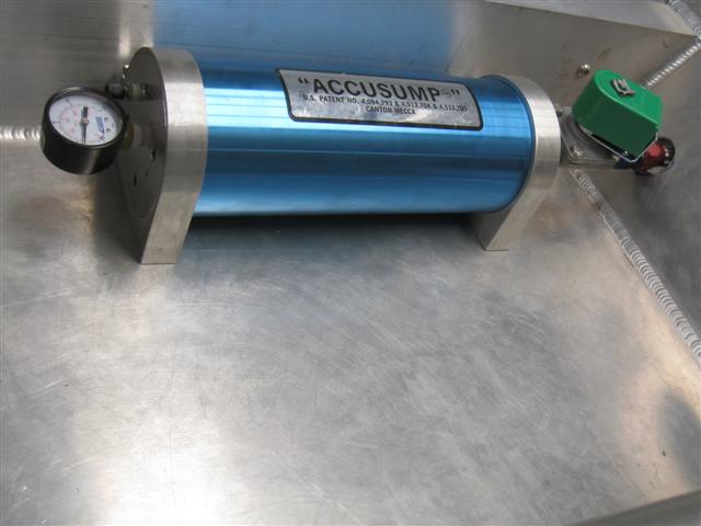

flatchat(Chris)
Woo hoo! she's wired and fired -- primed the oil system ,fuel pump on , activate the squirters , ignition on- hit the start button --three turns and she's alive -no sweat
At the moment, its one RCR Go Kart next is a little road shake down then the body fitted and painted --then new tyres and voila :thumbsup:

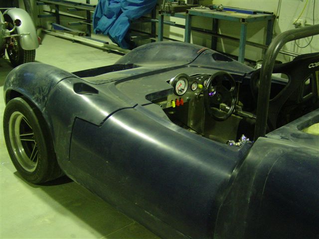

So,-- had a quick drive around the block today --weighed in at 890 Kg --(I weigh 95kg) with 20L fuel , 8L oil, 12L water --aaand no body.
Brakes (willwood) excellant, clutch (930 trans ) very good, Gears through a single rod shifter 1,2,3,4 easy --reverse, a fair bitch . Steering too slow and lock to lock -poor.
So far, it gives the sensation of a fun car to drive and really wants (would like) to get up and boogie :thumbsup:
On to the body fitment................

Ron - Yes sir - a hebby chebby Ls6 --nothing special , CNC heads, Holley 650 race carb, Edelbrock dual plane intake msd ign. kit, std coil packs --about 450 hp when run in and tuned

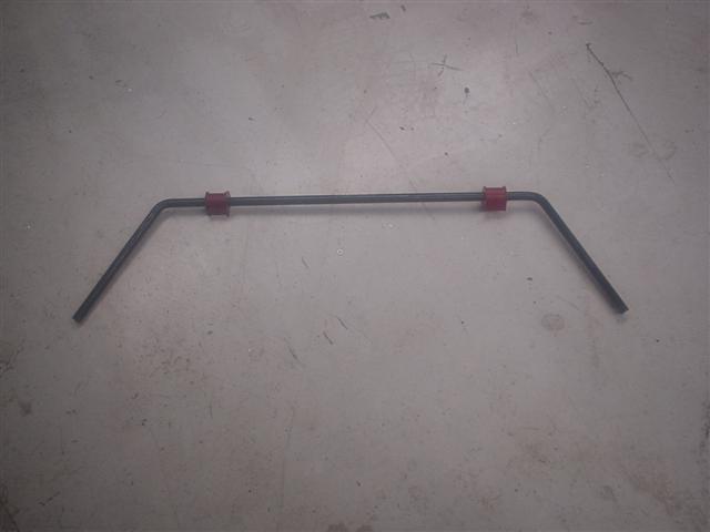

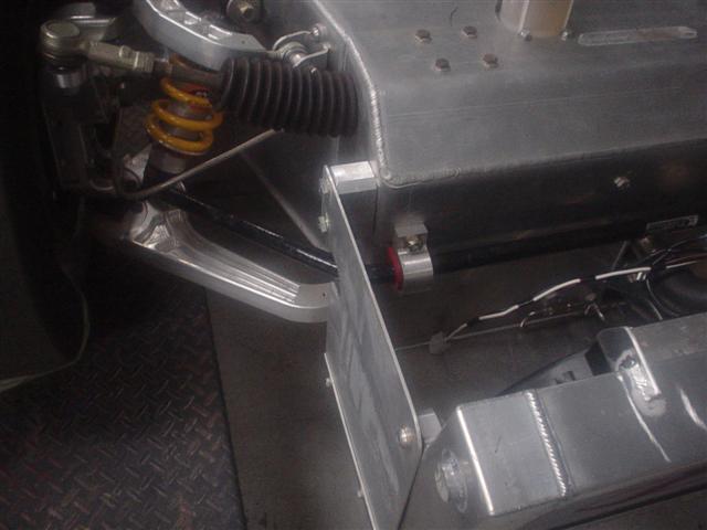

Anti sway bars 22mm dia front and 16mm dia rear for a start --I'll post a better pic when they're finally fitted

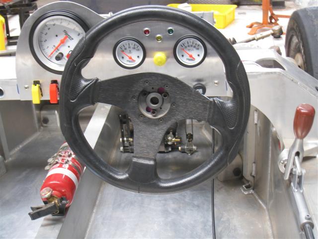

The instruments -- One BIG tacho with shift light , oil press. and water temp, the rest are little lights that come on if someting isn't working --then, all I have to do is remember what they were for :idea:
Do you like the wheels Stevo ??
