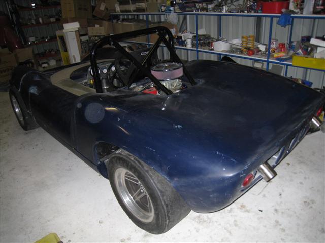

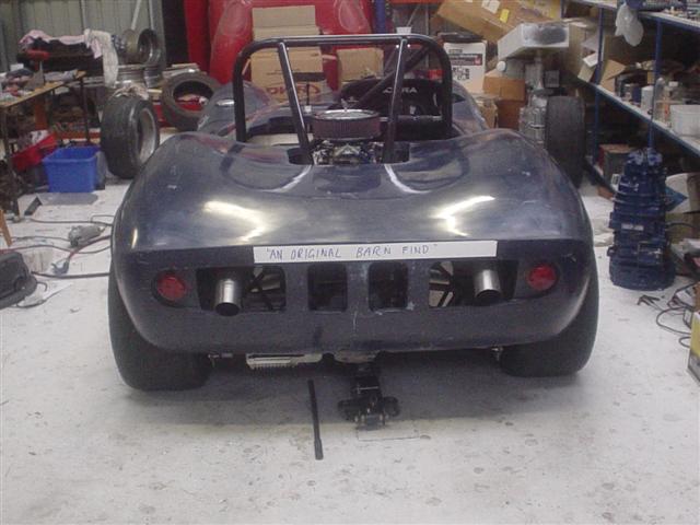

Getting closer --- seem to spend all weekend just to do up two bolts :cry:
Funny looking thing ain't it

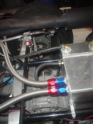

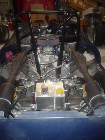

Button down a few more things - ready for track attack on wednesday-shake down time

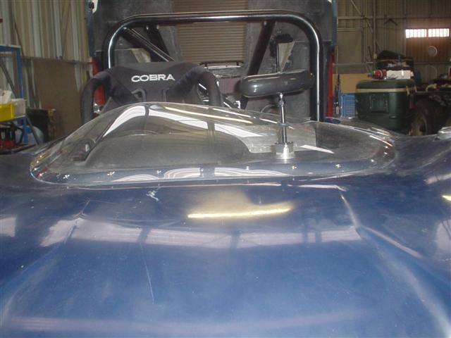

The weather forecast says rain all day on practice day and it did ---- except for nearly 15 minutes where we snuck in a couple of maiden laps --on to the track first lap and promptly did a 360° on turn 2 then turn 3 likewise at turn 4 also turn 5 --so much for hard bald tyres in the wet --kind of embarrassing but fun --then discovered instruments not functioning --replace fuse, wriggle some wires and all is good for the mo. Engine not 100% happy, carb not tuned properly yet --couple more tentative laps, call it quits and by this time its fairly bucketing down --so much for the christening.
Although not properly tested, the brakes seem to be very good, clutch and gear changing all good -(once the mind acknowledged the right hand shifter) Ratios seem to be OK --will know more about that when we're able to drive "flat out !"
Driving in reverse is impossible without side mirrors.

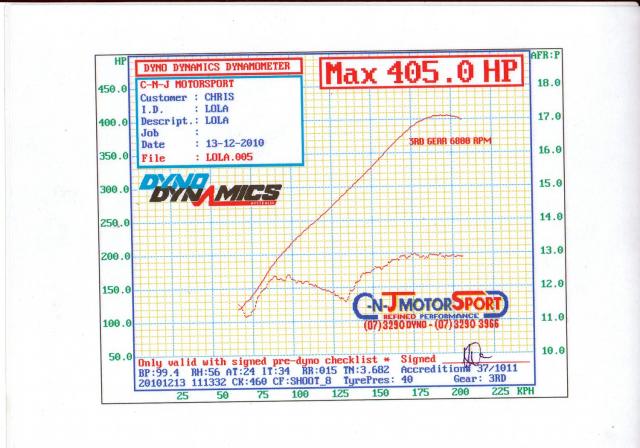

~= 300 Killer Wasps! -- not too bad for an old school carb'd Chebby (LS6)
outa the box .

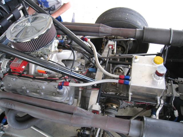

According to the dyno, thats 405 hp at the wheels in 3rd gear doing 200kph at 6800 rpm with wheel spin --apparently -- I think we need bigger, fattier, stickier rubber already and a younger driver (Aye Russ)
Any way, can't wait till we get some track time -- to see how this thing is going to "handle" ?
So yeah, Fran you were pretty close with 500 hp and you'll be pleased to know that the cockpit tub holds about 200 litres of water -- because of a torrential down pour during the home run from the tuners:furious:

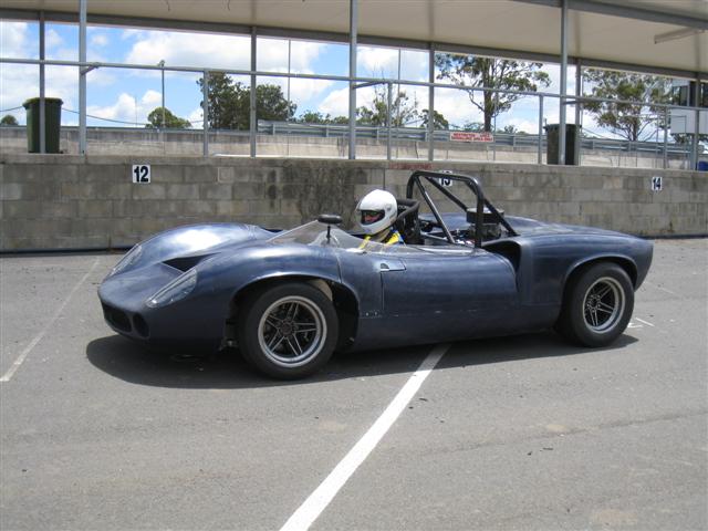

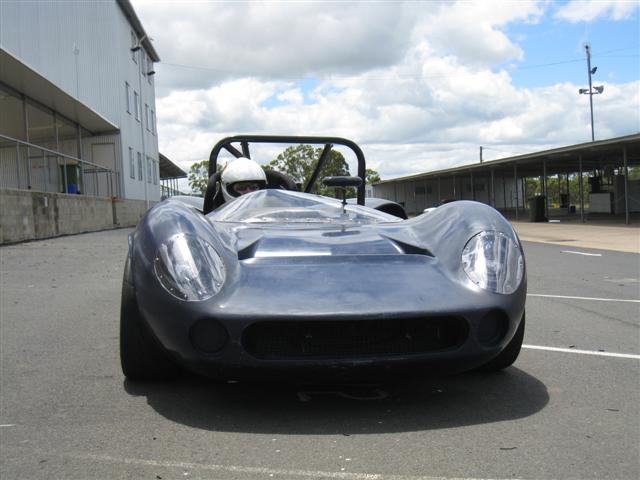

I pulled a sickie from work and did some track time ---- outa the box its pretty well on the money -awesome! That Chevy LS6 and 930 4 speed seems to be a great combo. It points and turns great . Excellent stoppers.
Sounds awesome. Could be a load of fun boys.
Things to do:- (apart from paint or polish) corner weights, side mirror, check alignment of the rear, (over steers a bit) fiddle with shocker settings etc ,grease the front ball joints "properly this time" -- other than that absolutely no issues:D:thumbsup: -- happy as......

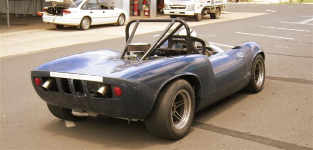

The roll bar looks tall --thats to meet the requirement over here and I'm sitting on the floor

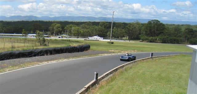

After about four and a half years --- Finally hits the tarmac...........
A bit lonely out there with no one to chase -- er, I mean leed.
