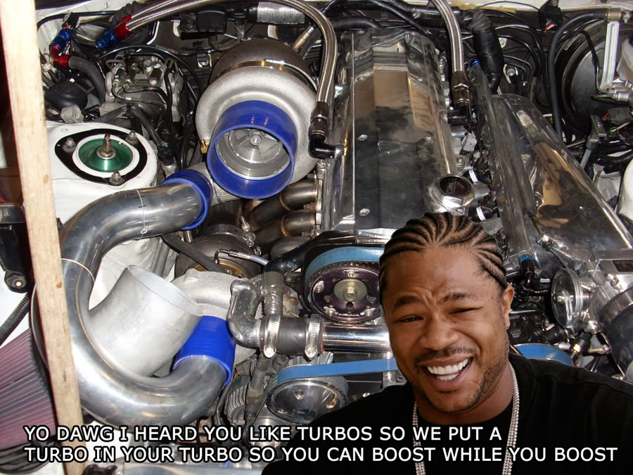

There are/were several 2jz setups with this or similar.
Marc's 2JZ Turbo Compound Setup - YouTube

I have heard of the 2JZ swap, but this is the only picture I could find of it:
This one also has "NAS". I think that is something like NOS, but I can't be sure from the picture.

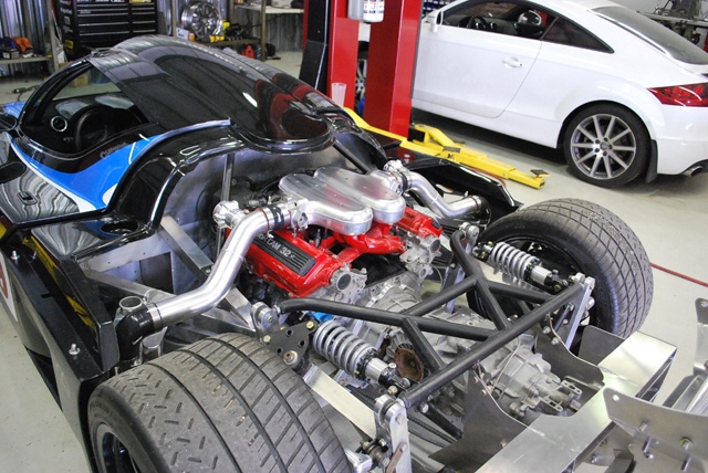

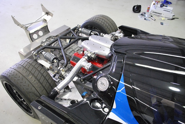

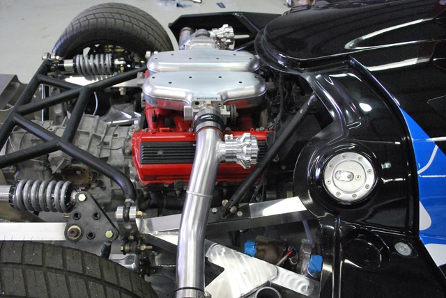

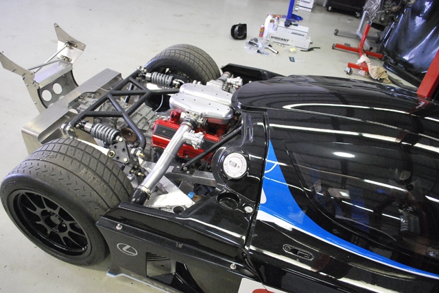

I have some pictures from Toby's SL-C which I ran accross from a while back. That is all the info I have. His website is Campbell Race Concepts Inc - Race Cars, GT 40's - Burlington, Ontario, Canada, but does not look to have any newer pictures.
