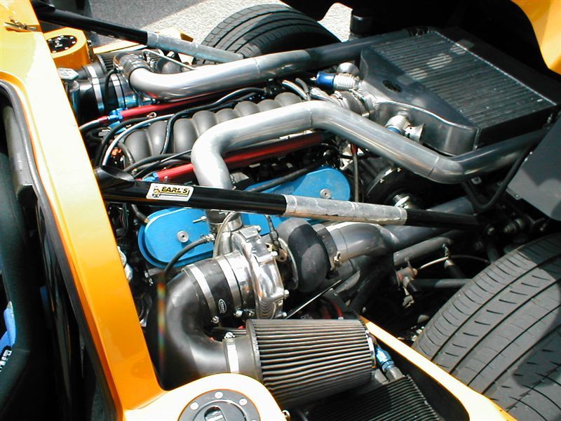

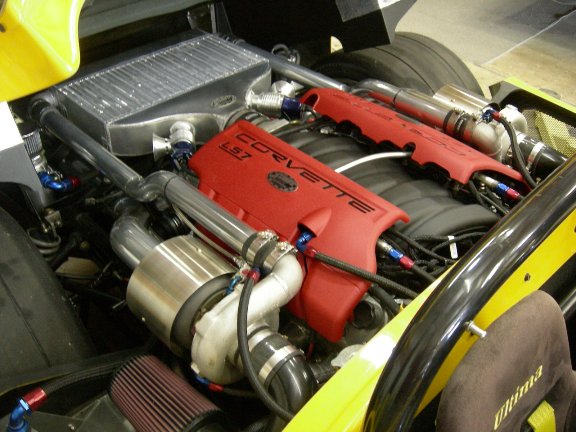

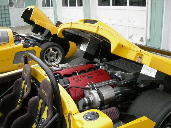

While it is not an SL-C, Jeff Schwartz put together a TT LS2 and a TT LS-7 in a pair of Ultimas.

Notice the "hot air intake" next to another radiator/cooler. Drawing the intake air from a sealed box with access only to outside air is normally a better practice. I wonder what the air temps were before and after the intercooler (which also doesn't look like it is mounted in the most effective position, either).
I'm sure that Jeff's implementation was limited by the space constraints in the Ultimas, but for those building an SLC, there are more options for packaging, especially for cars with the street tail. Twin intercoolers are easily mounted on the sides, and there is plenty of room for turbos there as well. For a good example of this, see Toby's Lexus TT engine compartment which has side-mounted intercoolers, and optimal hot- and cold-side plumbing design.
The Ultima setups from Schwartz were supposed to generate over 1000 HP, so even with the obvious compromises, they still made real power.
