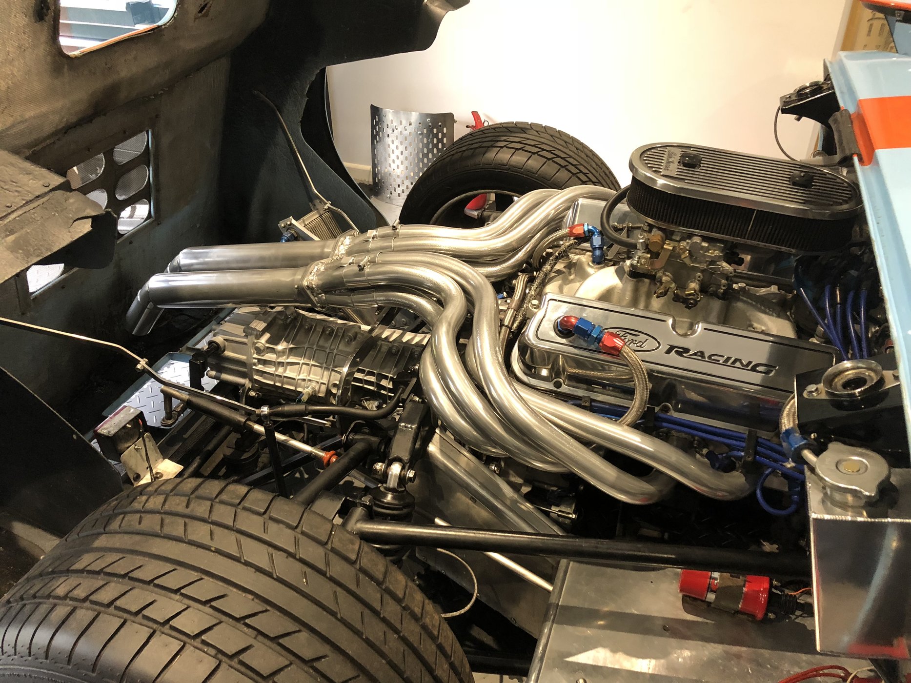

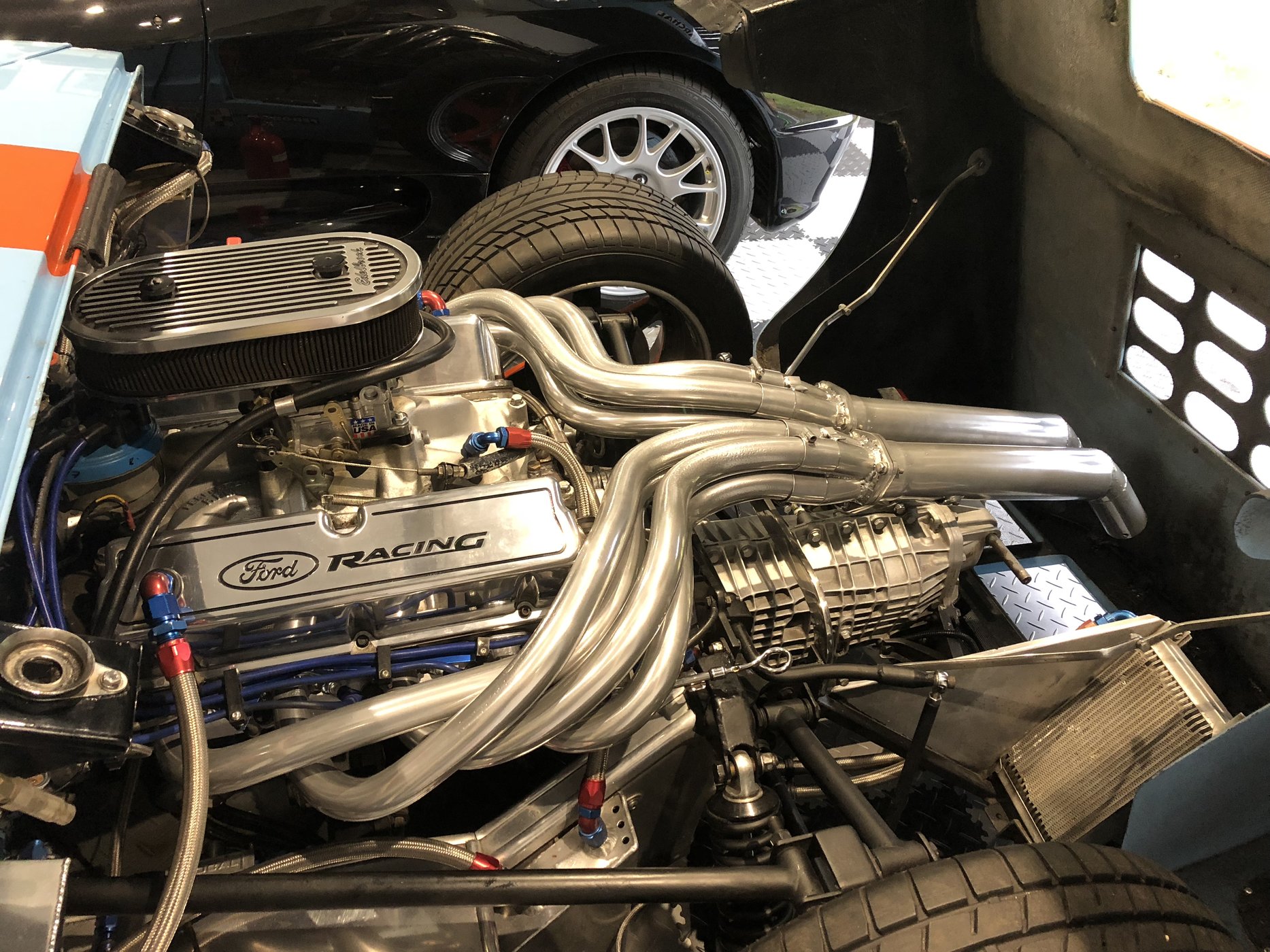

Finally getting round to posting some photos now I’ve had some time to do some work on the car.
After an ‘interesting’ purchasing experience I’ve now started on the increasingly long list of items to work on with my car. It’s a GTD which has spent a few years being unloved....that’s all changing as of now.
Got the headers and collectors back from Camcoat, detailed the engine, new header gaskets/bolts and pleased with initial progress.
It’s now had new clutch/release bearings, new AC, new alternator, new coil, new windows.
Interia just about to get redone, bodywork detailed and some paint correction, and then it’s off to Geoff Taylor to get some mechanical work.
Loving owning a GT40
