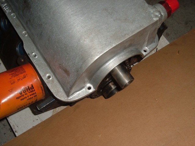

Pic #1
Note the clearance around the rear cap, zero on the LHS about 3mm on the RHS. Besides that the sump face is out of round. Not sure how it's meant to keep the oil in.........?

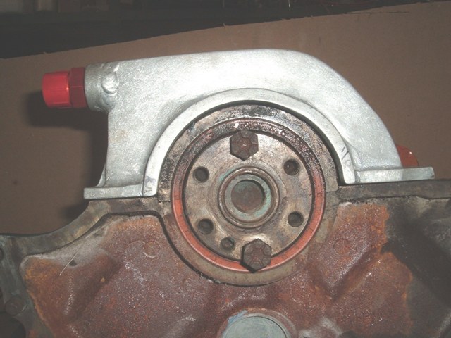

Pic #2
There is a further problem at the rear of this sump. No room for attachment bolts at the rear of the sump adjacent to the cap.

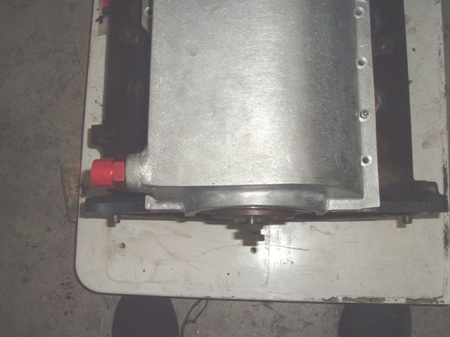

Pic #3
No room for bolts at the front corners of the sump either due to the squared off edges.
Maybe it's not necessary to use all the bolts, but I would certainly prefer to.

I didn't try to get a response from ARE. The logistics of returning a sump from half way round the world make the exercise self defeating. Also I believe ARE knew this was a faulty unit and took the opportunity to unload it to the other side of the world.
The photos are of the sump exactly as it arrived. Note in Pic #1 that someone has written 1/8 on the face where the 3mm gap is. 3mm = one eighth inch! The coincidence and placement is telling.....I'm sure 1/8 refers to the gap. They knew alright. Chances therefore of a refund are pretty dim since they appear to have deliberately stitched me up.

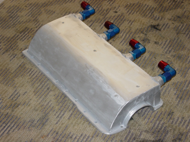

I got a sump from them, it was a custom 4 pickup that was cast a little deeper to accommodate my 401 ci Windsor. It fits like a glove, sorry to here of your problem, it took them like twice as long as they said but when it got here I was happy. I sanded and sanded and sanded, to get it smooth enough to polish though. Here is a picture of the unit.

I think that just proves my point. TX is not that far from CA. You got a good one. NZ is on the otherside of the world.
