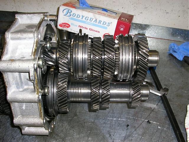

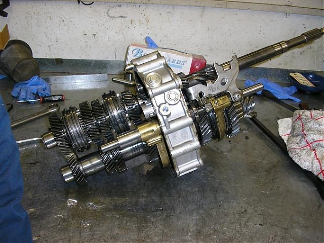

Tom,
I don't think mine is a 2.7, but the code is FYA. The ratios that I have been told work out pretty good. The people eho stripped mine down said it was as substantial if not a bit more than the 016 that people have used in other 40s.
Brett

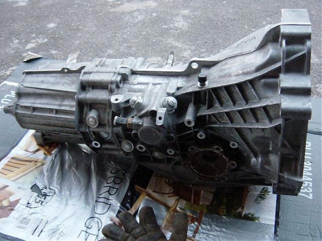

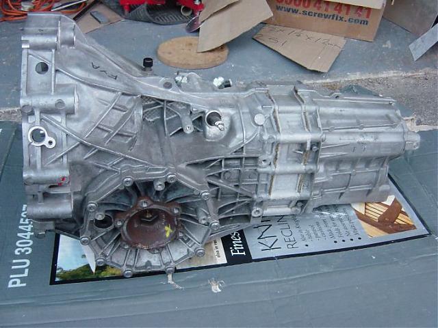

Here is pic of the 01X outside
According to the powers that be it was used on a 2003 A4 TDi and had these ratios
Final drive​
32 : 9 = 3.556​
1st gear​
33 : 9 = 3.667​
2nd gear​
39 : 19 = 2.053​
3rd gear​
37 : 27 = 1.370​
4th gear​
32 : 31 = 1.032​
5th gear​
28 : 35 = 0.800​
6th gear​
25 : 38 = 0.658​
Reverse gear​
34 : 10 = 3.400​
