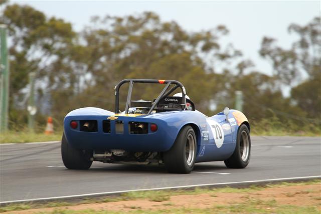

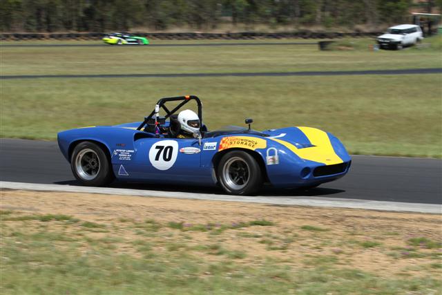

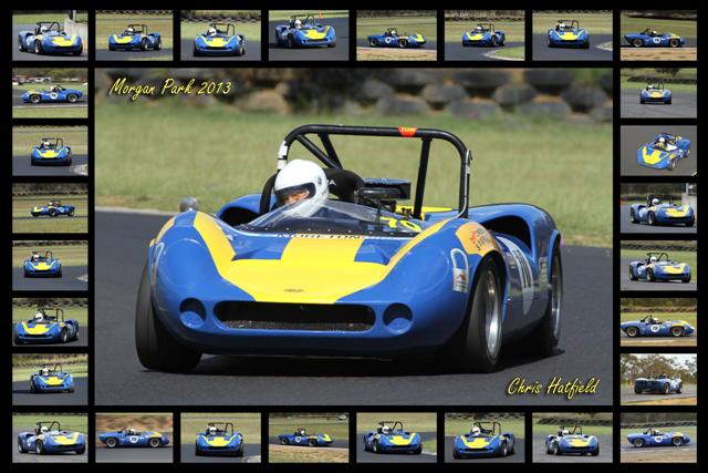

Some pics from a pro
Brakes are still giving grief - pad choice maybe ??

Do your calipers have anti knockback springs installed in them? Some of the AP calipers come with them. They are come in 4lbs or 7 lbs. Most Nascar teams use them on road courses. Also the V-8 super car calipers have them also I believe. It may be the discs are distorting at high temps looks to me like they bolt solid from the photo. Most upper level discs are floating design to allow the disc to expand without distortion from the hat.

We had exactly the same setup as you down to the fluid and residual valves.
Except when looking at your pictures we had one big difference.
We had the area for the "fog lights" cut out and funneled to a hard molded duct that blew air in the center of the rotor. Even without that we always had that area cut out and it naturally allows air to the rotor. I think if you make this change you'll be fine. No way I'd consider running a track car without brake cooling.
