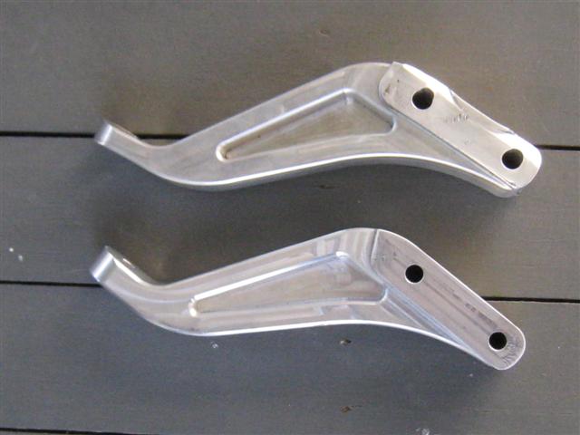

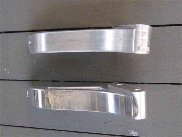

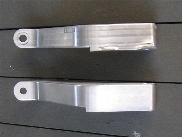

New and damaged RH steering arm

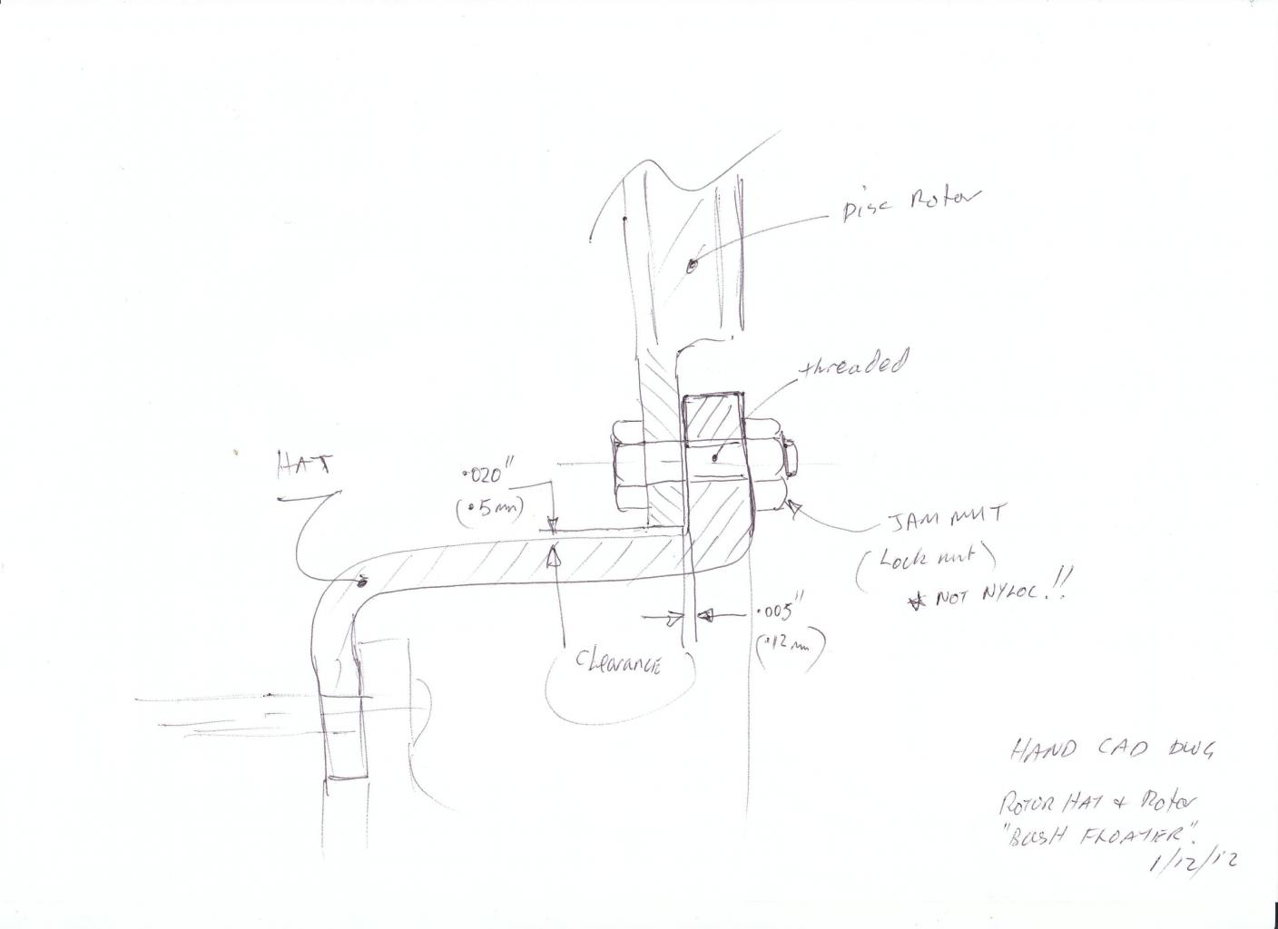

Glad to hear you "got her goin!" Do you have a pic of the DIY floating rotor/hat combo for the rest of us RCR improvers?? Thanks, Scott

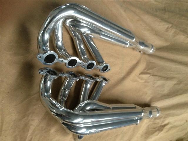

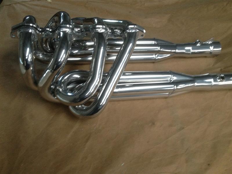

While the body was off for paint -- decided to clean up the exhaust pipes a bit
