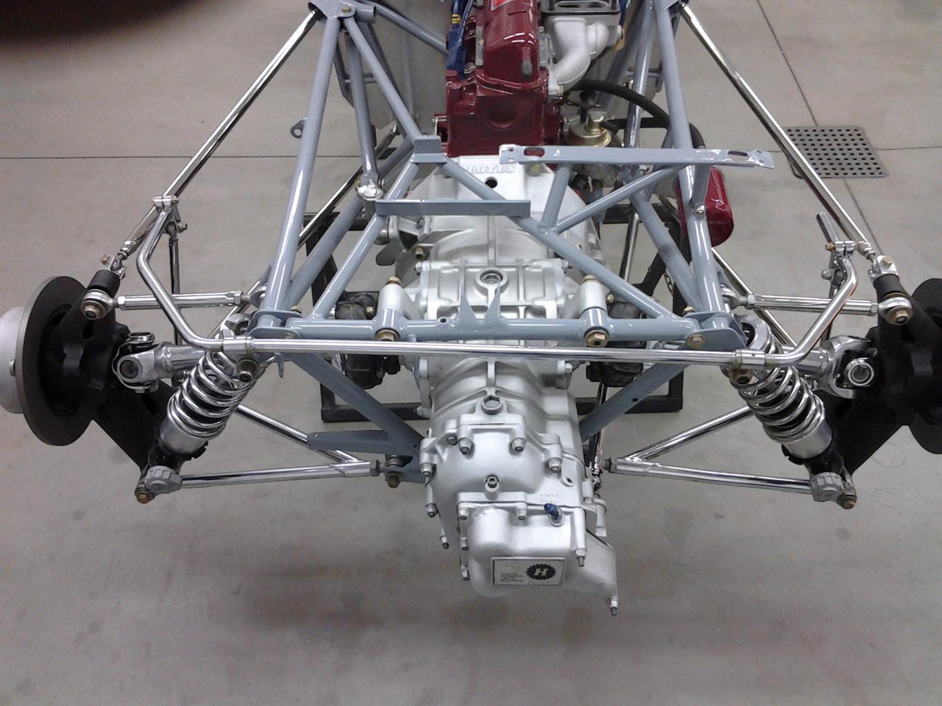

I am finishing the restoration of a Lotus 61 FF. I have tried walnut shells, plastic media and silica in past projects and found that glass beads do a superior job.
Like the others have mentioned, if the case is not completely apart and bare, it is imperative that you seal any possible openings. And a side benefit of glass is very little dust and a two second cleanup with a blast of air.

Thanks very much for your input, from most of the research I've done it appears that glass beads have been the method with the most positive results but hearing first hand results is more assuring.

Gordy, this is a nice looking result you achieved, can you share with me what you used to protect openings (if you had to) as well as which grit and PSI used?

80-120 grit glass beads and at least 65PSI will do the job if you go that way.

I use 100 grit beads and 80 PSI, although you can go a little higher PSI without problem.
You can also vary the amount of shine by how long you blast an area and how close to the surface.
I clean around any possible opening with brake clean and fine steel wool, which in and of itself shines up the aluminum nicely. I then use Gorilla tape to seal any area I don't want to blast, sometimes using two layers. The stuff is tuff!
For the most part there are not many openings on a transaxle, and I don't direct any spray at the inside of the bellhousing or input shaft area, even though I tape them up carefully. Just check any vents or seals that may be exposed and cover or plug them.
