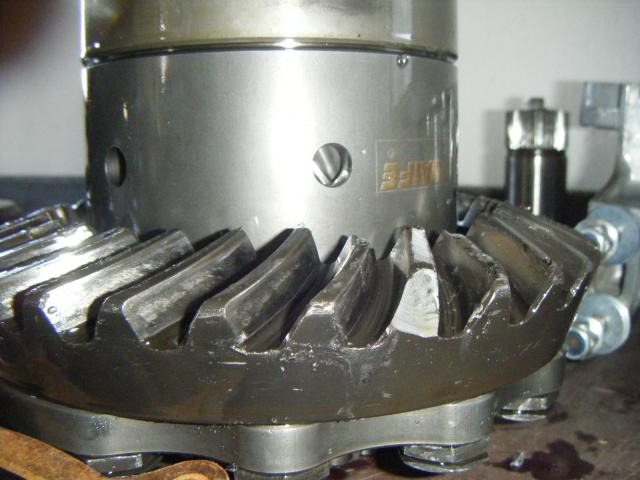

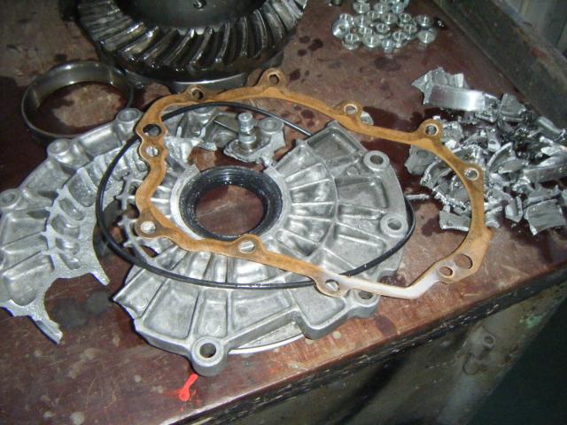

Invest in the billet sideplate! Here are some photos of what can happen (LS7 powered example I found on the web)
SOME DEBRIS(BROKEN NEEDLE BEARING OR THE LIKE)CAN HAVE THE SAME EFECT.THE CASING IS SPLIT.THE REASON COULD BE SOME DEBRIS BETWEEN RING AND PIGNON.IF THE SIDEPLATE CAN WITHSTAND THIS FORCE SOMETHING ELSE HAS TO BREAK.:furious:
