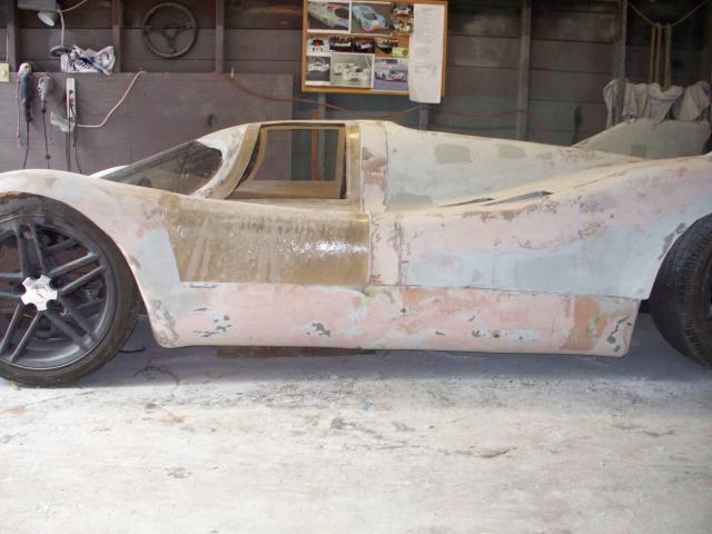

Hi Jack.......thanks for the photos they explain a lot, couple more question's. I see you then covered the mesh with what appears to be blue tape or plastic film wrap, is this to keep the glass seperate from the frame and so the frame gets removed when the glass has cured?? Also in an early photo I see your transaxle has the diff behind the Trans, I'm guessing with the 917 the wheel base is long enough to do this when your engine is shorter than the original flat 12. Is your wheel base close or are you slighty longer and is it a 928 trans or some thing else. This a fasinating build and you are doing amazing work. Cheers Leonmac
Hi Guys,
The blue plastic film was for a bond break from the mesh. It worked great!

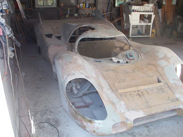

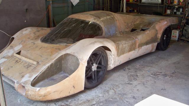

In a few days I will show you what I've been up to. Every time I look at the car I don't see a 917. I looked at every part of the car and compared it to photos and the 1:18 scale cars I'm using for scale and everything matches but I still couldn't see the 917. Then I realized the extra 3" in height were distroying the overall design. So I cut off the roof and chopped up the roll bar, and tilted it back like the real cars, and put it back together with a height of 37-1/4".
NOW IT LOOKS LIKE A FRIGGIN 917!!! I should be able to send some new photos in a couple of days.

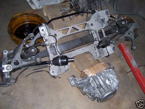

To answer your earlier question about wheelbase, I had to increase it by 11" because that diff is so far back. I stuffed the engine as far forward as I could and heavily modified the rear subframe to gain 2" more. I made the side pods 5" longer and left a 6" gap between the tire and the pod. With everything being black, it shouldn't be too noticable.
The transaxle is from the Cadillac XLR also. It is an automatic/manual so with a blip of the throttle here and there it will sound enough like a standard for me.

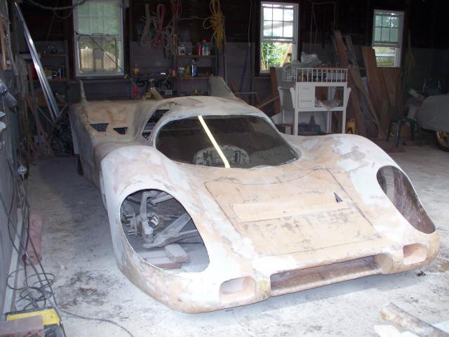

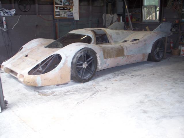

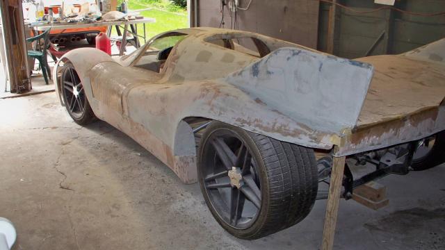

I've been working flat out on modifying the body to make it more accurate. I'm really getting tired of body filler and sanding. :evil: The car is now 37" off the ground with a 4" ride height.
Today I'm going to add two air scoops at the end of the buttresses, as seen on the #25 Long Tail, to break up the vast expance of the rear fenders. I can always use more air to cool the all aluminum engine. Actually, I'll probably need a transmission cooler. :huh: $$$
I finally got the headlight cut outs as close as they're going to be. Forgive me, but I'm going to install a set of XLR headlights under a tinted lens cover as I had already bought them when I had planned on building a Cadillac LMP car. The way I built this body makes it tuff to get things to match from side to side. In fact, because I don't have the coilovers and steering in yet, I have never been able to step back and see the right side of the car. I hope that's not a shocker when I can!!

I'm using a 2004 Cadillac XLR engine and transaxle with only 2,400 miles on them. I designed an adapter and had it machined which I hope will work. The body is off the car now so I can start the chassis detailing as well as finish the body.

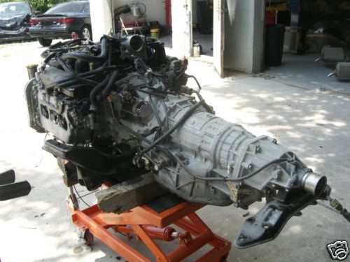

I'm still figuring everything out but it will be two late model Subaru 6cyl, 3.0L engines joined at the crank with a piece I designed. Both engines will be bolted firmly to the chassis with other braces to make the engines one.
So far, I'm planning to run both engines off of one computer with the firing sequences perfectly aligned. I'm hoping a signal to cylinder #1 will fire off both #1"s. Keep in mind I'm not an auto mechanic and I'm only using common sence. I do have a Suburu service department and lead mechanic enthusiastically helping me so we should figure something out.
