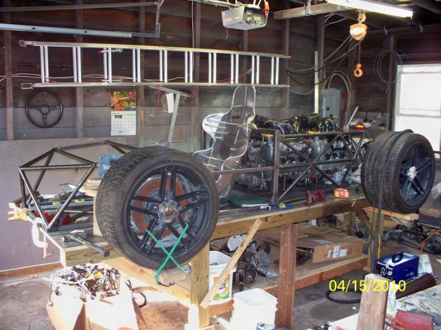

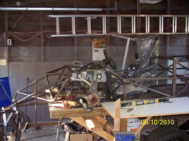

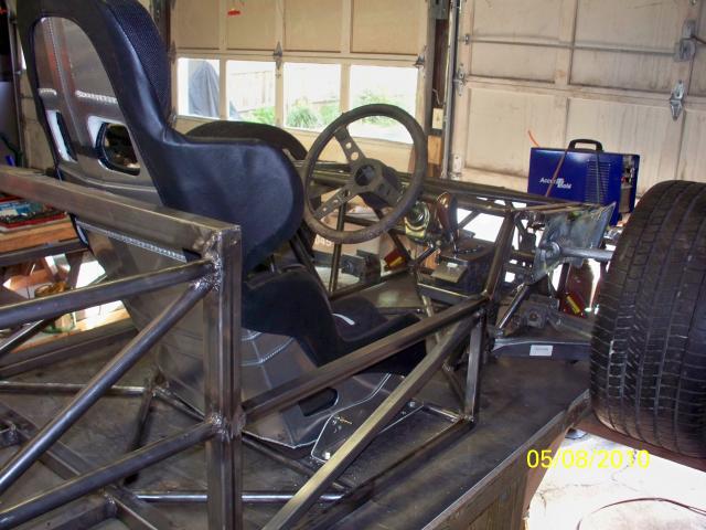

I'm attaching some photos of my STP 917 as it is coming along nicely.
Jack

I'm still figuring everything out but it will be two late model Subaru 6cyl, 3.0L engines joined at the crank with a piece I designed. Both engines will be bolted firmly to the chassis with other braces to make the engines one.
So far, I'm planning to run both engines off of one computer with the firing sequences perfectly aligned.[[[[[
I'm hoping a signal to cylinder #1 will fire off both #1"s.]]]]
Keep in mind I'm not an auto mechanic and I'm only using common sence. I do have a Suburu service department and lead mechanic enthusiastically helping me so we should figure something out.
Jack

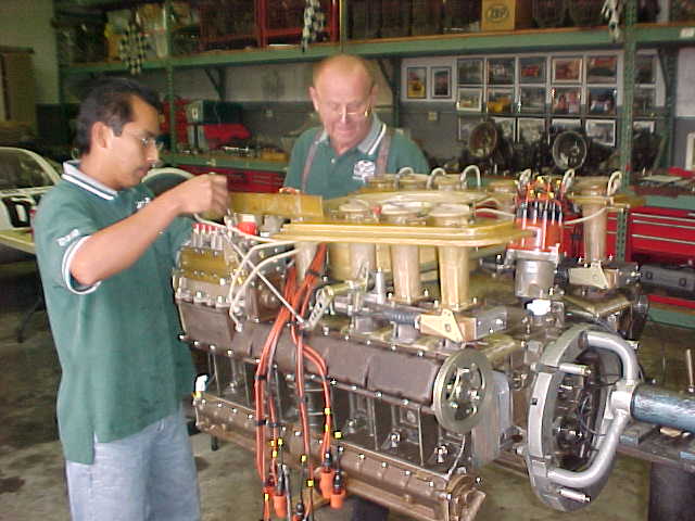

I thought the center drive take-off in a 917 engine is for the fan drive. The clutch and crank flange are still at the back of the engine.

Jac,
Nope,
not only for the fan
there was a center drive take off going to an intemediate shaft running to the back of the engine
THe flywheel center was offset in relation to the crank center
TOM
This build is very cool, and I like the idea for using two subaru engines. I see that your using the corvette suspension, do you mind if I ask where you found the suspension attachment points?
This is a link to a program you can try for free. Its called suspension analyzer 2.0. In the program they have the suspension pickup points for a c5 corvette. They are measured in an X,Y,Z coordinate pattern. Dont remember which ones are which but if you have a very basic cad program you can map the suspension pickup points. They are measured inches from centerline. Height above ground plane, and inches forward or aft of axle centerline, ie X,Y,Z. Hope this helps
Suspension Analyzer
I will be firing the #1 cylinder in the rear engine and the #6 cylinder in the front engine at the same time, and so on, so that a cylinder will fire on opposite sides on each engine. I don't think you can fire one cylinder at a time between the engines, like a 12 cylinder engine, without having two cylinders firing on one side, one after the other, and then two on the other side.
I have a C6 Corvette so I took the measurements off my car. I guess it would have been cheaper to buy a CD! :sad: I have a vintage auto and race car restorer in CT that also runs a vintage racing shop who will do the final suspension set up.
I have a Subaru tuner in CT. that will do the computer, wiring and exhaust work work.
The car will be used for track days and hillclimbs, probably driven by an old fart like me, so hopefully there won't be too much strain on the drive train. There is some flexibility in my adapter as I have used a second drive/flex plate mounted face to face to transfer the front engine's drive to the rear engine.
This car will be on YouTube shortly, as soon as I paint the chassis, (Porsche 917/10 Replica), and at Lime Rock on the first weekend of September for their vintage festival and then it will be auctioned off on e-Bay.
This will be the only 917/10 I will build. (when Fran says a tube frame chassis is expensive to build, BELIEVE HIM!) My next project will be a Brabham BT 44B which I will also sell. I am building and selling my dream cars.
