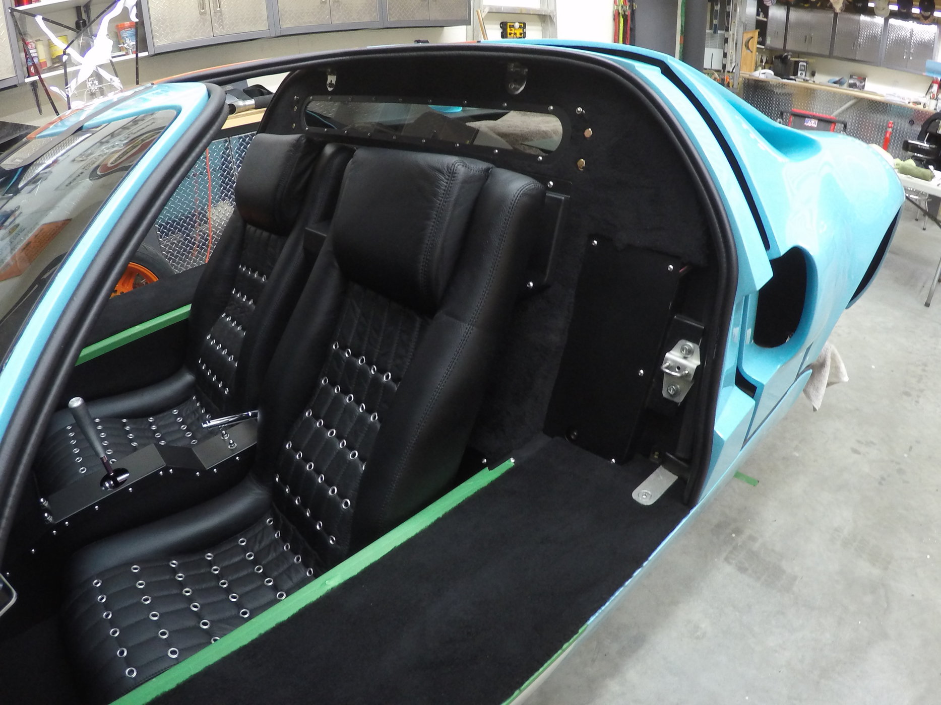

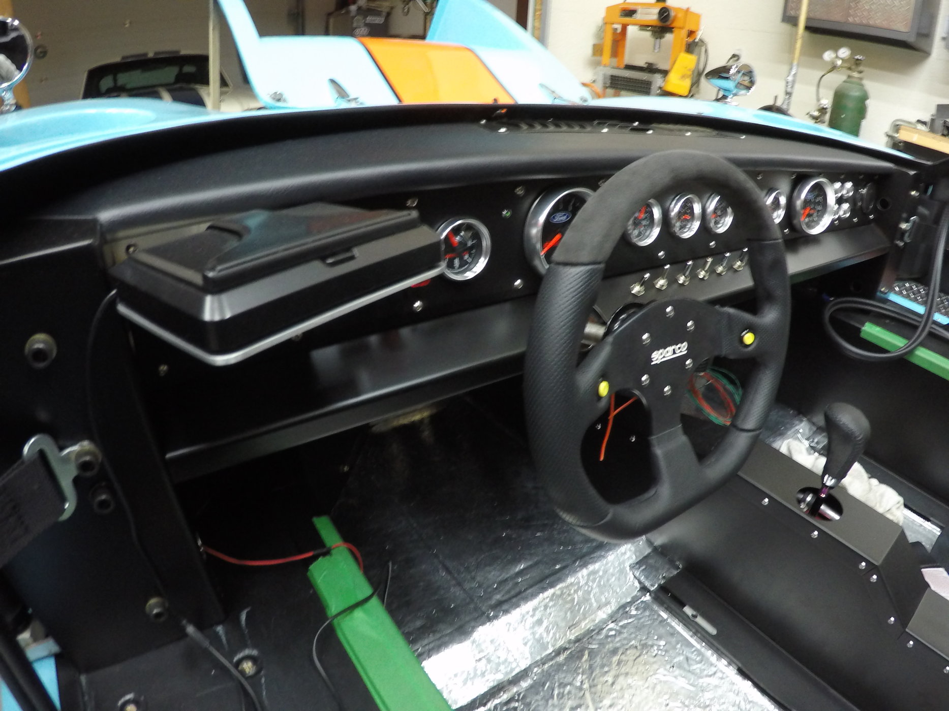

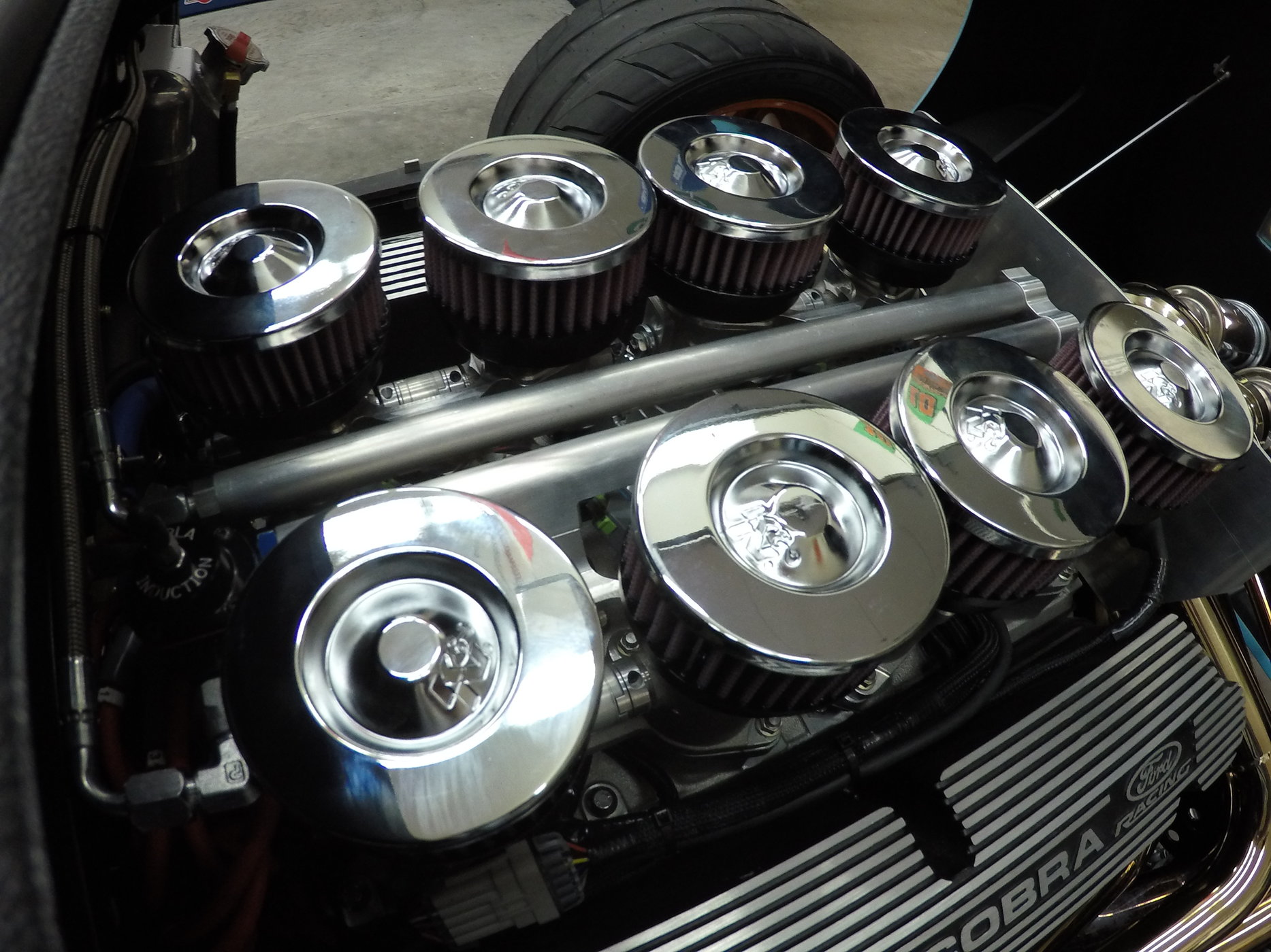

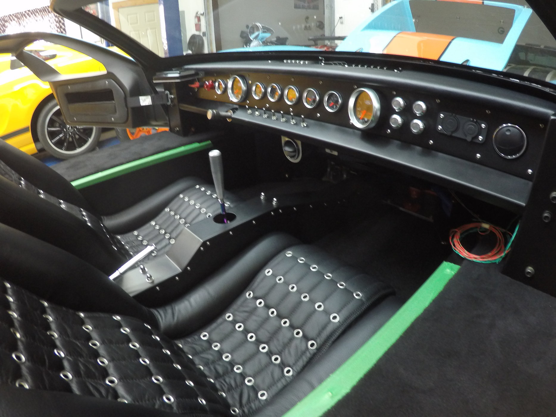

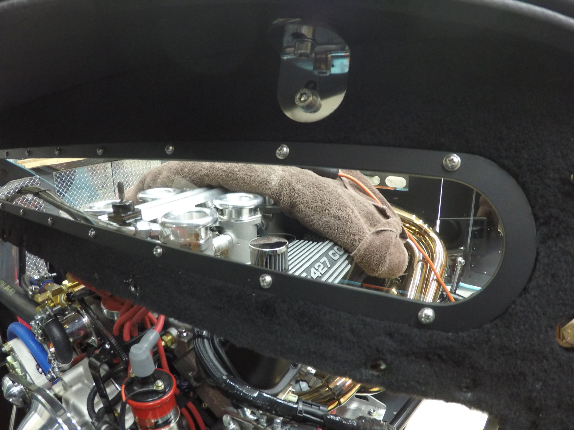

Up date time. The to do list is short, nostril struts should be here soon, windows are in but need trim, air filters are on. I bit the bullet and got the K&Ns from Borla. Road testing was good other than a bog at light throttle and a hint of anti freeze in the air, haven't found the leak yet. I had the carpet fitted. the guy did such a poor job and I put it in the trash and did my own. I fitted the fire wall glass with two ally frames and made a foam and glass sandwich. I'm about to order an emblem from Rick for the home made shifter, just by chance the cut on top is 3/4 inch.

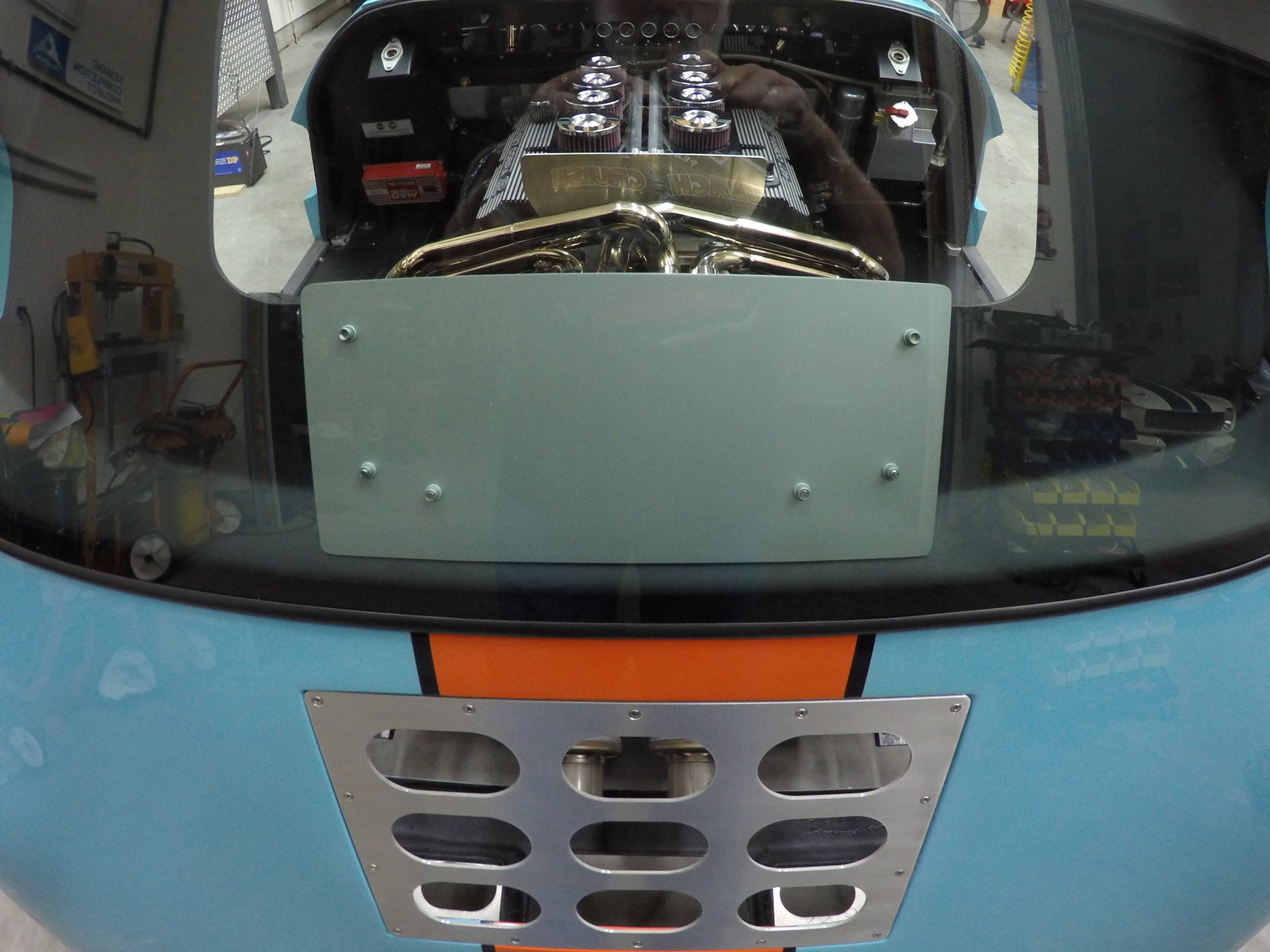

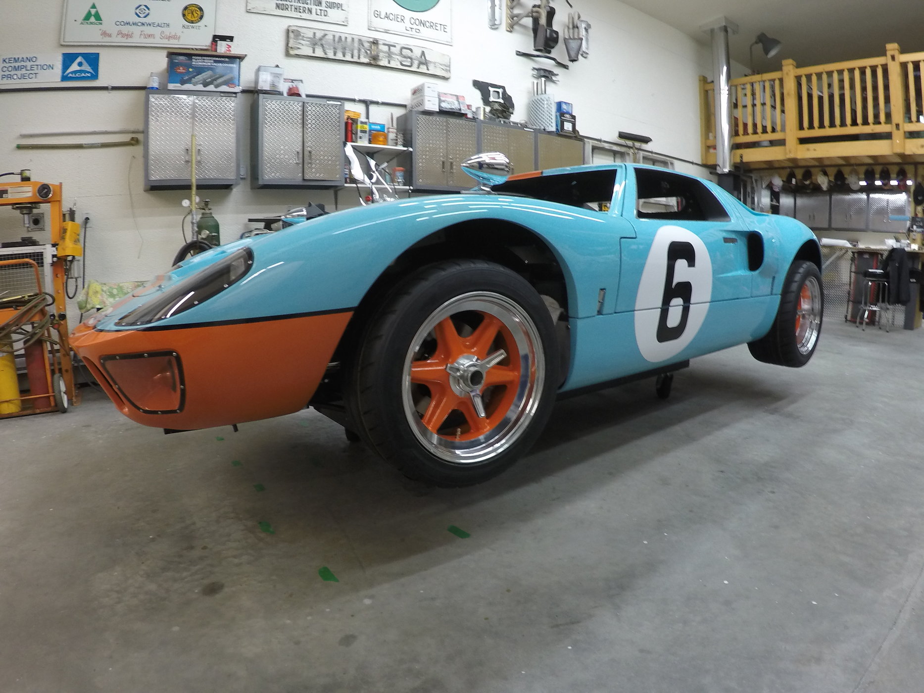

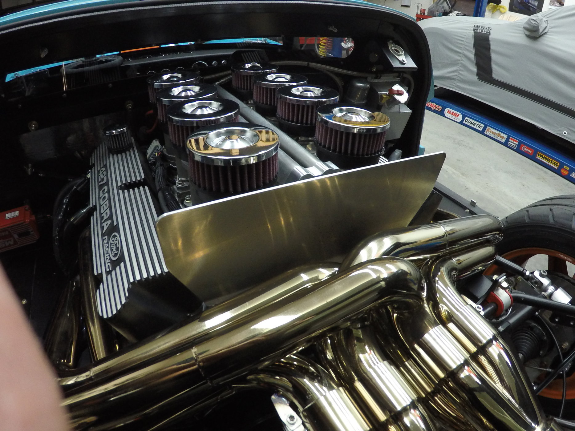

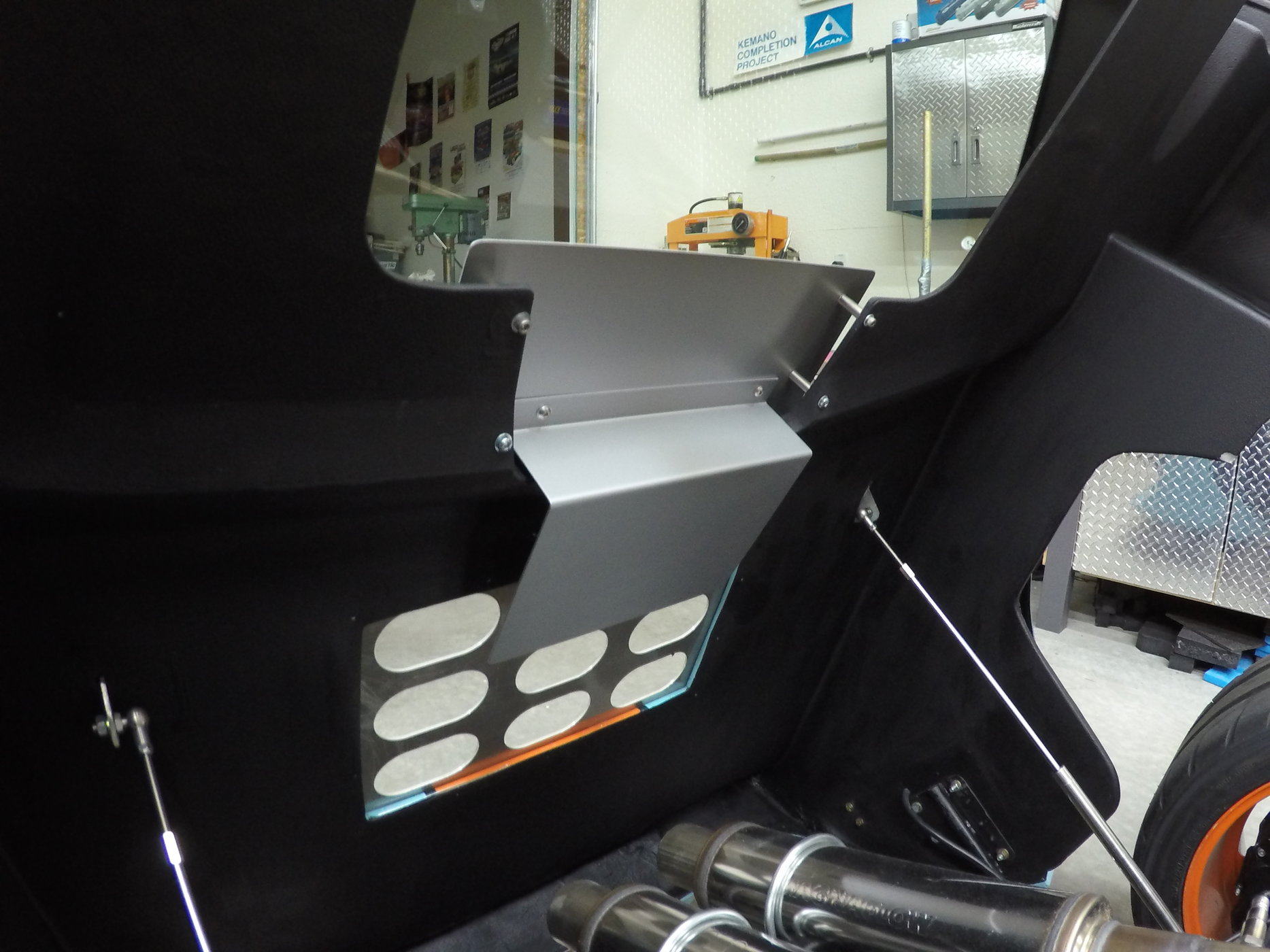

Slacking of on the keyboard. A simple heat shield made, air filters, push on Borla/K&N, a wheel alignment, struts on the nostril

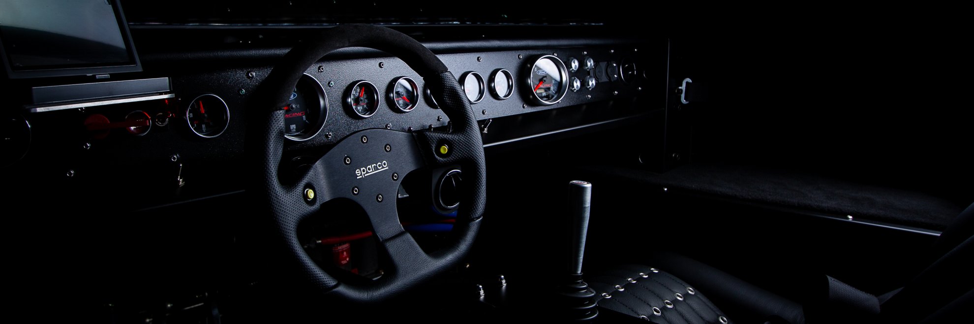

Today was spent on a dyno. The first tune installed into the Holly HP was a mess. After starting from scratch today, I think I have an engine that can be driven on the street. For some reason it tossed a fan belt but an easy fix. After having the numbers on the side I started to peel the sticker of at the door sill. The fix was a strip of rock guard film over the edge. Tomorrows job will be to fit a small CV boot over the shifter and then call it a shifter boot and install a GT 40 emblem, thanks Rick, on the shift knob. Thank you, they just showed up today.

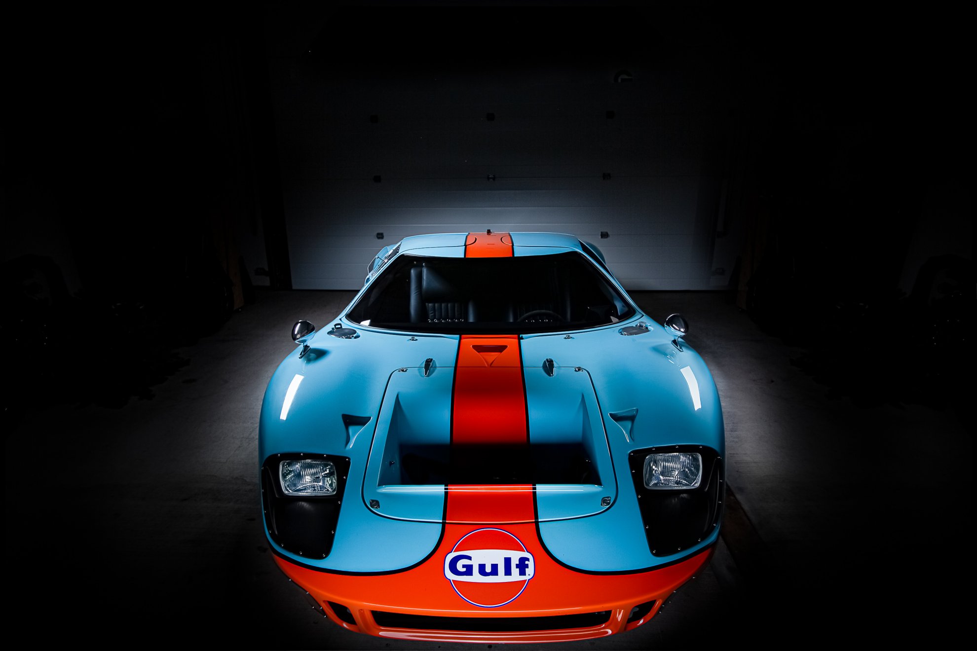

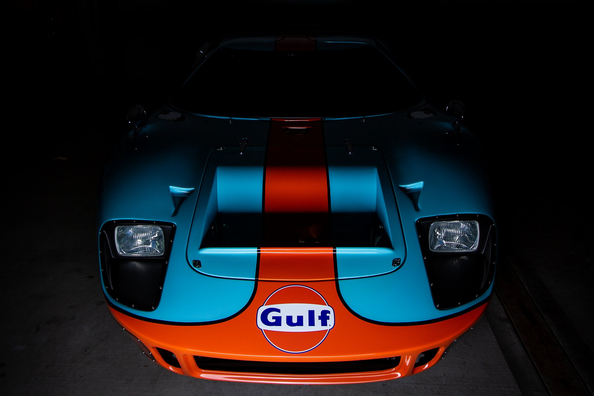

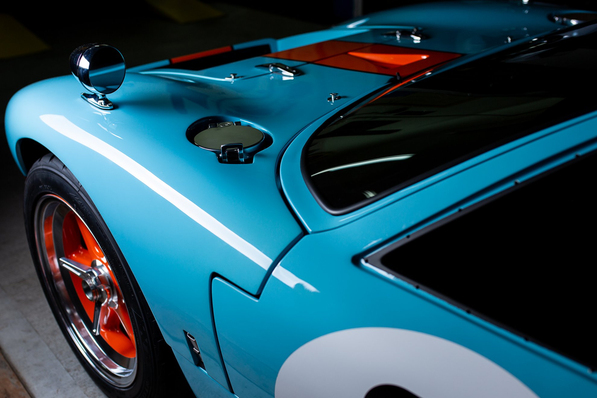

My eldest was here for a visit and was playing with his camera. I was told how and where to hold the light.
