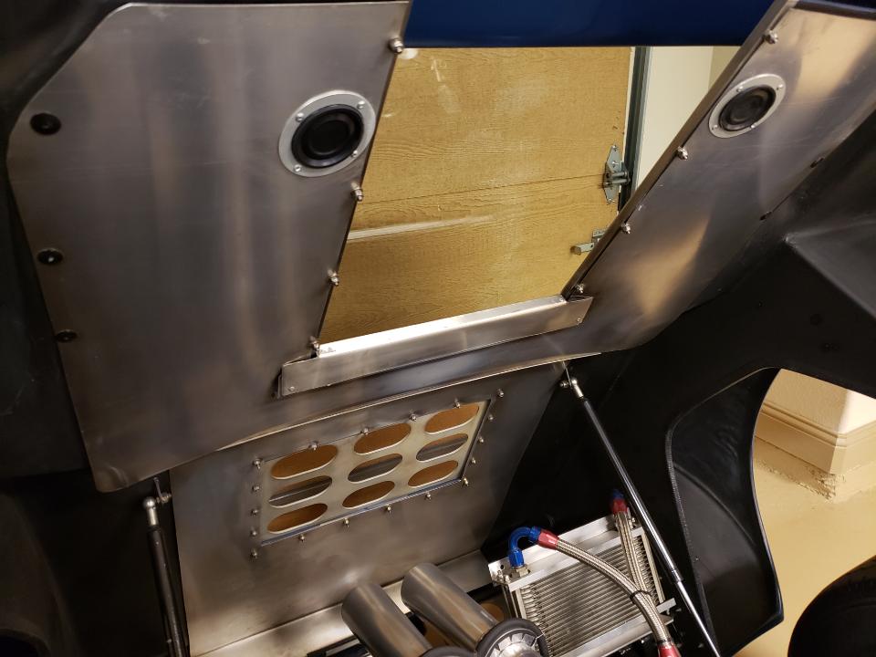

Mine rear bonnet shield.

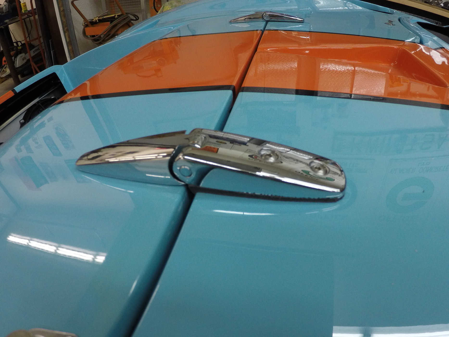

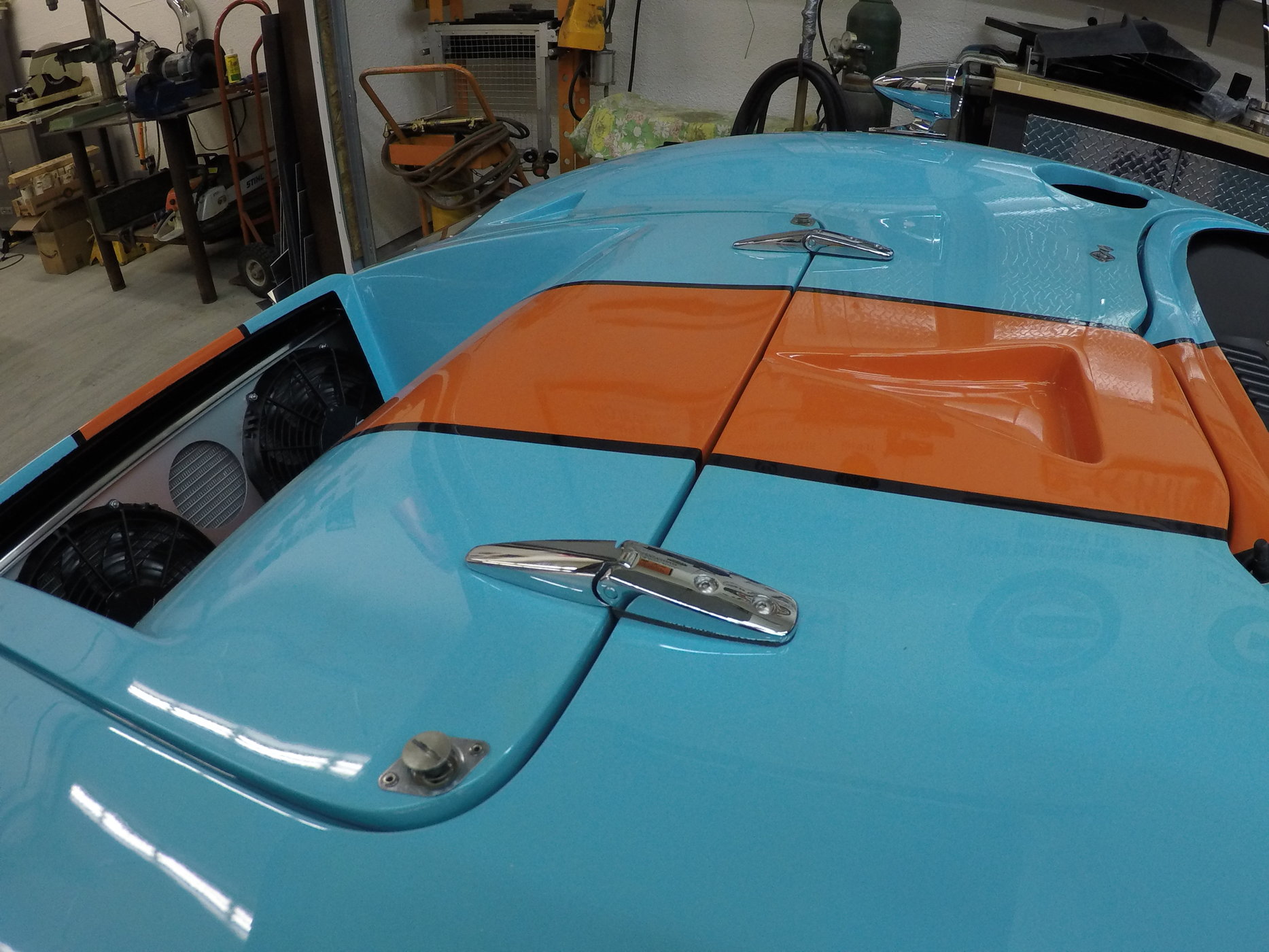

Spent the day making in and out frames for the window. I will sandwich the glass and fire wall with a frame in and out. The 69 / 70 Mustang louver hinges, with a little work worked out well. I have about an inch clearance from the fans when nostril opens. No, the stick is only temp!!!!!
