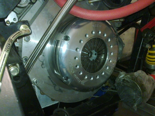

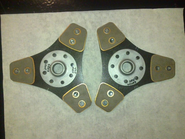

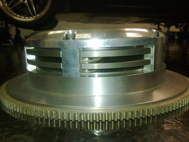

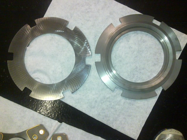

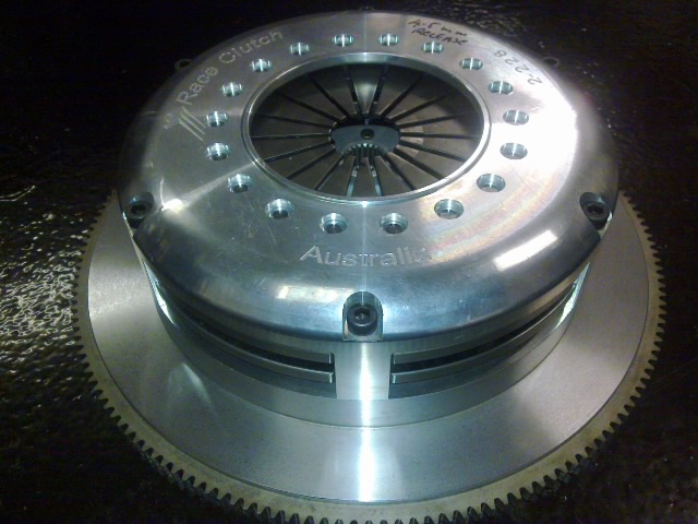

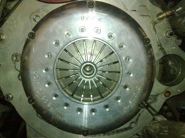

Yeah it's been a while since my last post but I have been buisy destroying clutches. This year alone I have welded one clutch and completly destroyed another and the car has been off the road for three months.

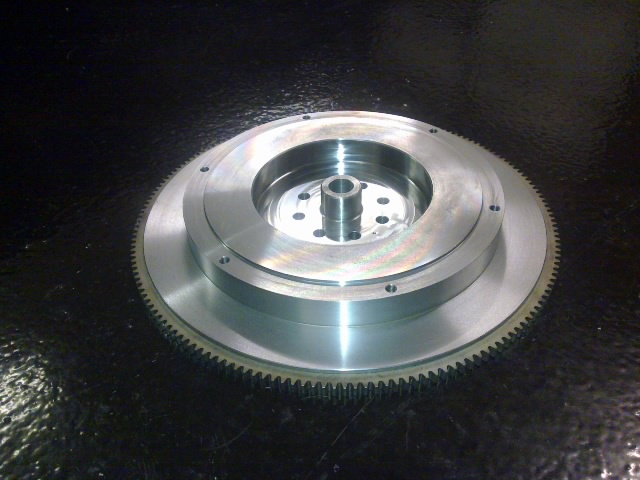

I have worked closely with Jim from Race Clutch Australia and have installed his first prototype of his 9" twin plate race clutch. Also in the photos you will see we had to make a new flywheel which and Chris (Flatchat) was responsible for this lovely creation.
On the run the clutch feels slightly heavier to operate but the gearchanges are lightning fast (with or without the use of the clutch), gear changes are also smoother and quieter.
On take off the clutch is a little harsh but it deffenetly feel like it will take the torque.

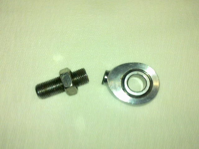

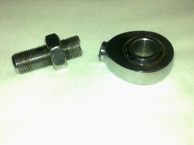

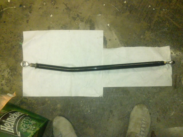

Earlier this year I decided to upgrade all the rose joints to chrommoly billet ones with teflon inner bushes. WHAT A MISTAKE.
On my way to pick up a groom to take him to his wedding, the lower A arm rosejoint on the passengers side (left) broke in half while going over a small bump. Luckely the speed when this happened wasn't too high (80kph) and I had room to pull to the side of the road as the wheel locked up. Very lucky to have no body damage and the car in one piece.
The only real damae was a bent lower control arm which Jim C came to my rescue.
All of the rose joint were replaced with Aurora items at the vendors expence.
The reasoning the rosejoint failed I believe is that the material was too brittle and the thread was cut in rather than rolled in.
So please be carefull with which rose joints you use

flatchat(Chris)
Aaah!, so thats what it looks like, when its all together - eh ,eh .
We expect you to give it a damn good flogging --so that we can see if there's any improvements to be made.
The clutch, that is
fantastic looking car.

It would be interesting to show close-up pictures of what Rolled threads look like vs Cut-Threads so people could visually tell the difference..

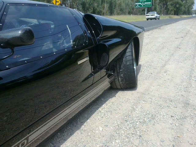

Hi Bob
Love those door mirrors ,can I ask where you got them from?

Flatchat, the weather has been nice this weekend and had some fun in the car. The clutch is going great aand I'm loving it. Don't know about the tyres as they're strugling.

Big-foot, mate that is the best shot that I have of the thread as I had to pass that rosejoint over to Motorsport Connections so they can run some tests on it. But a cut thread has the peaks very sharp and is what you achieve when you use a lathe of die to put a thread on a rod and a rolled thread is what you find on most good quality bolts. I'm not sure if that explanation is totaly correct is engineering terms, but that's how it was explained to me. Cut threads are aparently weaker.
Dave S, the mirrors were from e-bay and are carbon fibre F1 style.

was it one of the outer rose joints or the inner one ?
If it was one of the outer one´s i would also check for the shiming where they mount to the upright. If they are shimed to less you would put a lateral(compressing them =>bending load) load on them when you firmly bolt them to the upright. Could lead to exact the failure you got. THe A arm should go very tight over the upright.
